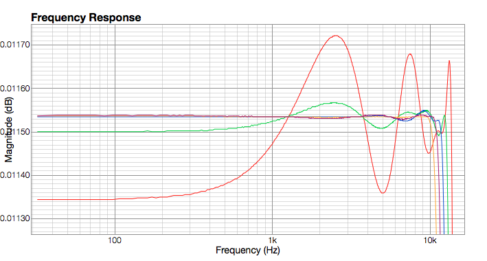

What is noticeable with smoothing set to none, and much higher zoom levels is the effect of reducing sidelobe attenuation. 128-80:red, 128-90: green, 128-100: blue, 128-110: purple, 128-120: orange
attachment.php

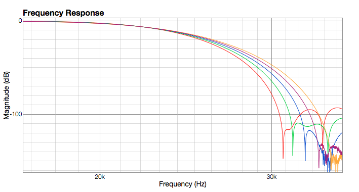

The 80 and to a lesser degree the 90 show obvious ripple, although even with the 80 this looks to be about 0.00037dB peak to peak, so this well beneath the +/-0.001dB threshold for audible colouration mentioned in Gerzon's article on equalisers.
Roll off and stop band show the trade offs between the two - the 80 rolls off earlier but has the worst stop band performance.

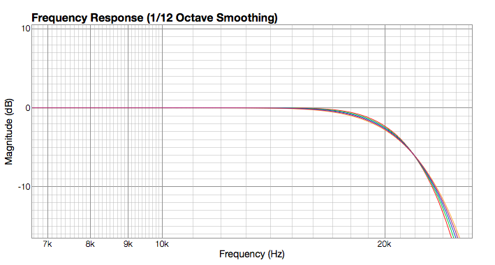

This shows the roll-off to 0.1dB of the 4 filters 80, 90, 100, 110.
attachment.php
I've had to adjust the 0dB point on a couple of them but ran out of adjust resolution so there are minor differences in 0dB.
You can clearly see the effect of reducing the sideline attenuation with the 110 rolling off lowest and the 80 highest. It looks to me that there is about a 1kHz spread between 80 and 110.

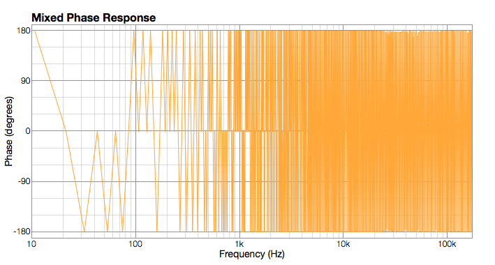

Disabled Account
Joined 2005

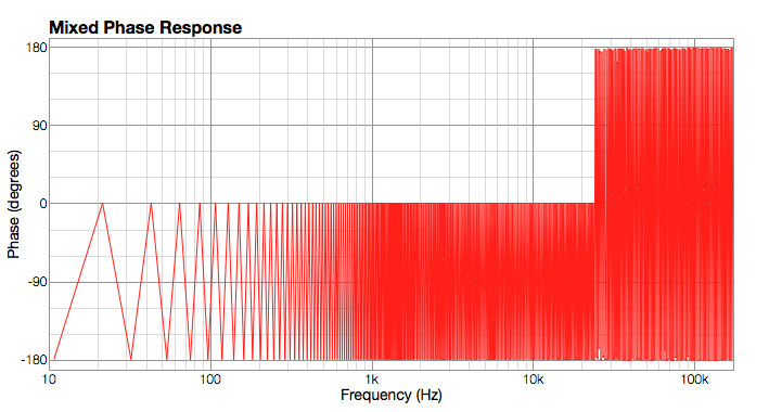

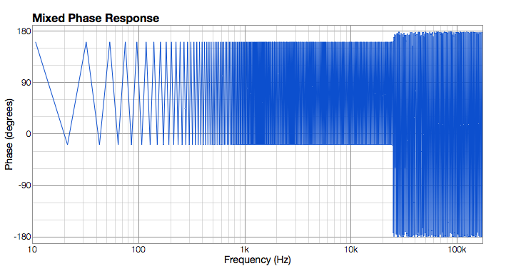

Looking at the mixed phase in fuzzmeasure it seem the filters that have the hf modulation on sine sweeps have phase that swings from 180 through zero to -180 degrees, so 360 degrees. The C128, C576 and K960 have a phase swing of half that, slightly offset. The exception is Izotope which at the default A+ setting also has the 180 -> -180 phase swing.
NOS has a 180 degree swing, but it is non-linear in the audio band so moves from +180 to 0 below 1kHz, and then slowly shifts to -180 to 0 by Fs.
Not 100% sure if the full 180 to -180 phase swing is the cause of this effect, or why Izotope doesn't seem afflicted in the same way.

Could you make one or two pictures to illustrate. I do not exactely see what you mean with the phase swings.
