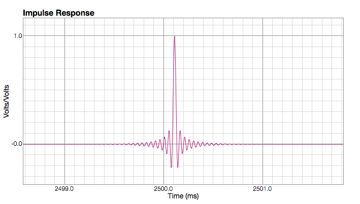

Attached is my current listening filter.
I've compared it to a set of A+ Izotope settings Superdad posted to computer audiophile in mid-2013. To my ear there isn't much between them, the NQB3 is possibly a little more open in the mid-range, and slightly more "spacious".

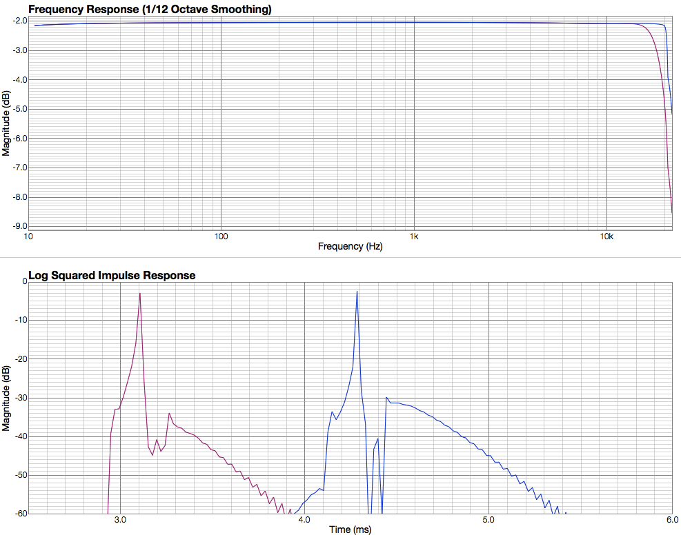

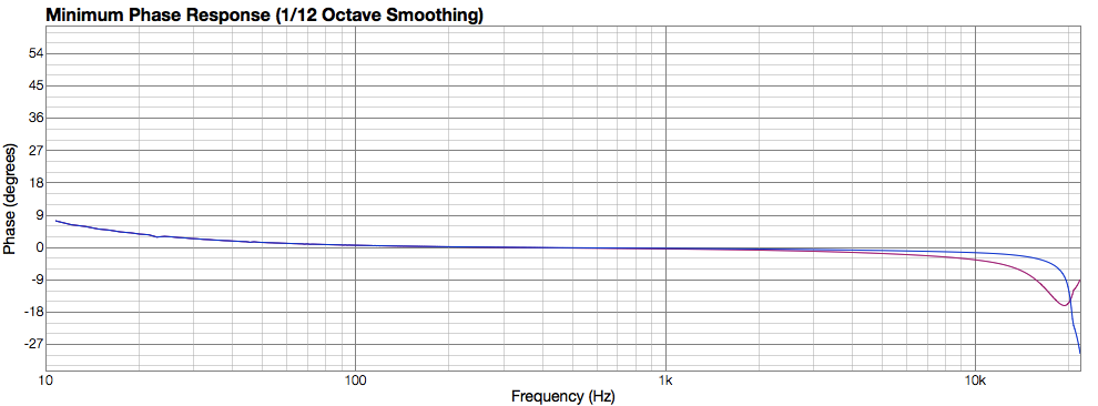

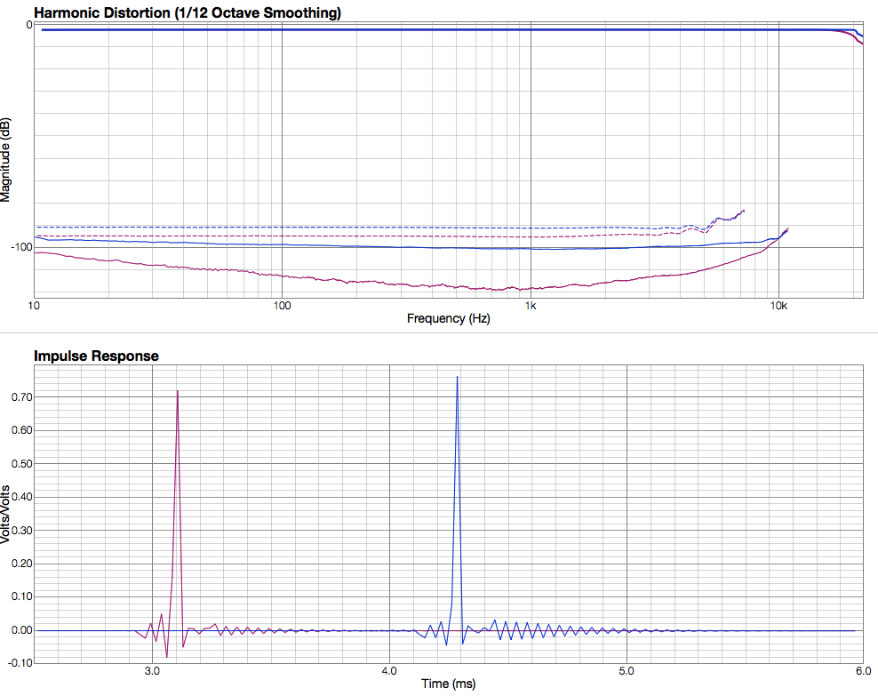

Thank you very much for . I understand that F2 is 8 instead of 6.8333.
The new filters have less distortion than previous. In armonic distortion C128 Better than C960. Both saturated slightly in treble (0 dB) Is -80 db distorsion in trebles only in 0 dB and perfect -1 dB. . I prefer F2 filter 8 like 6.833.
The other measures is better C960 filter: in phase, amplitude, impulse, this filter is technically perfect in every way.
I put measures -1 db. Red C128 Blue C960
In sound are an improvement, more information. I listening clear difference in piano sound. The new c128 gives feeling of being heavier piano than the previous filter.
Both are nice and not bother especially C960. I had little time, it was too late and could not put volume necessary.

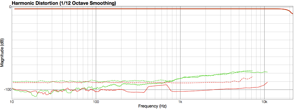

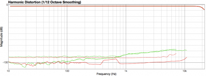

Old c128-100 green. New c128 red (1021filtNQ_C128_100bp.skr).
Measure 0 dB output.
That really shows why the filters were sounding "off" in the mid range and HF.
Interesting that a filter can have such an effect on THD. Is it possible that the rather high full scale THD as measured by Soren is caused by the original filter?

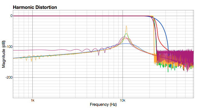

Much of that is purely the nature of the R2R architecture. MSB and TotalDAC display the same characteristics.
That said the filters will contribute to the distortion characteristics but won't effect the harmonics of the main test tone.
What oneoclock's plots don't show is the peak in distortion around 11-12kHz that all the filters except NOS display.
Attached shows:
NQB3:red, C960_140dp:green, C128_100dp:blue, Izotope steep rolloff defaults: orange, stock 44.1: purple
Blimey, something strange going on there. I'm guessing the peak is around Fs/4?
This is analysis of the fir coefficent behaviour, not DAC behaviour so don't jump to conclusions about what is going on.
If Izotope is displaying this behaviour, and is regarded as "the best" it's either not especially unusual, it's an artefact of SoX/Izotope upsampling or fuzzmeasure is telling porkies.
The peak of the Izotope trace appears to be very close to 11025, so fs/4 of the original impulse file.
What exactely does the plot displays?
The THD of the filter applyed to a 0DBFS sin of frquency f (as function of f)
