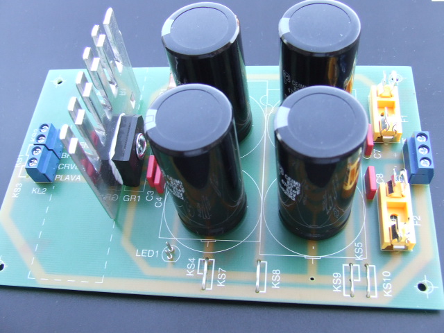

Using 8A/1000V KBU8M bridge rectifier (suitable for pcbs) would simplify things considerably and give small footprint on the pcb with enough space for some kind of heatsink. But I like PMI's board because fast discrete diodes can be used, if someone prefers using them.
Yes, and it can make it easier to route the connections in a small area. One reason why I used the old TO-220AC package for the diodes is because they were used in the original circuit posted above. Another reason is it gives us some flexibility to experiment with different types of diodes.Using 8A/1000V KBU8M bridge rectifier (suitable for pcbs) would simplify things considerably and give small footprint on the pcb with enough space for some kind of heatsink. But I like PMI's board because fast discrete diodes can be used, if someone prefers using them.

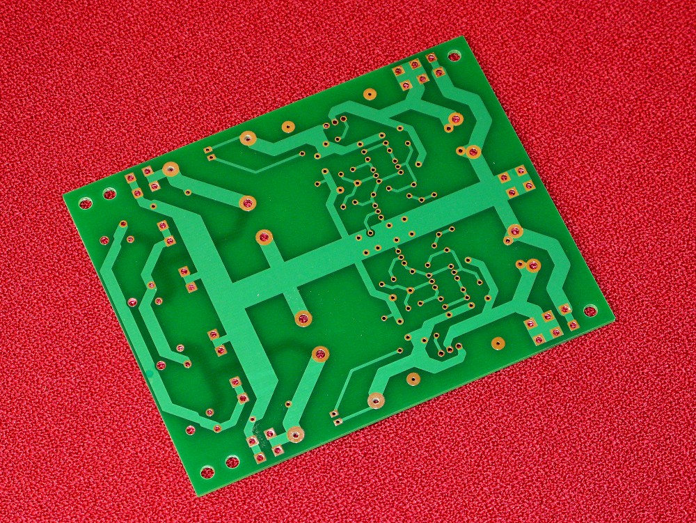

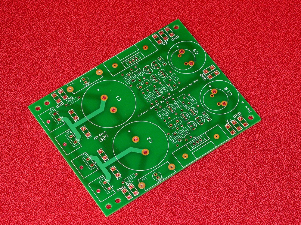

Improved Capacitance Multiplier, first circuit boards:

The main filter and reservoir cap is intended to be 10,000uFd, 35-mm diameter, snap-in leads. The holes will also accept 12.5-mm spacing straight lead (checked already), at the expense of the snap in leads being a bit loose.Nice board, what have in mind to populate it : caps....

The outside dimensions are 120x95 mmHi Pete,
What is actuel board size?
Marc
The mounting holes are on 110x85 mm centers, 3.5 mm diameter, unplated. 6/32 or 3 mm mounting screws. 5 mm minimum standoff (spacer) between circuit board and chassis, assuming untrimmed snap-in lead on the larger caps.
At the end of the board where the rectifier diode heatsinks would mount, there is a second set of mounting holes 7 mm in from the first set, in case of heatsink and mounting screws overlap.

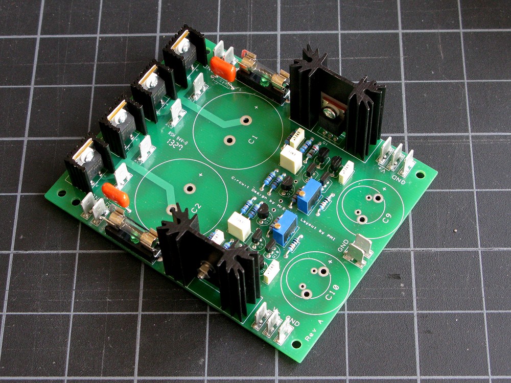

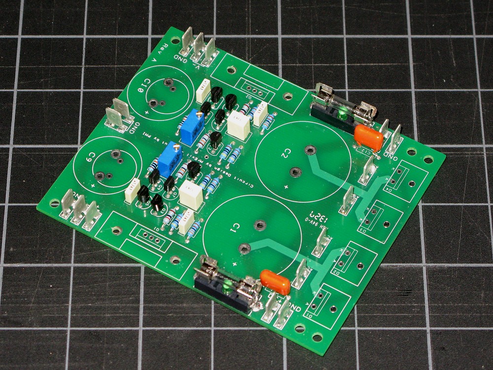

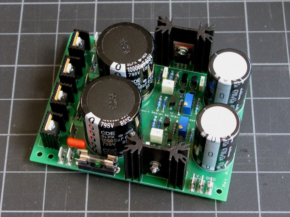

In any case, I know you have been waiting, so here is the progress so far:
Circuit board inspected, and one minor error found in mounting holes for the pass transistor heatsink (not electrical).
One board assembled, dropout voltage set , and powered up with lamps as a load. Seems to be working so far, ripple is vanishingly small, nothing seems to overheat and everything looks stable so far.
For me, noLooks good. I'm glad you managed to keep the LEDs under the fuses; the importance of adding LEDs to everything cannot be overstated!
There's not a lot of room between the diodes and caps - is it difficult to get a screwdriver in there to attach the heatsinks?
Also, I had some other constraints on length of the board, b/c I am working on a "compact" chassis. The board is designed allow the diodes to mount from the bottom at 90-degree angle, so if desired the six (!) cheap and little heatsinks can be replaced with one large and cheap heatsink (or an even cheaper plate of aluminum).
When mounted on top, the diodes are assembled to the heatsinks first, then the heatsinks with the diodes are soldered to the board, with the board upside down and resing on the heatsinks. (I did not actually have the intended heatsink on hand today, so these are a substitute.) The 10.000uFd caps are soldered last, because they are the largest/tallest part.
So attaching the hatsinks is not a problem, de-attaching them after everything is soldered is another matter, or course.
It is not necessary, as long as one remembers that the heatsinks become part of the cirquit and can be shorted with a test lead etc.Pete,
Why are all rectifier diodes and pass transistors isolated from the heatsinks? At least, they look like they have isolation. Is it necessary?
The pics are of my first board. I did not want to worry about one more short hazard while testing, so for me, it is a good idea...
I would have normally used screw terminals for testing, instead of Fastons, but I ran out, and did not want to have some of each on one board. Not ALL of the blade connectors (Fastons) need to be populated, in fact I doubt anyone would use all of them at the same time. That was something else useful only for flexibility in testing.
I tested with a small load approximately equal to the VSSA quiescent current, and compared to two other power supplies, w. 37V (35V nominal) rails. Jfet current is 5.7 mA, dropout voltage set to about 0.75-0.80V. I also ran the through-hole version of VSSA with the supply, and there was no hum or buzz, and no noise visible on the output with my scope, even w. very long power supply leads and an open chassis.Hi Pete,
