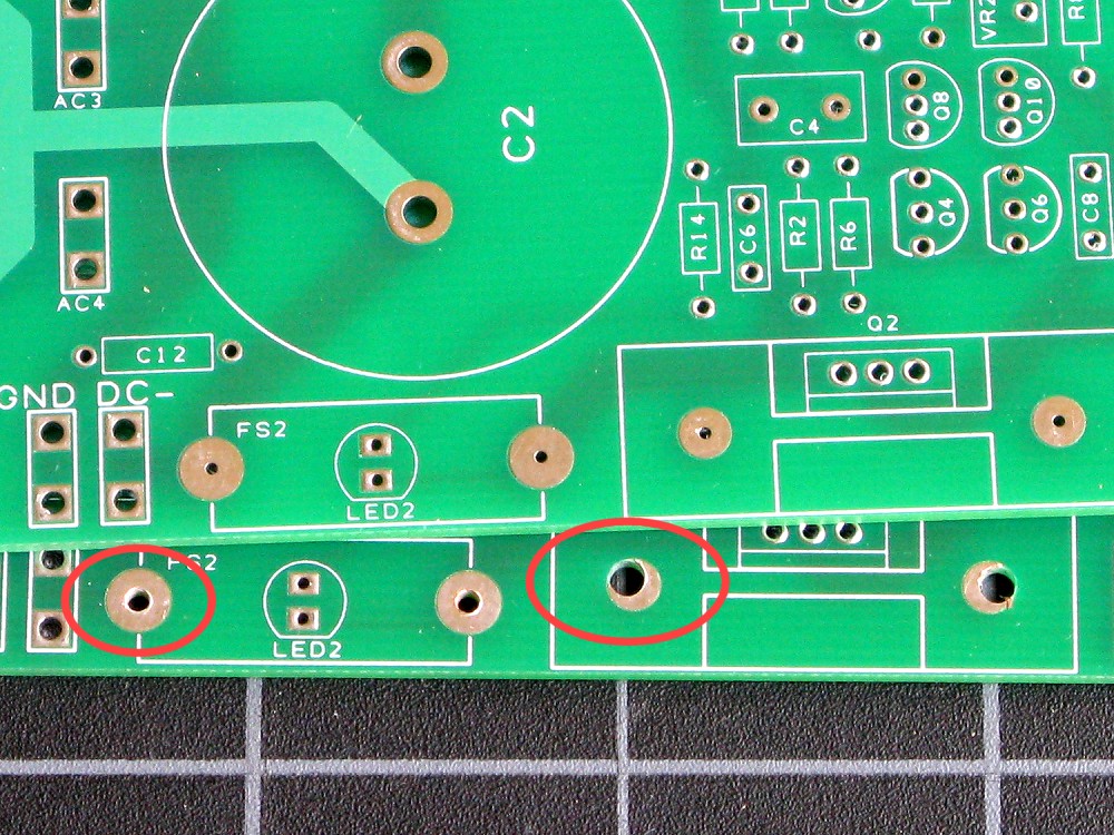

The board has a couple holes for a CRD to use instead of a jfet, but this too would add cost ($2 each, instead of $0.50 each for the jfets).
I have not posted a final schematic or BOM in case of changes. My original schematic had a couple errors and typos, and like most people, I prefer to fix my mistakes b/f anyone else can see them...
I think I have 5-6 spare boards from the original batch in addition to what I need for testing, or already promised to others. I will have to drill two sets of holes out for anyone who wants them now, as opposed to waiting for the next batch. Drilling these by hand is not as easy as it may seem, doing it on a drill press is much easier.

I am willing to add a couple extra holes to the board for a snubber, but someone else will have to suggest some component values. When I tried this in the past, the benefits were not so clear, meaning, visible on the scope, but not audible.
I have a (cheap Chinese) drill press.

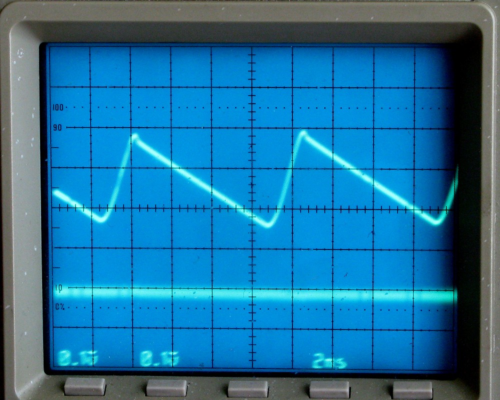

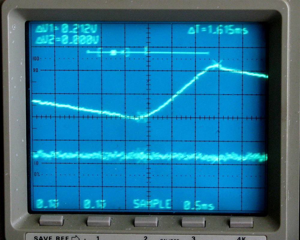

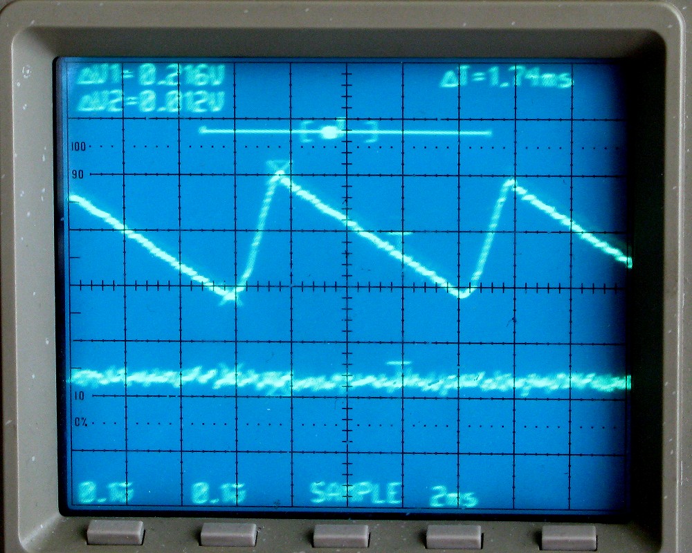

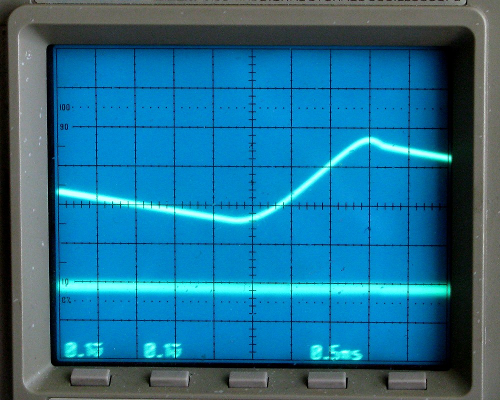

@jameshillj: So far I do not see any sign of ringing at the turnoff time for the Schottky rectifier diodes I am using currently. That does not mean it is not there, but at least after the recifier, at the node where the main filter cap is connected, nothing.
There is a small amount of overshoot in the ripple waveform, but no hf ringing.
The pics were taken at idle, and show around 200 mV ripple before the filter (upper trace), and essentially zero after the filter (lower trace). The result is about the same at higher power, I tested up to about 2A load.
The random noise seen when the scope is on digital storage setting has more to do with my wiring and test conditions.
