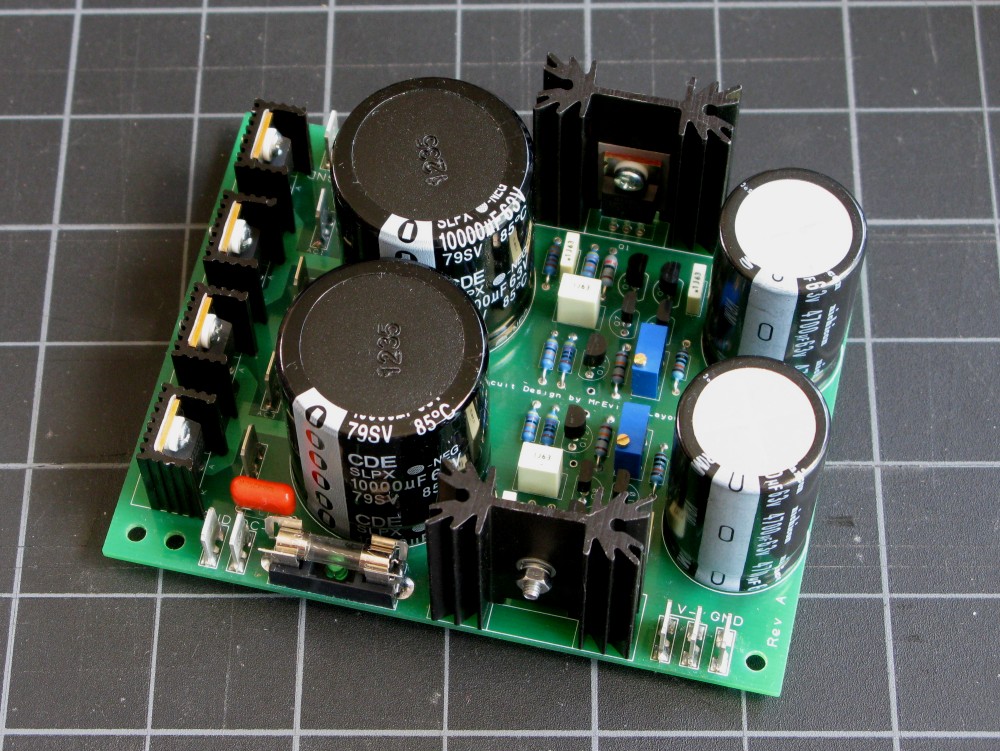

I assume you mean use the board as a CM filter only, after your power supply?? If that is the case you should not have any problems, because the ripple will already be low, so the dropout voltage can be set at a normal low-ish level.
There are faston connectors on the side of the board that can be used either as a DC input (if the AC input to the bridge rectifier is not being used), or as an unregulated output. This was done to accomodate separate supply feeds to the front and power stages of VSSA if desired, but you could use it for your purposes.
The heatsink at the pass transistor is rated at 11C/watt, and there are larger and smaller versions available to fit the same footprint.
So for example, say you want to plan on 2A average, and the ripple in your power supply is already low, so you set the dropout to 1V (or less). The pass transistor will dissipate 2 watts, and the heatsink temperature rise will be about 22C above your internal chassis temperature.

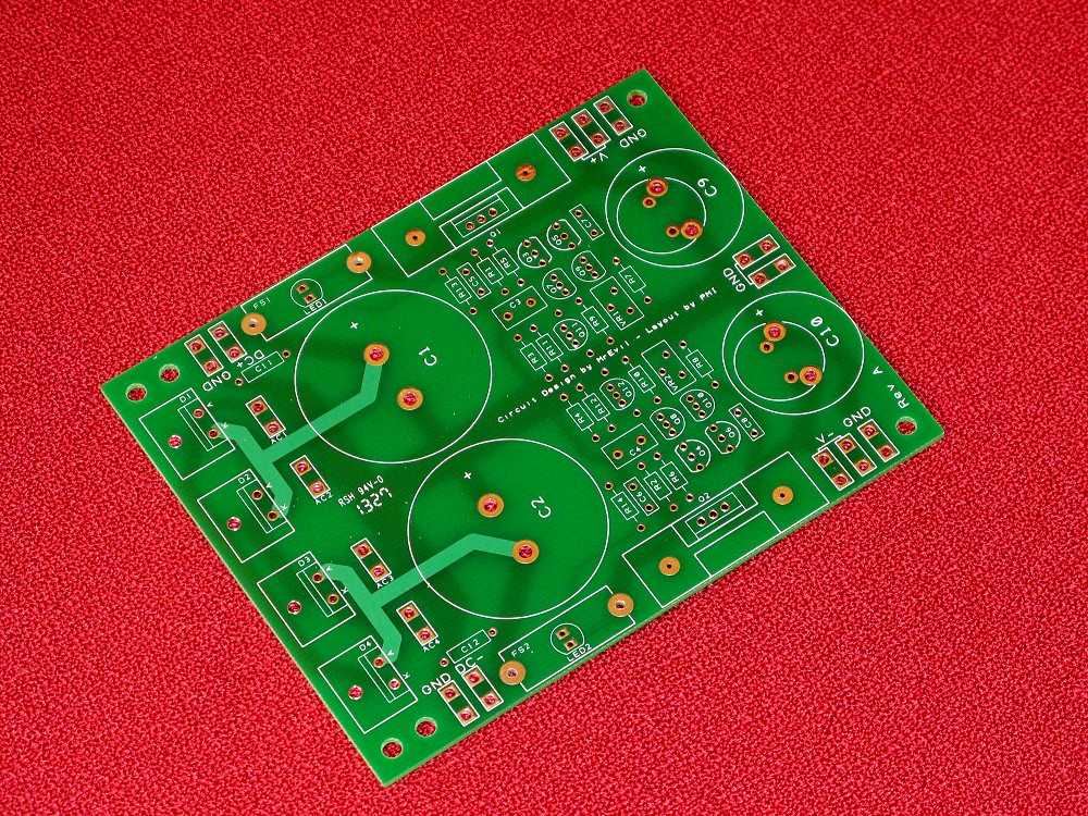

Why did you choose gold-plated contacts vs tin- or solder-plated?
Not a widespread issue in DIY, I should think, but the advantages of gold are not harnessed in this application.
http://www.semlab.com/goldembrittlementofsolderjoints.pdf
Not sure if that is in reference to the power supply board... no gold plating on this one. If you are referring to my through hole VSSA boards, the board house threw that in for free, probably ran my small batch with a different order. Color may be off a bit in the PSU pics. I think I am using the default color correction when I crop and edit them. Board is just conventional tin-over-copper.
In either case, thanks for posting the link, interesting!
Sorry, the contacts looked gold in the pics you posted.

The attachments are for the circuit board as tested and discussed above.
Not including the boards already sent out, spoken for, or used for testing, there are 5-6 left, and I plan to reorder at least once for those who expressed their interest earlier in this thread and elsewhere. With any luck, the cost will stay $10 plus shipping. Only exception would be if the discount I am using to order small lots were to end.
I will read through the thread and post a list of names later today. Anything after the next small order might have to move to a separate thread in the GB section. MrEvil has graciously let me use this thread so far, and I don't want to abuse the priviledge. (Thanks)
I also plan to publish a version of the layout for a diy etched single layer board in a separate post.

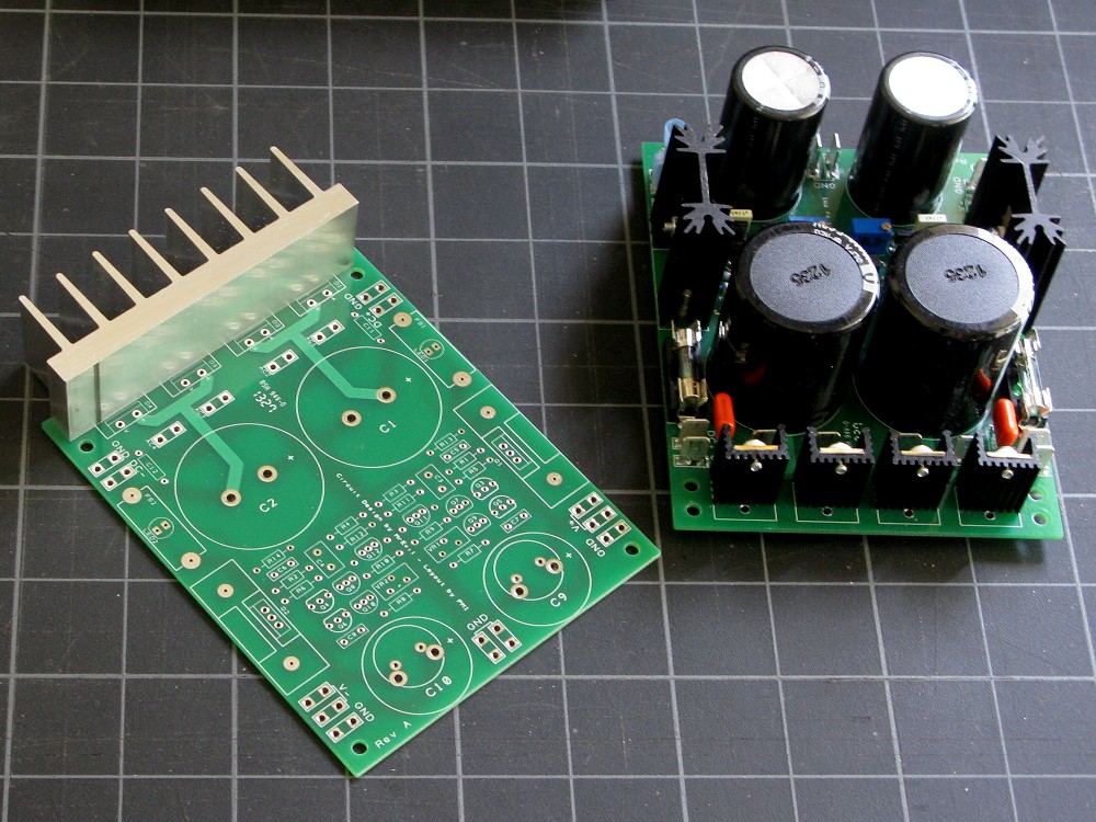

Maybe this has been asked before, but what is the reasonable limit on power on this board, in terms of either voltage or current (ripple, etc.)?
The maximum voltage with the components I am using now is +/-50V. You could push this a bit, but not much. As the BOM stands, the limit is given by the MOSFET used as the pass transistor, rated at 55V. At startup, the unregulated output of the rectifier will show up across the pass transistor, and then gradually diminish until it reaches the equivalent of the dropout voltage plus 1/2 the unfiltered ripple.
The maximum tolerated ripple will be given by the spec of the large cap after the recifier that you select. The ripple at the output was essentially unmeasurable (read back in the thread, I posted some examples w. scope screen shots).
Maximum DC current is likely to be around 5A, limited by the power dissipation of the pass transistor and the size of the heatsinks. The board is also designed to allow the rectifier diodes and pass transistors to mount from the bottom, leads bent @ right-angle, for more heatsink capability (not tested, but see below for the general concept)
Other combinations of components and heatsinks are also possible, as in the second pic.

Thanks Pete, could I ask for 2 brds, not one, if available, please.
Also, for changing diodes after the caps are fitted (for people like me!) we can just drill out clearance holes in the heatsinks and use bolt/nut/washer/pad - no problems.

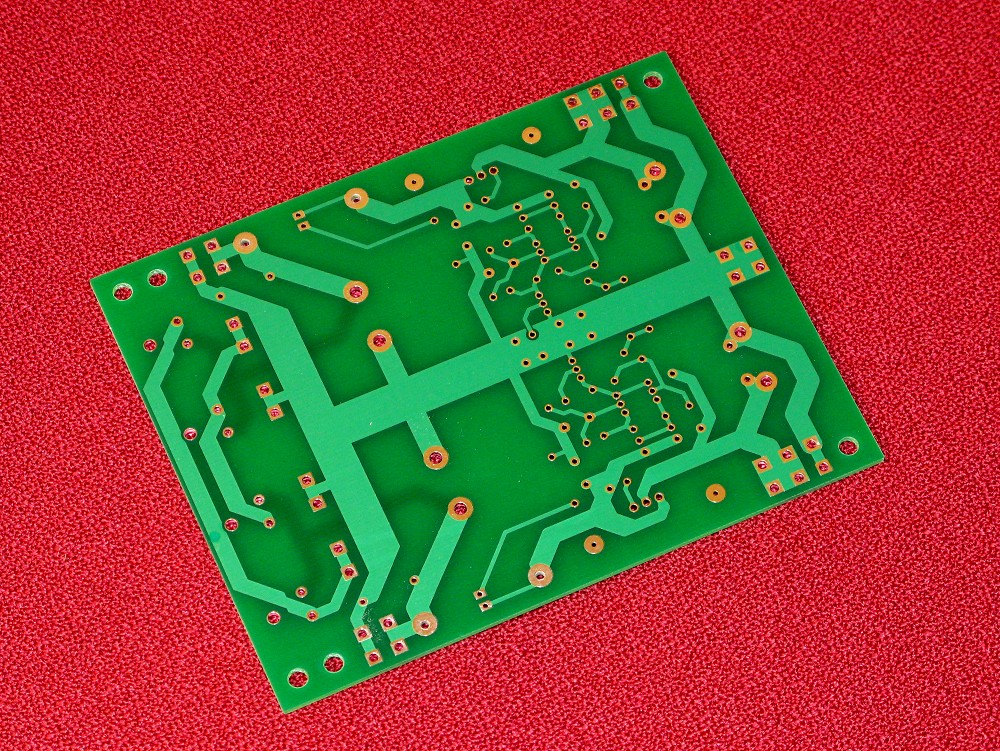

Curiously, Miles' original brds had a separate ground connection for the input power supply caps and another for the rest of the circuit's 0 volt points - not good?

Why are there so many grounds? Doesn't it make sense to use a star at the "output" of this board?
Also, for changing diodes after the caps are fitted ...
Do you do this often James?.... :joker:
The diode heatsinks don't have to be soldered to the board, the diodes, yes, but not the heatsinks...
If you know that is a possibility, just insert the hold-down pin in the board, but do not solder it.
Later, heat the soldered diode leads from the bottom of the board, and pull, the diode can stay attached to the heatsink. The heatsinks I had on hand don't even have the support pin. I like that feature, but you don't have to have it.
Or just get a small offset screwdriver, there is actually about 15 mm to work with... if you can't find one small enough, you can make one out of a pair of old tweezers, just file the tip a little, and then bend it in a vise. Tweezers are usually hard enough to use as a small screwdriver, but soft enough to bend and file.
edit:
Yes, the original layout had a split ground plane, but that is something I did not need in my case. I also made the output cap much larger, because the power supply has to serve the full bandwidth of the amplifier, not just a subwoofer, so current peaks can be much sharper.
Yes, a star ground always makes sense, but people often do not agree on where each individual return should be connected. So, I added a few extra ground points.
You only need to install FASTONs where you intend to use one. For testing, I installed all of them.
Basically, there is one for each power take-off connection.
The ones at the unregulated power connections have an addition purpose, they can be used as an extra connecting point for a split supply (still trying to work out if that makes sense for VSSA)
