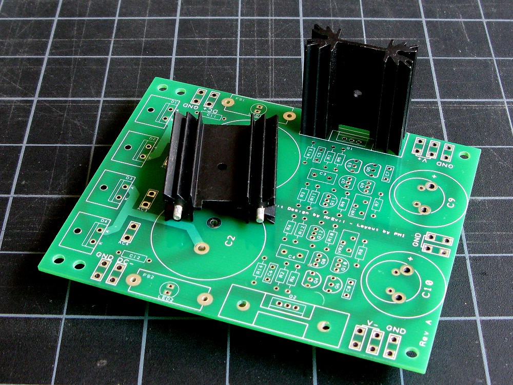

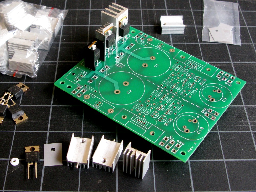

Basic testing is done, the boards work, most of my remaining testing is to make sure that the selected resistor values are correct, where to set the dropout voltage, and measuring a few parameters so other people can compare results. I plan to finish testing this weekend.
Two sets of holes on the original boards have to be drilled out to fit. I plan to do this for any I send out.

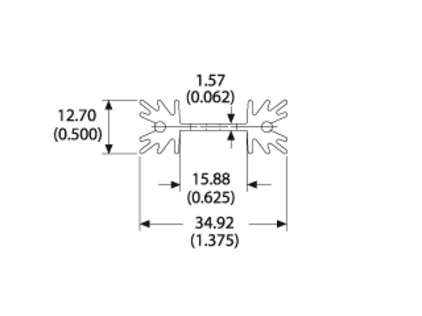

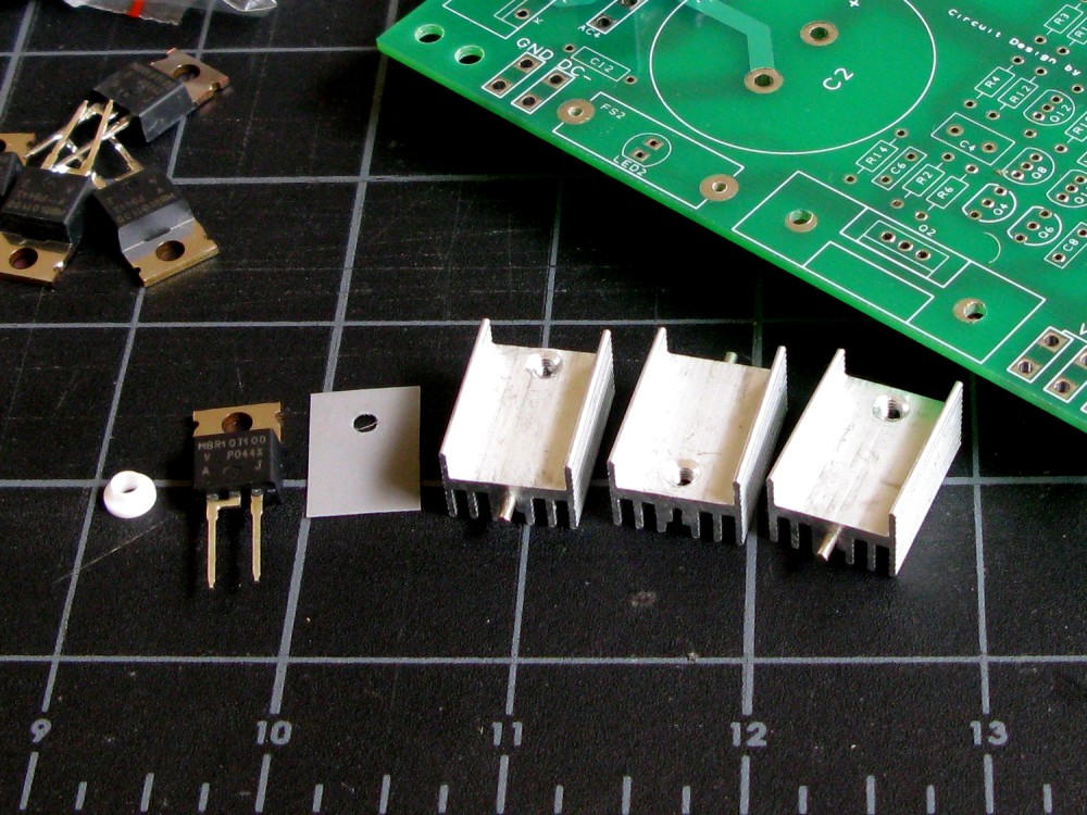

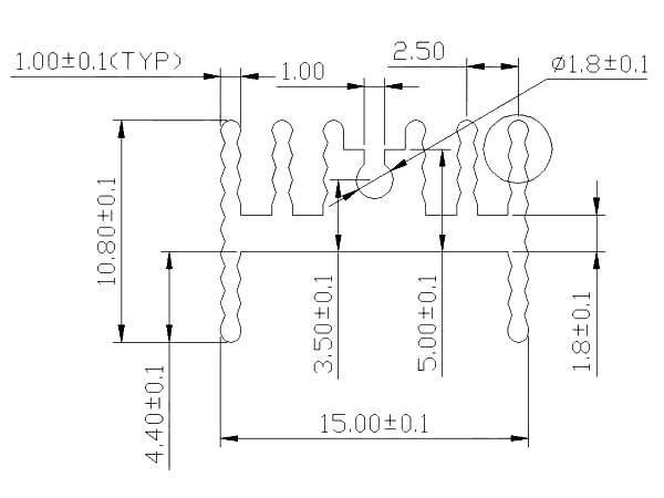

TO-220 Heatsink sizes and specifications
The heatsinks were chosen for low cost. 4 of the smaller type for rectifier diodes, and two of the larger type for the pass transistor are required, total cost around $3-$4 for all six heatsinks.
The smaller heatsink footprint is 10mm deep x 15mm wide, 21-25mm in height, with a single hold-down pin that can be soldered to the board. It is a type available from various sources on the internet, ebay etc. starting at around $0.30/each.
Other similar heatsinks can be substituted up to 20-mm wide. One of the pictures below shows a couple alternatives I happened to have on hand. There is nothing unique or special about the one I chose, I simply happen to like it (and, low cost).
The larger heatsink is used for the pass transistor, and is a standard type available from any distributor such as Mouser, for about $1. In the picture it is a Thermaloy 513102B02500G, rated at 11C/Watt. This is a bit more critical, and is chosen to be larger than needed for a typical class A-B amplifier. Going too cheap here, means that the dropout voltage cannot be adjusted over its full useful range. There are 3 or 4 different heights available, as well as similar heatsinks which will fit the same space.

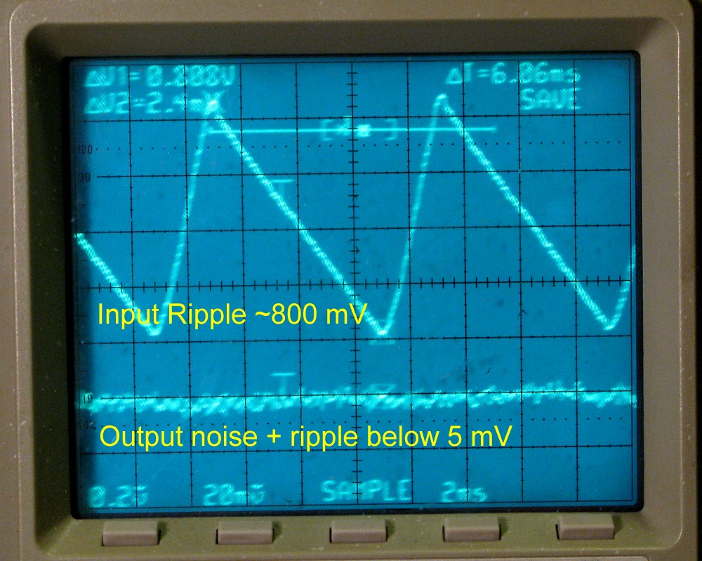

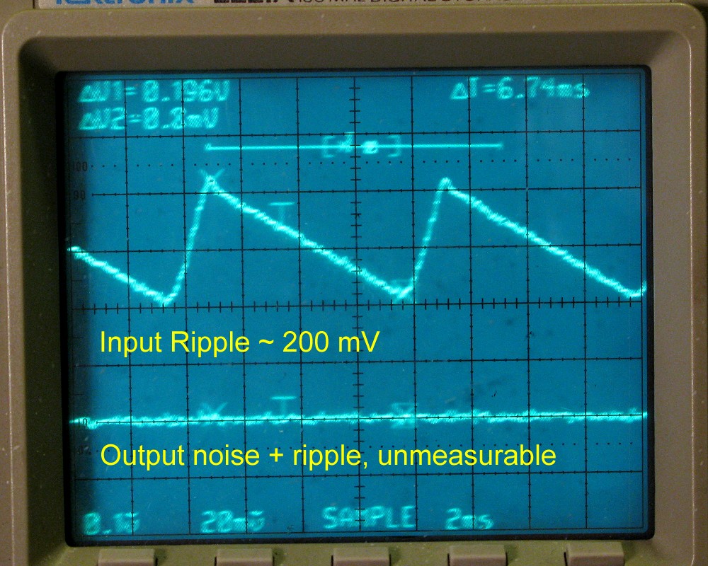

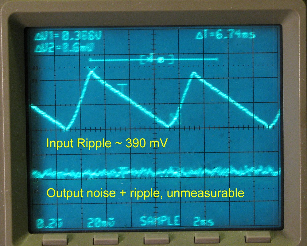

Test Results, Capacitance Multiplier as Ripple Filter
The following three pics show the voltage waveform at the input (top trace) and output (bottom trace) of the pass transistor on the power supply, at about 270 mA, 600 mA, and 1.25A steady current draw.
270 mA is representative of the standing (quiescent) current at the typical settings for LC's VSSA modules, two channels, and also the most common variants, like Shaan's PeeCeeBee version, and my through-hole VSSA boards. This is significant b/c the first goal of adapting MrEvil's circuit was to provide a clean linear power supply as an alternative to using the recommended SMPS (which of course has zero ripple by definition).
Test Conditions:
AC line input adjusted through a Variac for +/-35V DC nominal (34.5 actual), at the cap multiplier output.
Main filter caps, 10,000uF, 63V
Dropout voltage adjusted to ~1V using the trim pots on the power supply
Output caps, 4,700uF, 63V
Incandescet lamps were used as load, 120V/60W, 120V/125W, 120V/250W
Fluke 77 multimeter, Tektronix 2221A digital storage scope
Besides essentially zero ripple, I saw no signs of switching noise from the rectifier diodes at the output of the power supply, which was very encouraging for VSSA and its variants (very wide frequency range).

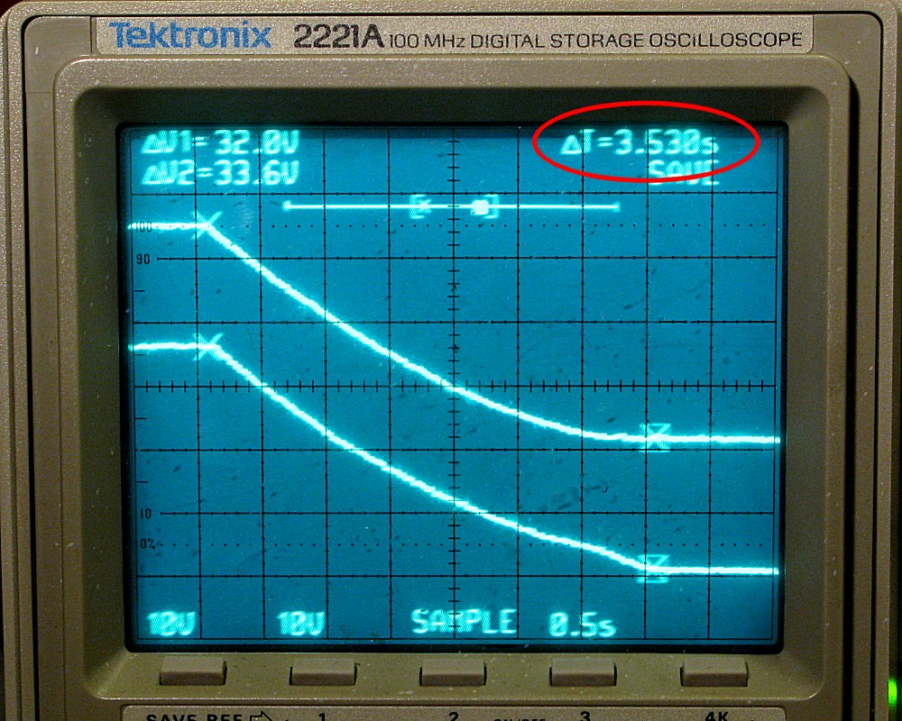

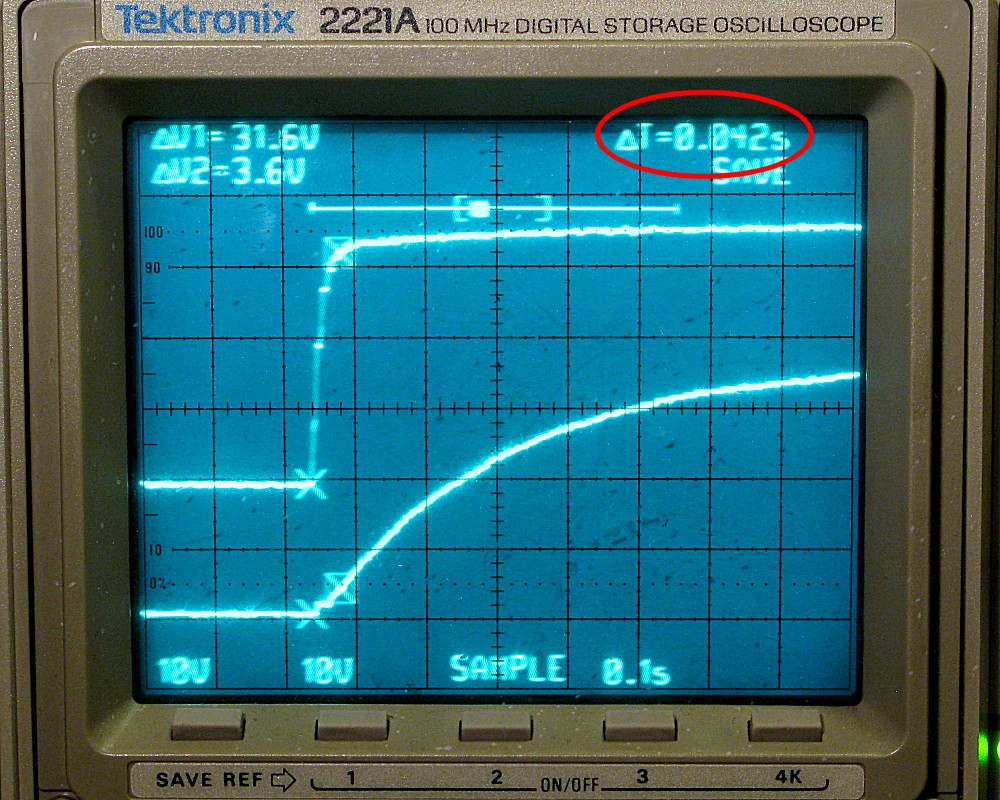

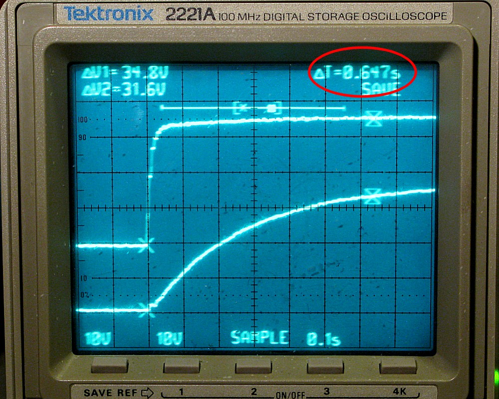

Test Results, Startup and Shutdown
One of my goals was a slow and controlled start, compared to rectifier/filter alone, and compared to other alternatives. The pics below show the rise time before the pass transistor and cap multiplier circuit, after the pass transistor (the output of the power supply), and the third pic shows the shutdown.
The startup shows a small notch at low voltage, but is otherwise smooth and gradual. There is no audible startup noise from the speakers. There is also no shutdown noise, unless the source is still playing.
These tests were using the amp as a load, so they represent results at ~300mA idle current.
Overall, I would say so far everything seems to work as described by MrEvil at the beginning of this thread.

Yes, functionally, I am sure now it does what I had hoped.
I am very happy, less than 10mV at idle, including ripple and noise is much better than anything else I have tried...
I still have to look at the temperature rise at the heatsinks, and make sure I know at what point you have to increase heatsink size. I made sure there are options for heatsink size and vendor, and mounting from under the board, but I have no actual temp measurements yet.
