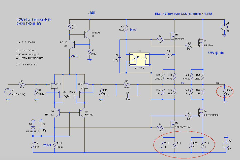

Something's not quite right with that (or my SPICE setup): I get 0.26% THD @ 1 watt.
I used my 8ma jfet models,adjusted tail resistor to 230 ohms and got 0.026%.
In my setup I needed 137 ohms in the tail to zero the offset. I think my JFET models are 10mA, but I'm not 100% sure.
Lots of parts in that J2.I'd find it hard to imagine it better than my version of the F7.After many iterations I have finally settled on "the one".Alas,I can only imagine a J2 in my dreams as I do not know anyone with one and cannot afford one (i'd have to start saving my coin and do the diy).However at the present time I have no interest, from what i've read it is a very special beast.
Here's another question for you guys:
In my sim of a 40-watt J2 variant I end up with the JFET drain resistors in "spice flames" if I short the output when there's a signal on the input.
I had to increase the JFET source resistor values to get a more civilised response. This is more degeneration/local feedback, right? I thought this would reduce the gain, but it doesn't seem to (at least not until I run out of voltage). What's the draw-back of more degeneration?

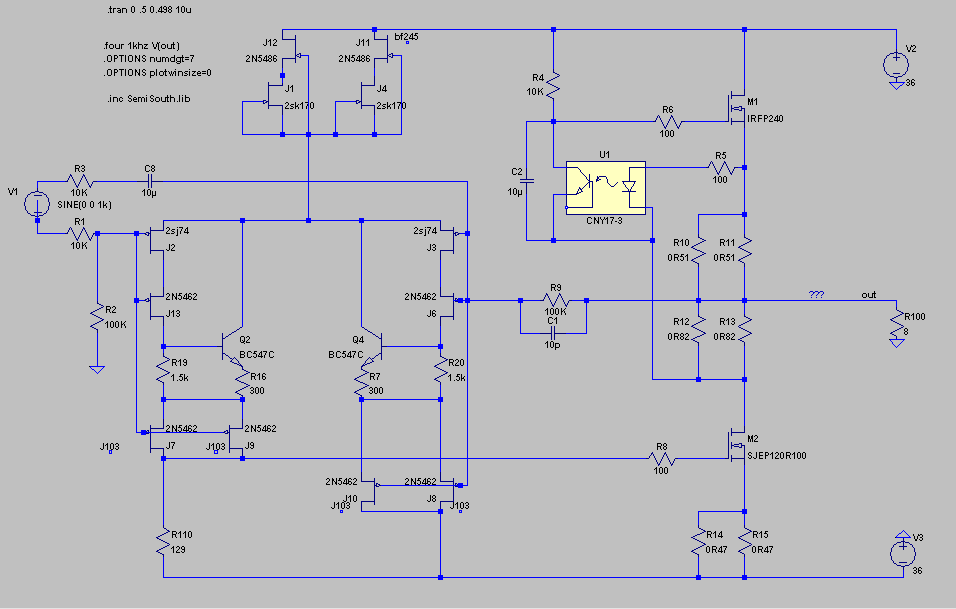

So let's take one of the exisitng DIY J2 schematics, and change them to come close to the rail voltage and bias of the originals.
Here I chose +7-24V and 1,2A bias, giving a dissipation of ~30W per power device, which is quite safe.
Keeping the paralleled JFET frontend, we get ~0.03% THD for 1W into 8 ohm at 1kHz.
Very close to the figure published in the Stereophile review.
I chose to have a bandwidth of just over 100kHz, but you can easily change that with the cap on the feedback loop.
You need to unzip the file and place the +.lib file in the same directory as the spice files to run.
Patrick

Can we only use a pair of matched JFETs instead of 2x 2SJ109s for the frontend ?
Some one mentioned in post #1084 of a bias of 8mA.
So must be possible.
But does that make a lot of difference, e.g. in bandwidth ?
Apparently not, at least in Spice.
So perhaps Nelson will tell us one day why he uses parallel devices.
Patrick
Patrick
But we are still using 4x matched Semisouths, which is a major cost factor, if they are available at all.
And as we found out, they are not very consistent in their manufacturing tolerances as e.g. Toshiba.
https://www.diyaudio.com/forums/gro...tracer-matched-pairs-quads-4.html#post5892320
(Post #188).
So can we use some other devices for the modulated current source instead ?
Post #1154 was already suggesting that, using the commonly available IRFP240.
But these have much lower transconductances than the Semisouths and hence will change the distortion spectrum.
Instead, we want to try out 2SK3497, which has a Yfs of about 7S.
Their high positive tempco would not matter here, due to the clever active
-bias control using the opto-coupler.
Again, in Spice, there are hardly any differences in distortion spectrum and bandwidth than a Semisouth CS.
Patrick

So here you are.
It is not the original.
If that is what you want, I am sure Nelson will be happy to sell you one.
But what is proposed here would be fun to build without breaking the bank.
And finally the disclaimer :
I have only simulated and not built.
But if I were to build, this is probably what I would try out first.
One can always add parallel JFETs and swap the CS MOSFET later on, when all is working.
Patrick
