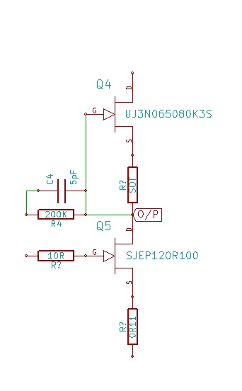

IRFP150 would be a better choice than IRFP240, but I personally would still use 2SK3497.
2SK3497 has lower Coss and Crss, lower Vgs at bias, lower Vsat, and less early effect.
It allows you to run closer to rail.
And I always prefer Toshiba FETs to IRF. Much more consistent.
https://www.diyaudio.com/forums/pass-labs/172770-balanced-f5-question-10.html#post2353470 (post #489)
All FET JLH Class A
You need to take extra care to handle the high positive tempco of the 2SK3497 (or any other UHC-MOSFET) in your bias circuit.
But here the auto-biasing with the opto-coupler does that for you, conveniently.
To illustrate the working principle of the basic J2 topology, here is an inverted one(N-JFET input).
https://www.diyaudio.com/forums/hea...borberly-eb602-200-revisited.html#post5492307
Also auto-bias, and you can use 2SJ618 as output device for power amp.
The difference to the J2 is the current mirror, resulting in much more open loop gain, and hence NFB.
