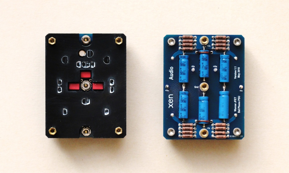

And this is a power amp with a gain of 10, not a MC phono pre.
So thermal coupling is not an issue.
I have used 4x 2SK372 for the Wurcer phono pre, and drift is still no issue.
https://www.diyaudio.com/forums/att...-phono-preamp-180729-wurcer-phono-modules-jpg
