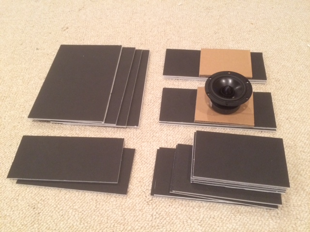

I have always been a fan of Scottmoose's Lance TL, designed for the FF85wk. I decided to have a go at in foam core. It is a very small speaker about 10in tall x 7 in deep x 4 in wide. Plan for it is here:
http://wodendesign.com/downloads/Woden-FF85-Lance-Laby-1v01-180214.pdf
About 1.25 sheets of 30x20in foam core is enough to make a pair of speakers. The pieces are relatively easy to cut as they are all rectangles. I added some bracing which is needed for thin foam core but not if using 1/2in ply.
Here is the build process (took 2 hrs to make)...
Cut all the pieces for a pair of speakers:

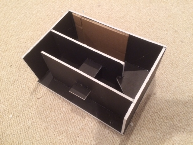

Glue walls and dividers together (note cardboard layer for driver mounting):
![454994d1419195757-foam-core-board-speaker-enclosures-lance-build-02.png'](https://www.diyaudio.com/forums/attachments/full-range/454994d1419195757-foam-core-board-speaker-enclosures-lance-build-02.png')

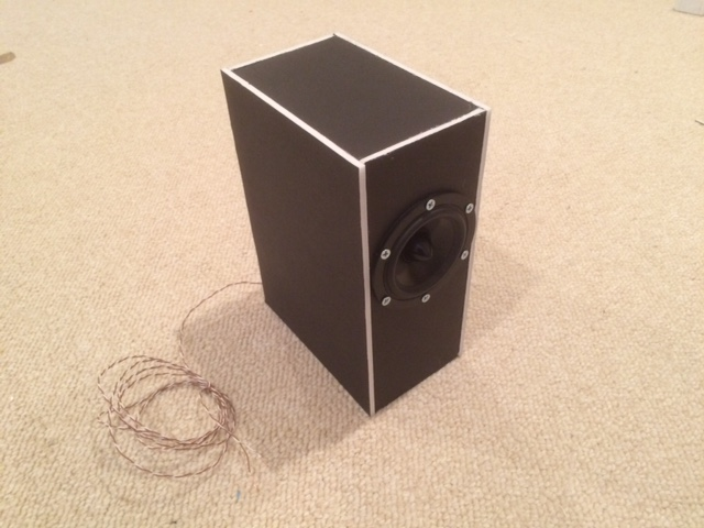

Finished - a smart looking desktop speaker:
![454995d1419195757-foam-core-board-speaker-enclosures-lance-build-03.png](https://www.diyaudio.com/forums/attachments/full-range/454995d1419195757-foam-core-board-speaker-enclosures-lance-build-03.png)

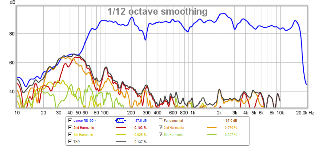

Here are the measurements 6 in away from a back wall:
![454996d1419195757-foam-core-board-speaker-enclosures-lance-rs100-4-hd.png](https://www.diyaudio.com/forums/attachments/full-range/454996d1419195757-foam-core-board-speaker-enclosures-lance-rs100-4-hd.png)

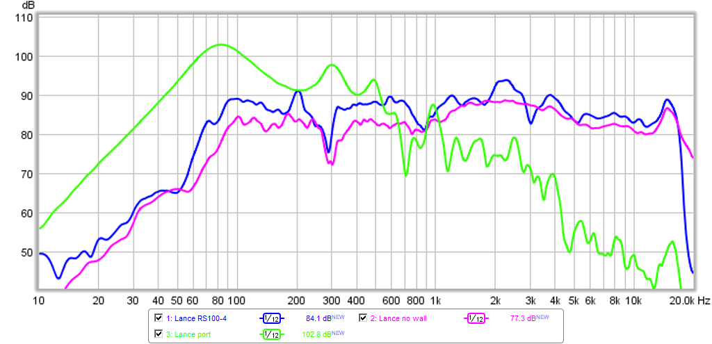

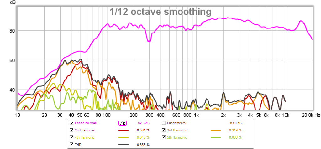

Here is the measurement far from a wall:
![454997d1419195757-foam-core-board-speaker-enclosures-lance-rs100-4-hd-no-wall.png](https://www.diyaudio.com/forums/attachments/full-range/454997d1419195757-foam-core-board-speaker-enclosures-lance-rs100-4-hd-no-wall.png)
Here is the output from the rear TL vent:
![454998d1419195757-foam-core-board-speaker-enclosures-lance-rs100-4-meas.png](https://www.diyaudio.com/forums/attachments/full-range/454998d1419195757-foam-core-board-speaker-enclosures-lance-rs100-4-meas.png)
I can highly recommend this build - sounds very nice. Just don't push low frequencies or you approach 100% HD below 50Hz.
It sounds very nice, the bass extension is around the 80Hz range and although is not quite as deep as a 0.4x Karlsonator (70Hz), it is very satisfying to listen to. The intended use is as a desktop computer monitor 6 in away from a back wall so there is no need for BSC. A fun speaker and very easy to make.

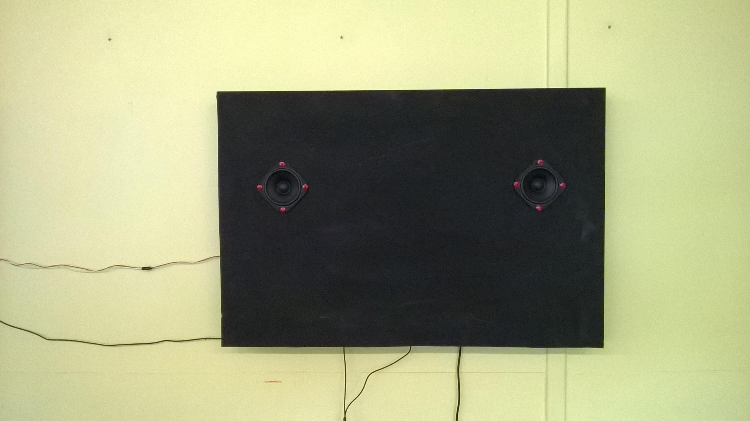

These are terrible photos taken with my phone of my MLTL builds.
They're out of 3mm MDF as foamcore is elusive and expensive here.
I tried one in stereo and really liked it, so I built another and am running each as a single channel driven by two Sure TA2024 amps.
I am waiting for two Sure 3116 amps to try. They are hanging in my workshop.

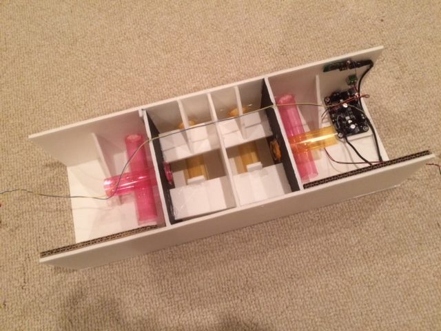

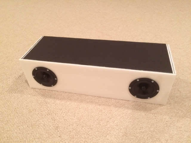

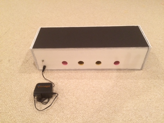

DCR Bluetooth speaker with RS100's
I built a portable BT speaker using Dayton RS100-4's in a dual chamber reflex box. The box was tuned for extension down to 60Hz. Works very nicely with an 8 watt Sure TPA3110D2 amp and a PE BT module.

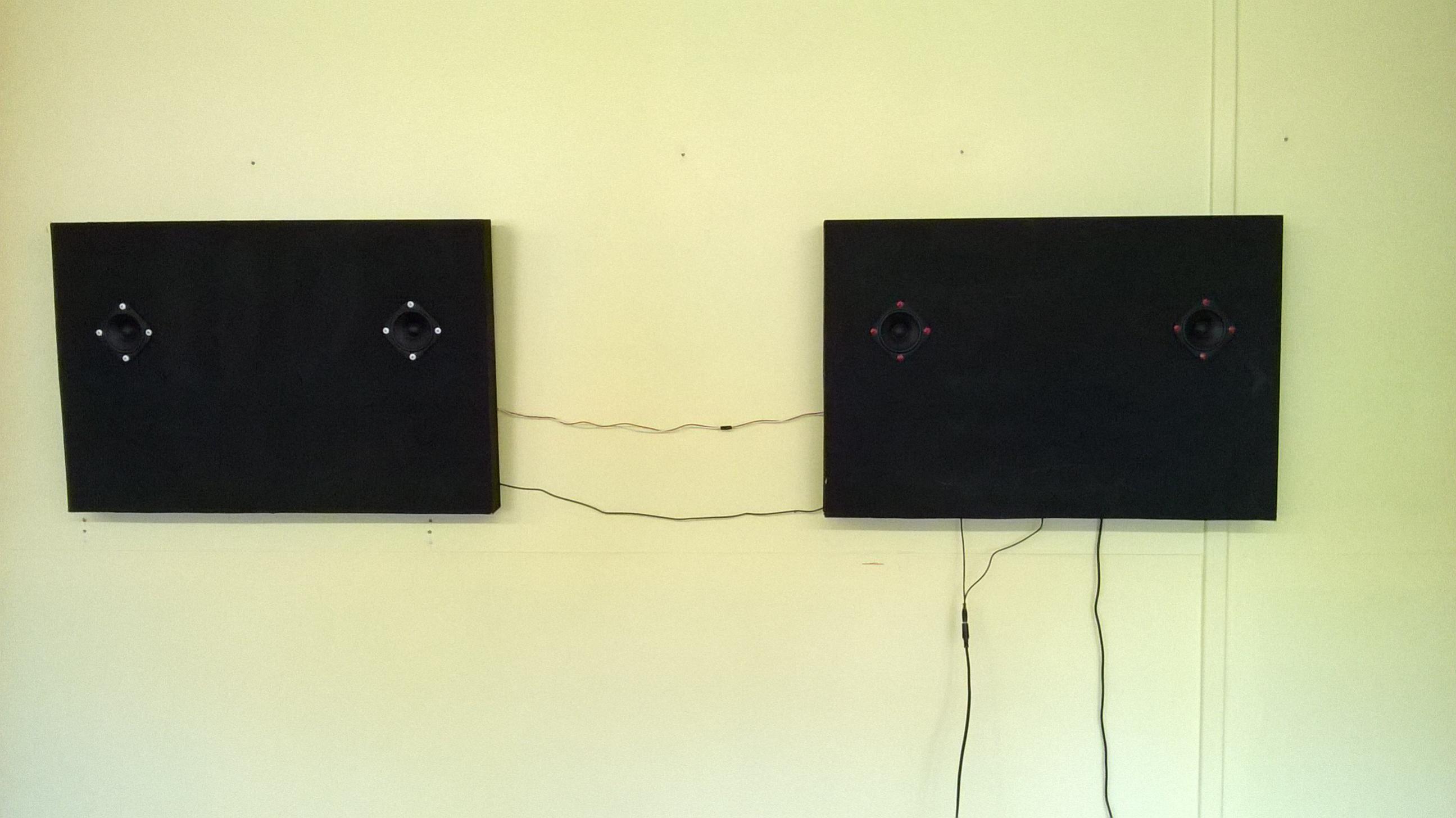

Thanks for the link to the paper - I have not seen it before so can't comment on comparison to BBC results. However, I have found that a CLD formed using two layers of foam core sandwiched with a thick layer of latex caulking compound dramatically reduces harmonic distortion in a foam core horn. It also increased the absolute SPL level because less of it went into vibrating the structure.
More info here:
http://www.diyaudio.com/forums/full-range/259293-prv-5mr450-ndy-fast-applications-13.html#post4036324
Without CLD:
![434942d1408971865-prv-5mr450-ndy-fast-applications-tractrix-no-cld-old-eq.png](https://www.diyaudio.com/forums/attachments/full-range/434942d1408971865-prv-5mr450-ndy-fast-applications-tractrix-no-cld-old-eq.png)
After CLD applied:
![434944d1408971865-prv-5mr450-ndy-fast-applications-tractrix-cld-new-eq.png](https://www.diyaudio.com/forums/attachments/full-range/434944d1408971865-prv-5mr450-ndy-fast-applications-tractrix-cld-new-eq.png)
What was neat was that I was playing music through the horn as I was applying the CLD panels and could hear it transform in front of my ears. Very cool and definitely something to be aware of as a tool to extract the most performance from a speaker. It may not be as dramatic with a box, but a horn, it makes all the difference.
