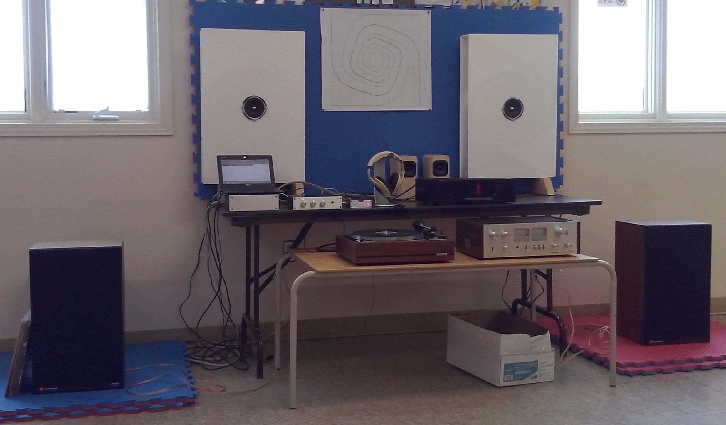

I bought some foam core while cruising through a dollar store and many months later got around to making a spiral cornu. Driver was a TB W4 616S. Drivers were donated by one of the diy Ottawa members. I brought the cornus to this past weekend's DIY Ottawa get together. Folks were surprised by the big sound the cornus produced. They did rattle a bit when pushed hard. They were powered by a vintage Kenwood KM206 150 watt/channel power amp.
for more pics see the following thread and post #116
http://www.diyaudio.com/forums/clubs-events/265017-diy-audio-ottawa-21-22-feb-2015-a-12.html
Nice work! I noticed that they have a rectangular aspect ratio of same as 20x30 DC board. Did you just stretch the perspective of the plan in one direction?
![cheers :cheers: :cheers:](https://files.diyaudio.com/forums/images/smilies/cheers.gif)
yes, I just extended the curves a bit. I used the full size of the foamcore boards 20"x30". If you look at the above photo enlarged you can see a diagonal shadow going towards the top left corner. I am so pleased that I may try 40"x40" next. 36" wide is the largest print I could get at the local print shop. 40" square is what I can comfortably get in the car. There was another pair of foam core at the event on the weekend. If you look at the second last photo where there is a group of people listening to a talk. Look at the right foam core speaker and you can just see the tops of a pair of palm sized foam cores on the table. We did not get a chance to listen to the tiny FC's.

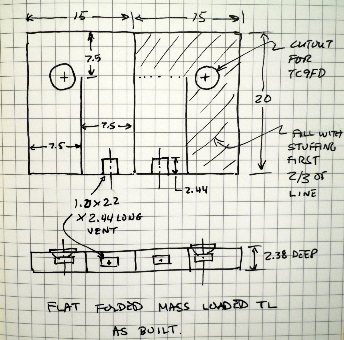

I'm building the wall-mltl for the TC9FD at this very moment.
I made the print this weekend onto a MDF-plate (it looks awesome!!!)
I fooled around with the geometry to keep the aspect ratio of the picture and still stay within the AMLTL logic.
In MLTL-language it turned out to have the following parameters:
L=103.2cm=40.6in
CSA=105.5cm^2=16.4in^2
I have PVC-pipe of which i thought it has 4cm inner diameter.
But i has only 3.5cm=1.38in.
I thought about 10cm of that would be ok.
Any suggestions how long that vent should be?

The length of port decreases as area decreases, to achieve the same tuning. With a diameter of 3.5cm, you are looking at a length of about 2.5 cm

Are you talking about this MLTL?
![334670d1362710759-foam-core-board-speaker-enclosures-p1040134.jpg](https://www.diyaudio.com/forums/attachments/full-range/334670d1362710759-foam-core-board-speaker-enclosures-p1040134.jpg)
The vent CSA is 2.4 in^2 and you want to use a 1.38in inside dia round pipe? I would normally run a sim in Akabak and check but my computer is still down. Ignoring wall drag on pipe vs rectangular slot, the area and length are inversely proportional. So I estimate length of 1.38in dia pipe to be 1.66 in long for same tuning.
