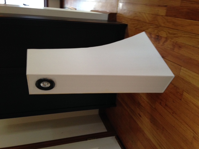

I made this out of poster board paper
With the Selenium horn in back it was pretty narrow up and down, but 180 degrees across. Sounded pretty amazing too. I did the potato masher because it's easier to build than the zig-zag louver type. The flat louver lens is pretty large. They all sound quite good. JBL and every one else moved to constant directivity horns because they could be cast from plastic cheap, not because they sounded any good. The JBL lenses had each plate a different hole pattern for the hardware stack up.

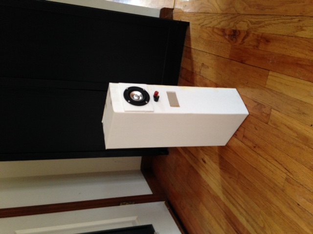

I just started experimenting with speaker building and I love the foam-core method of quickly prototyping. Thanks xrk971.

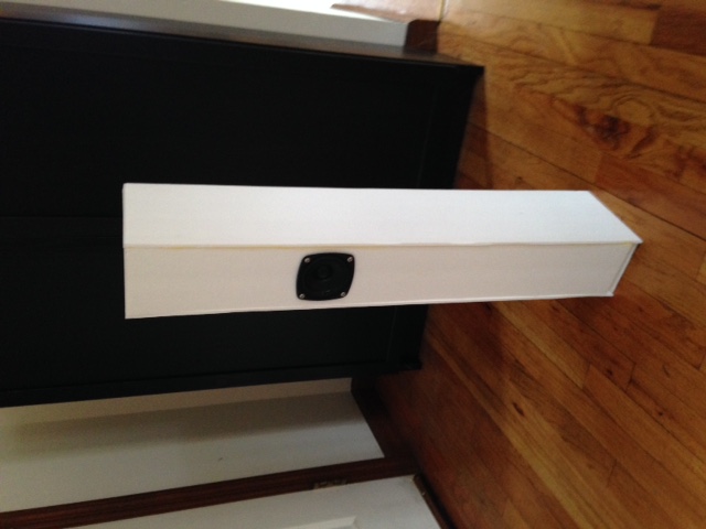

I can hardly keep up with all the exotic builds described in this thread, but I thought I'd report on the few mundane builds with cheap speakers that I did (see pics).
1. FH2 enclosure, FE83 driver (height reduced to 30 inches)
2. Ad-hoc enclosure, topology derived from this thread, FE83 driver
3. TABAQ, TB W3 1053SC driver (also height reduced to 30 inches)
The 30 inch height is a consequence of the foam board dimension and my laziness. And I didn't include a BSC circuit.
I don't have any measurements (no decent mic yet), but I'll give my subjective impressions. The FH2 sounded excellent, clear mids and highs with a healthy full bass. The ad-hoc enclosure sounded almost as good, with just slightly less bass. For both the above, the higher notes were bright and forward, to the point where some people may describe them as harsh. The TABAQ was quite disappointing in the bass department - very weak, but the mids and highs were clear and in no way harsh.
Comments are welcome. Also, I have a couple of FE85's waiting for an enclosure. I'd be glad of any suggestions.

Udoitall,
Fantastic work! I haven't seen anyone besides Jim Shearer and Bcmbob who are brave enough to try the homage to the the FH3. Looks very nice - surprised it works with the Fountek FE85.
If you want a good speaker to try - make the 0.4x Karlsonator - but I recommend you buy some Vifa TC9FD's. A much better driver for smooth mids and nice highs with good bass extension. The Faital Pro 3FE25 is also an excellent driver. I avoid aluminum comes due to fact that they tend to ring and sound sibilant.
