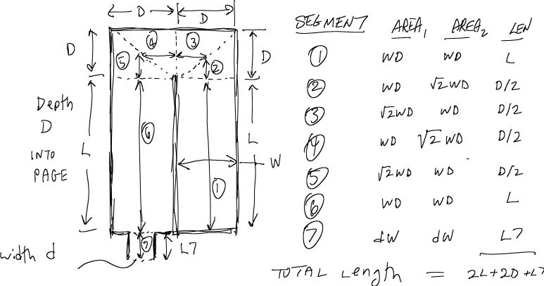

this might be difference in my calculation:
for each fold i added the arc of a semicircle with radius 1/2 of the width of the cabinet.
so in the case of the wall-mltl it was two line segments with the length of (20inch - 7.5inch) plus one arc with a length of (pi * 1/2 * 7.5inch).
this gives about 37inch of L.
Does that mean you use 4 segments for 90* turns?
Hope this explains it (assumption here is that turns are sinple 45 deg turns x 4 = 180 deg fold.
![461929d1422374338-foam-core-board-speaker-enclosures-pathlength-fold-sketch.png](https://www.diyaudio.com/forums/attachments/full-range/461929d1422374338-foam-core-board-speaker-enclosures-pathlength-fold-sketch.png)
The arc would capture the smooth path but in this case there are sharp corners. If you look at what is happening with the cross sectional area through a turn it is an expansion by sqrt(2) then contraction the expansion then contraction. That accordion profile simulates what the corner is doing to the acoustical inpedance well. It acts as an acoustical low pass filter when combined with an inertial factor for flows around a corner. This is all so we can model it with a 1d lumped element model. If we did it with boundary element model we would just use the exact 3d cad model. So short answer is itbis a simple way to simulate effect of sharp turns.
