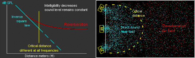

The problem is "your own studio's sound" transported into a another acoustic environment may not translate well. For example, reverb sounding good to you will sound "washed out" beyond the critical distance, the distance from a sound source at which the direct sound and the reflected sound are equal in level.So. I suppose to help out the sound guy as a singer / acoustic guitar player, you could bring your own pedal board, preset with all that you want on it for both vocal and guitar, your own headset mic, in-ear monitor system - and just present an XLR output or two to "plug me in". That way you could bring "your own studio's sound" wherever you go.
Since you can't "back off" a headset mic to adjust your vocal dynamics, more compression is required than one on a mic stand.
10dB compression may require +10dB PA gain, putting your vocal (and or) guitar on the verge of feedback (the mic regenerating the amplified sound). And if the monitors (and the PA) have been equalized for the "house mics", substituting another may not sound right, even if feedback is not a problem.
More often than not, the bring "your own studio's sound" idea is a sound guy's nightmare, there are too many potential problems that can't be addressed without access to the pedal board.
The few that "get it right" have made extensive adjustments to compensate for the sound system and room properties.

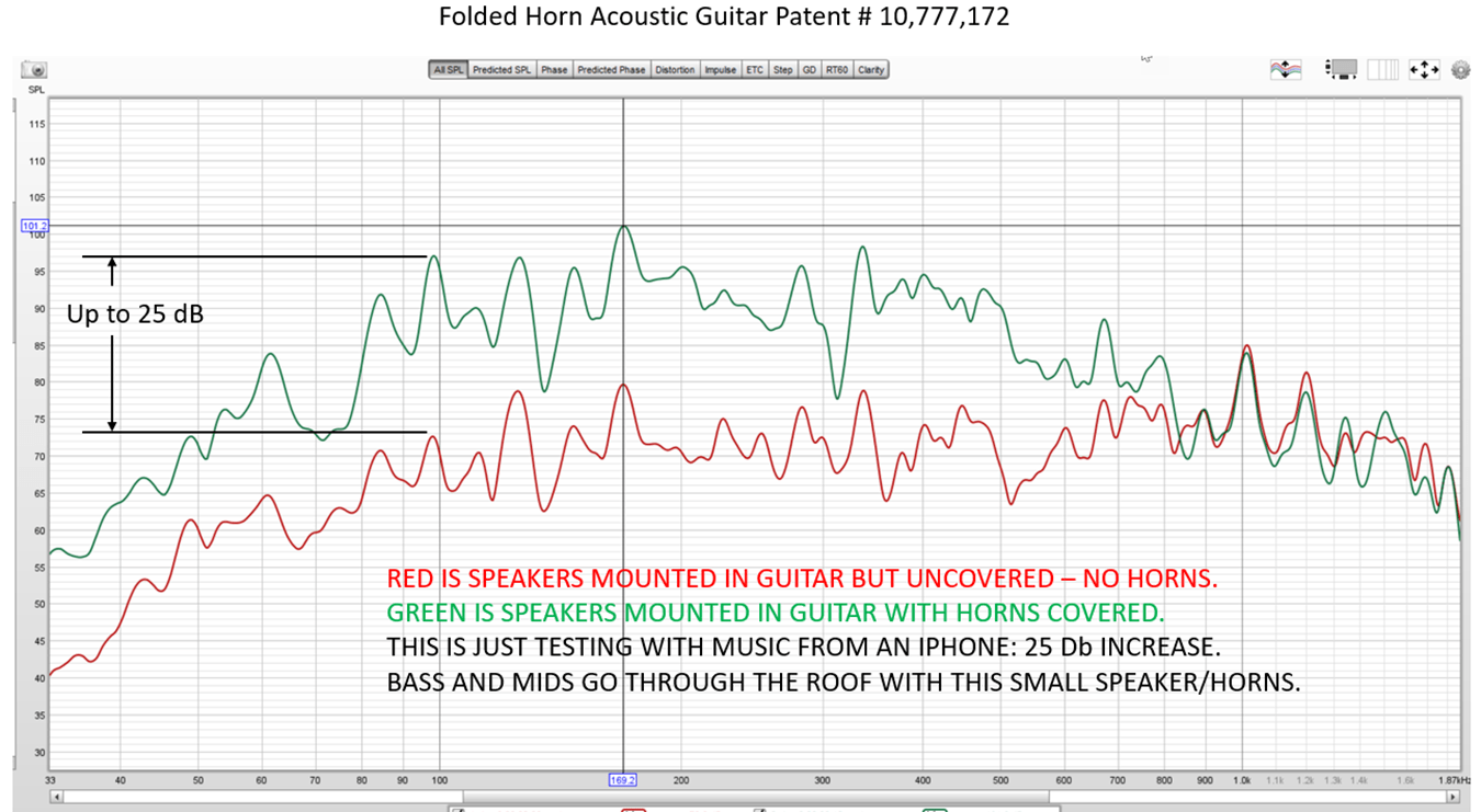

Regarding your studio notes:
"The horns are covered. This increases the lows/mids under 1,000 Hz by 25 dB"
Perhaps at some specific frequency peaks, but no where near that on average.
"The horns are similar to high end horn stereo speaker systems like Klipsch."
High end horn systems like Klipsch use expansion profiles ranging between conical and exponential, yours is more similar to a folded pipe.
"The amp circuit board and controls can be put in the guitar itself as an option."
The Folded Horn Acoustic Guitar Patent # 10,777,172 was all about it being a self-contained unit, a much more saleable option than a heavy guitar with internal speakers that requires external amplification.
The speakers you are using could easily be fried in minutes with relatively low powered guitar amplifiers, especially if allowed to feed back.
"If you turn the volume up to 9-1/2 with high tone settings, you can get the guitar to feedback with control."
That can be done with any acoustic/electric by adjusting amplifier volume and tone controls with it's speaker near the guitar. The guitar's volume could be set to feed back at any number the player would like.

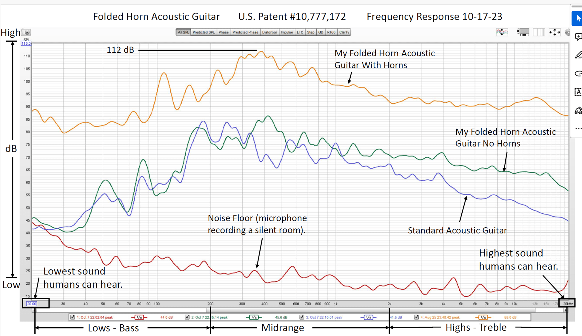

Art - there is no way my speakers will be fried with my amp setup. The speakers can handle more than the amp I am using. I have tested it, and it ROCKS!
OK maybe not 25 dB everywhere, but pretty damn close to 25 dB average, see below.
