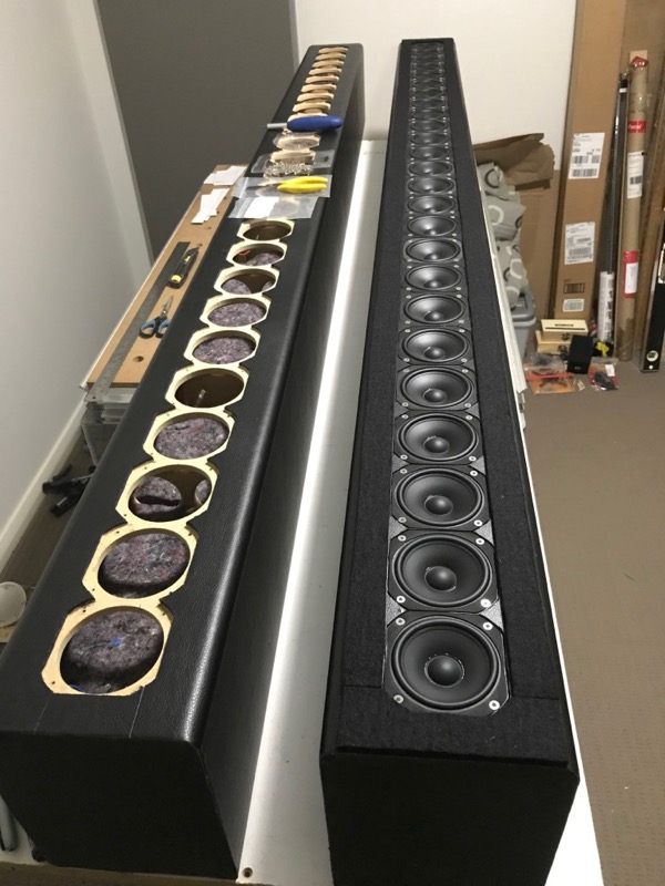

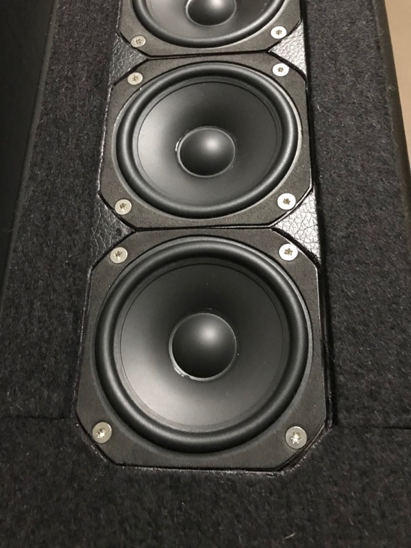

Another step closer, can hardly wait!
The moment of truth is fast approaching!

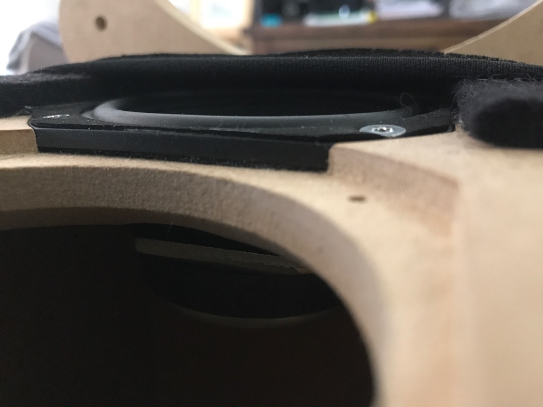

Still it's tough to see on these pictures how much room the surround has to move freely under the sock.
Yes it is very difficult to take pictures that show the full array and still have any detail!

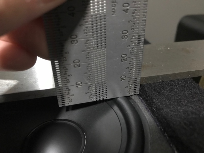

The surround is 1.75mm above the driver bezel and the felt is 4.8mm, so there should be 3.05mm gap between the surround peak and the fabric enough for xmax and a bit spare. I should also have a tiny bit extra as the gasket on the outside of the bezel will be flush with the vinyl so you can add the thickness of that gasket to the gap too.
I can always add some more if I see the sock blowing in the breeze 😀 But I don't think it will be necessary.
These pictures from earlier on when I mocked up the finish show it better.

I'm fairly sure I will, I made some calculations to have enough space for the xmax of 2.6mm even though I doubt I will want or have the amp power to push it that far. 1/4" felt was much more expensive and I calculated that I didn't really need the extra space. But sometimes reality works out to be different than all the best laid calculations so we will have to wait and see 😉

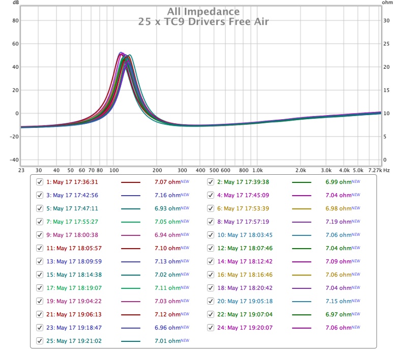

Great to hear first 25 devices checked fine without the needle failure as Pano had in past : )
Thanks, I think Pano might have done more than just run an impedance test.

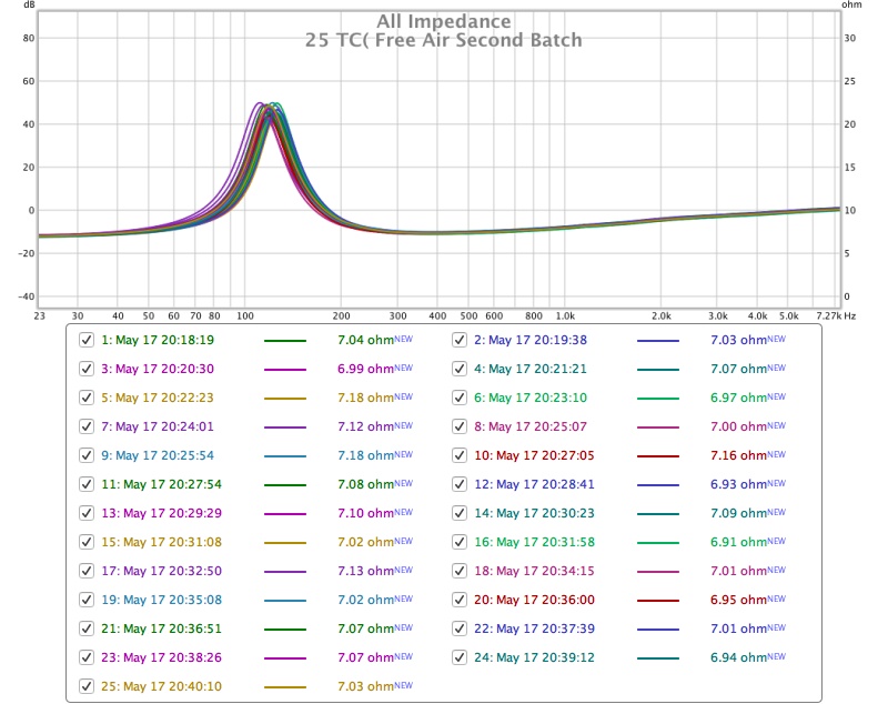

The second set tested out well too! With any luck I should be able to run some impedance tests on the fully wired cabinets tomorrow 🙂
attachment.php
Your most extreme outliers for DC resistance appear to be 7.18 and 6.93. They are all well within 5% tolerance of each other which is good.
Yes I am pretty happy with the result, in general the closer the serial numbers are together the closer the results. It would also be easy enough to match the drivers if you only needed a few.
Not a bad result at that price, right? 😉
Not a bad result at any price as a few percent tolerance usually costs much more 😉

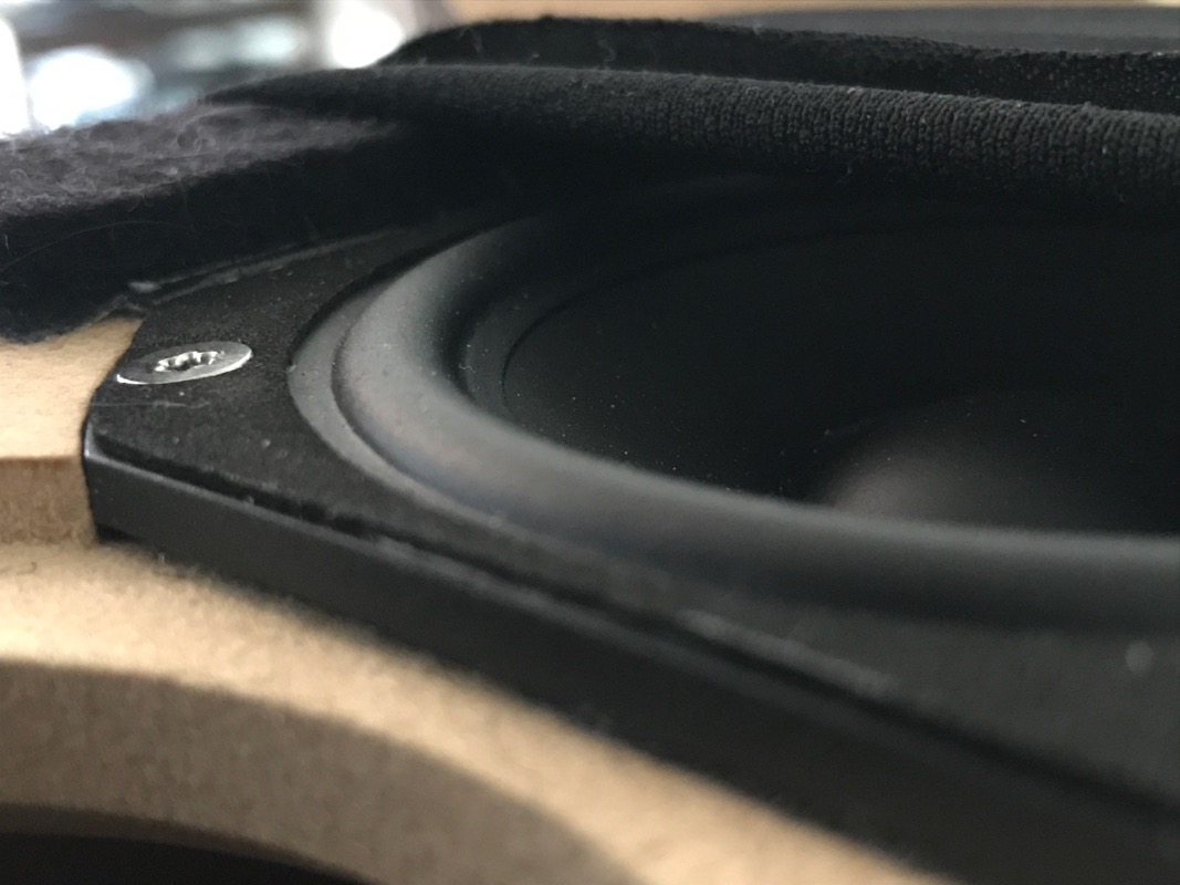

This one's for wesayso, I put a steel straightedge across the felt and measured the gap between the top of the surround and the top of the felt, it is actually just over 5mm which is more than enough room.

Good progress. Did I miss before and after felt placement tests?
No, my plan is to finish the other one without the felt for now and take some outdoor measurements to see the effect of the felt. Either way the felt will be used with the sock as it is needed to give room for the driver's excursion.

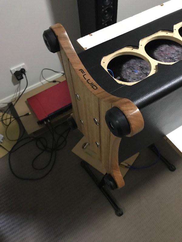

I needed to move the finished tower off the table and then realised that I didn't have any handy lifting points anymore now the drivers are in! Much more difficult and quite a bit heavier with the drivers in.
I have put some rubber feet on the bottom for now while I am testing as the spikes proved to be too sharp to be messed with.

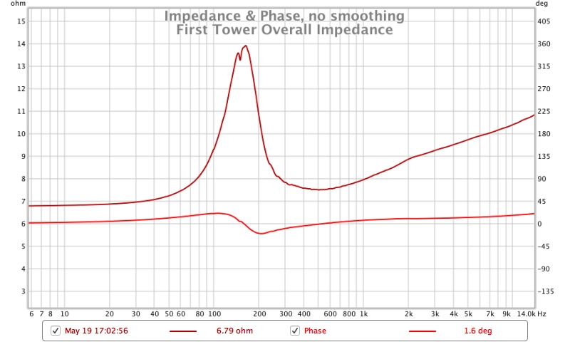

I ran an impedance sweep on the finished speaker. The good news is that I wired it all correctly and it works. It is pretty smooth without any significant resonances. The bad news is that the split in the impedance peak is more pronounced than I was hoping for. I'm not sure if it will present any real problem. The only thing I can think of for the next one is to try and sort the drivers per sub enclosure to try and spread the variance, I'm not sure if this will make any difference but it isn't that much effort as I already have the individual impedance results including the serial number of the driver it related to.

I wouldn't worry much about the tiny notch on that impedance curve. Seems like something fairly minor to obsess over. ACDC sounding like a portable radio through the headphone amp? Isn't that what the typical fullrange sounds like. You should build a one-high to test and see how it compares to the stack.

I don't think obsess is the right word, but I do believe it is important to try and get as many details right if you can. All the impedance measurements from similar line arrays have similar bumps so it is quite likely that it is just down to the fact that 25 separate drivers do not add together any better.
I have one simple thing left to try to see if it makes the result better so why shouldn't I try?

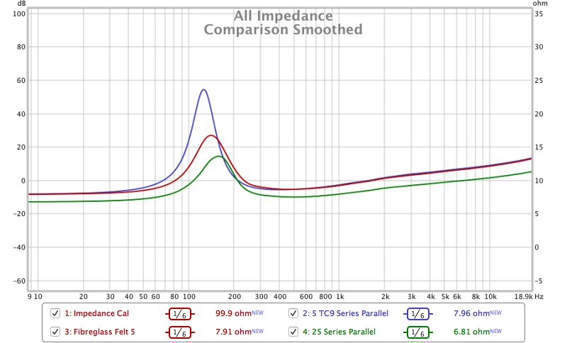

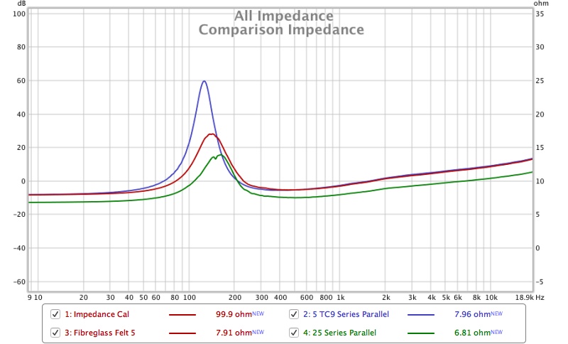

This is a comparison between the 5 drivers in free air, the best 5 driver result in a cabinet and the final 25 drivers. On that scale it doesn't look so bad. The more drivers you add together the lumpier the response gets at resonance. If I combined all the separate impedance measurement in REW it would probably look very similar.
attachment.php
And if I smooth the graph to 1/6 Octave, all the bumps are gone 😉
