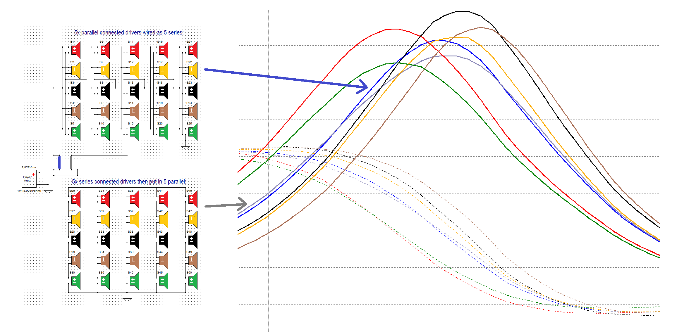

Because there actual was a bit difference in XSim simulation with 5 real world TC9 measured free air impedance used in post 352 simulation when either wired as "5x parallel connected drivers wired as 5 series" or "5x series connected drivers then put in 5 parallel" have this better overview to share.
Added same color to the drivers at left side as they represent in curves at right, and at right all 7 impedances have now their corresponding phase curve presented.

Interesting, Owen! This may show the difference between wiring schemes. Technically or theoretically I can see the advantage.
5x parallel connected drivers wired as 5 series is bringing impedance down (5x parallel) and up again (5 in series).
5x series connected drivers then put in 5 parallel is bringing impedance up (5x series) before getting it back down again (5 in parallel).
I've always wondered how big of a difference there would/could be. I used the second wiring option as I couldn't figure out a few things that might happen. But I always kept wondering what if...
If all drivers were exactly identical, the difference would probably be null. However, if certain drivers had different impedance at various frequencies, then parallel sets of 5, strung in series, the individual drivers of each parallel set would take on different currents, affecting the overall currents in the four remaining drivers of each set. With 5 series sets connected in parallel, each set has exactly the same current running through all 5 drivers, and the current through each set would be an average of all 5 drivers within each set. So a set of 5 drivers in series, connected 5x in parallel, might have less variation between a set of 25 drivers with slightly different characteristics, resulting in smoother sound.
Another advantage of stringing 5 drivers each in series, with each set connected in parallel, is simplicity of the wiring. If the drivers are arranged with all terminals to one side, then each set of 5 drivers connects top to bottom, and a single red and single black wire connect each set. The black wire needs to be tapped 5 times and the red wire needs to be tapped 5 times, such that only the drivers on the far ends of each series set need two wires connected to the end contacts. Compared to 5 drivers in parallel, each set series connected, each driver's plus terminal connects to the plus terminal of the driver above and below it, resulting in more splices and more connections.
So each set of 5 drivers connected in series, 5x sets in parallel, would be simultaneously easier and more convenient to wire up, and have more balanced response between all 25 slightly unequal drivers in the array. My 25 cents...
That is interesting. In a mathematical summation there should be no difference between the wiring schemes but with real world impedance there is. I remember reading you say to avoid series connected drivers in the same enclosure and that being one of the reasons for breaking up the cabinet into sections. Not sure how I got it backwards in my head but I seem to have done the opposite and have all series connected driver's connected together in a common volume! That also makes me think that there is more likelihood of getting a change from sorting the drivers, but it also opens the question which parameter is best to sort them by to reduce the variance from the series connected drivers? The enclosure damping I have used has really lowered the peak but in yours it is still very high, what sort of damping did you use?

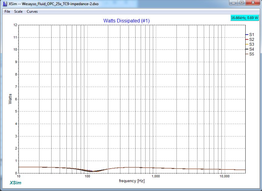

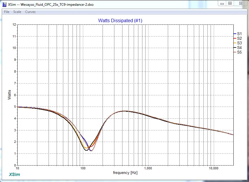

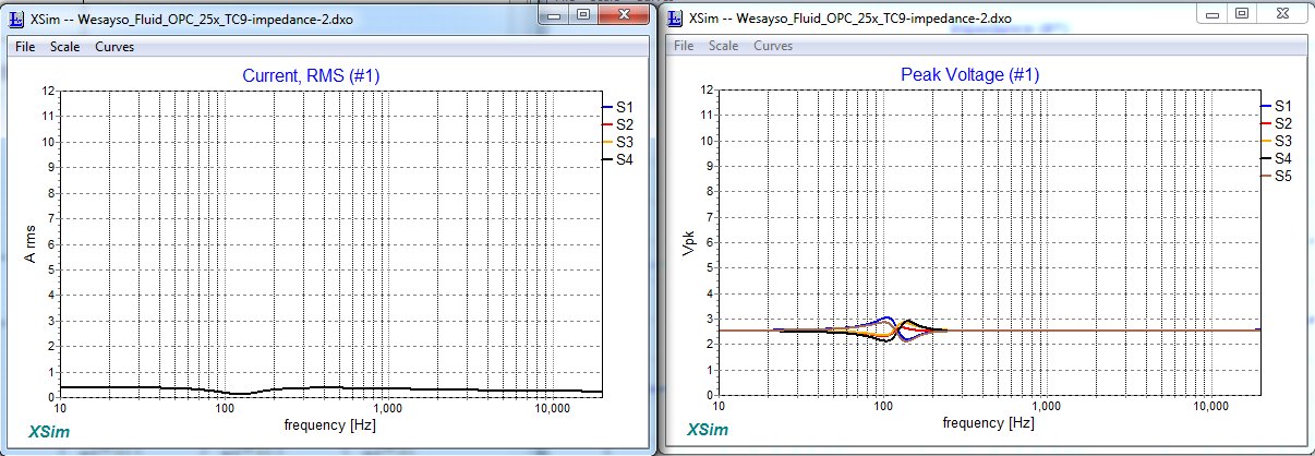

I had begged BYRTT to supply me his X-Sim simulation so I could check it on a driver level to find out what is happening.
(Yes I am that crazy that I would consider doing a complete re-wire :D)

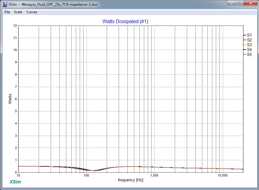

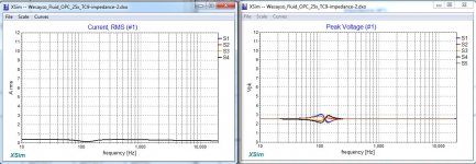

If I plot 5 drivers in X-Sim in series I get this:
attachment.php
This is with 10 watt applied to see the graph more clearly.
S1 to S5 are in series and form one of the 5 strings of drivers connected in parallel.

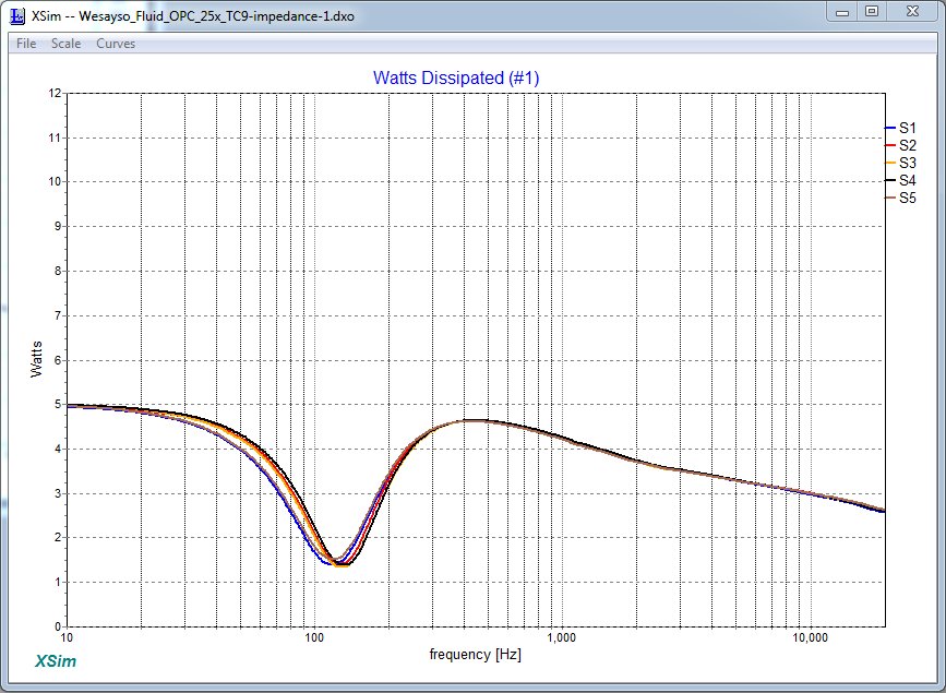

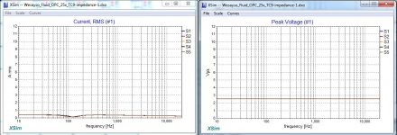

If I do the same plots of Owen's parallel drivers:
attachment.php
Here S1 to S5 are parallel and form one of the strings of drivers in series.
Again 10 watt applied to the complete array.
I think Owen (OPC) might be the brightest one here ;).

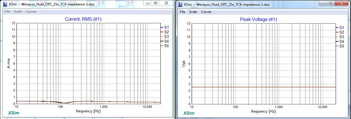

Let's look at the watts for both of these cases:
First in series:
attachment.php
versus in parallel:
attachment.php
This is only a first look but I genuinely think Owen was on to something here.
Lets pump up the watts, plot it at 100 watt into the array!
First the series connected drivers:
attachment.php
Then the parallel connected drivers:
attachment.php
Thanks to BYRTT for supplying the sims, to OPC for opening my eyes, to bwaslo for the amazing X-Sim program and fluid for the hospitality on this thread :).

opc
Joined 2004
Hi Wesayso,
Amazing work here! I'm very glad you took the time to run this as I just didn't have the time to run the sims and to get such a concise summary together.
Also, to be clear, I'm definitely not the smartest one here... I've just been lucky enough to run into these things throughout my career, and to learn from people far smarter than I could ever hope to be ;)
In addition to this, your arrays kick my array's butt!
I also didn't want to rain on fluid's parade as I know how much work it is to get the arrays wired up, and he hit a pretty big milestone getting both arrays up and running.
Some background on this:
My first job out of school was at Paradigm and the first project I worked on was the 3kW class D amplifier used in the "Sub 1" and "Sub 2" products. A quick google search will show you what these look like, but they are basically hexagons where 6 individual drivers share a common volume, and are all driven by a single amplifier (Sub 2) and two amplifiers (Sub 1).
The prototype version of this product used a series arrangement for the drivers (I think it was 2 ohm drivers wired 6 in series for a 12 ohm final impedance to get maximum output from the amplifier). This version literally tore itself apart, completely snapping a cone in half on one of the drivers. I didn't understand this at all, and asked my manager at the time what on earth was going on. He explained that when they are series wired, the individual drivers are not necessarily at the exact same position, and if one gets out of phase enough with the others, the remaining 5 drivers will destroy it. In addition to the potential for damage, it also has a huge negative impact on output for obvious reasons. In the end, the drivers were changed to be 70 ohms and all wired in parallel. This arrangement worked perfectly, and is what is shipping today. At the time I didn't really understand it, and just wrote it off as "oh, that's cool.. don't wire drivers sharing a common volume in series". I was more of an amplifier guy than a speaker guy back then ;)
Later in life, at Blackberry, when I was spending more time doing microacoustics, I asked our local physics/audio guru guy if he had ever heard of this, and he said it made no sense... both series and parallel wiring should not make a difference. I insisted that it did, and he was interested enough that he built an entire model (at the time in our custom BlackBerry acoustics simulation tool) and sure enough, the cone position of parallel wired transducers remained very close, where the cone positions of the series wired devices were all over the place.
To be honest, I still don't fully understand precisely what the mechanism is here, but I think the answer would be obvious if you used a Klippel to plot cone position, terminal voltage, and current as a sine wave on a scope while sweeping frequency. Below resonance cone position should be proportional to voltage, at resonance I don't really know, and above resonance things should go back to voltage proportional until breakup occurs, then all bets are off. I get the feeling that in the above scenario, voltage will track much more closely to cone position than current will throughout the entire frequency range, but in particular, at low frequencies and at resonance where it matters most when several drivers are sharing the same volume.
If there is any way to plot excursion of the 5 drivers while accounting for the shared volume, that would be the best way to show the impact of this.
At the end of the day, this is definitely not a minor detail! You will get significant benefits from only running parallel drivers in a shared sealed volume. My apologies to fluid for being the bearer of bad news :(
Owen
