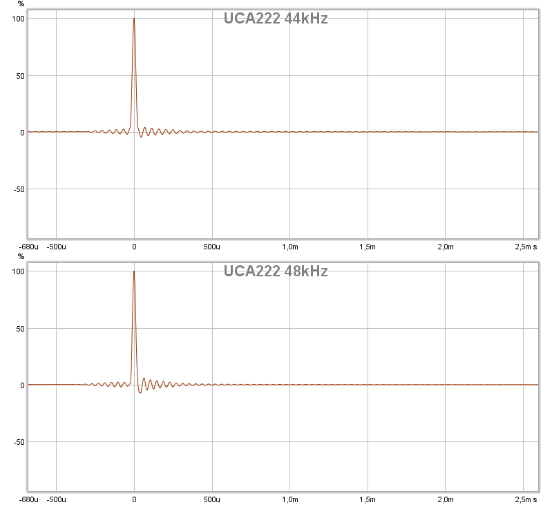

Your eye is off by a few microseconds as the measurement was done at 48K so the ringing is probably closer to the 24K half sample limit. Good deduction on the timing but not outboard DSP just the DAC filter which could be considered to be internal DSP![]()
We first need to determine if the "ringing" is an artifact of the speaker array, the amp, or the DSP, but IMO it does not matter. I am counting roughly 4.5 oscillations over a period of 200 microseconds. That gives a wavelength around 44 microseconds.
1/.000044s = 22,500Hz, so this "resonance" is above the range of human hearing and should be completely inaudible, whether caused by the speakers, amp, or DSP is irrelevant. And my rough estimate by eyeballing the graphs is right at half the sample rate of 44.1kHz CD audio or 22.05kHz, so the 22kHz ringing is very likely a DSP artifact.

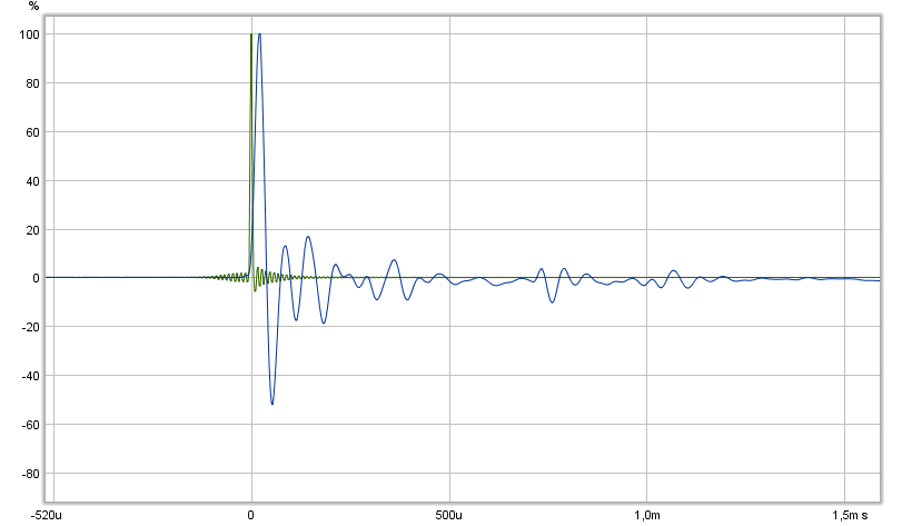

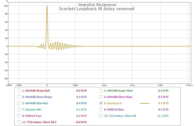

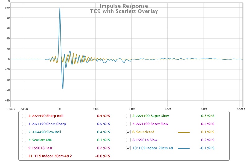

I removed the IR delay and put the soundcard impulse against the TC9 measurement and you can see where the ringing lines up and it rings for just over 500usec.
Byrtt do you have a measurement of the TC9 with the Behringer soundcard as the ringing does look to be very similar?
Another thing that was surprising is that the calibration of an onboard soundcard you posted in the rephase thread also had very little ringing in comparison.
When the soundcard is calibrated the frequency response and phase are compensated in a following measurement of the same device but the impulse response looks identical.
Do you think that dividing the calibration to end up with a pulse and then using that somehow to remove the ringing from the soundcard and see just the speaker response would work?

The latest graphs also show ringing with constructive and destructive interference ripples. If there is a 44100 <-> 48000 conversion anywhere in the chain, then ringing near half the sample rate will cause moire patterns. Or possibly 22050Hz and 24000Hz waves interfering will do this causing amplitude modulation. Any two notes of equal magnitude and close in frequency will constructively and destructively interact.

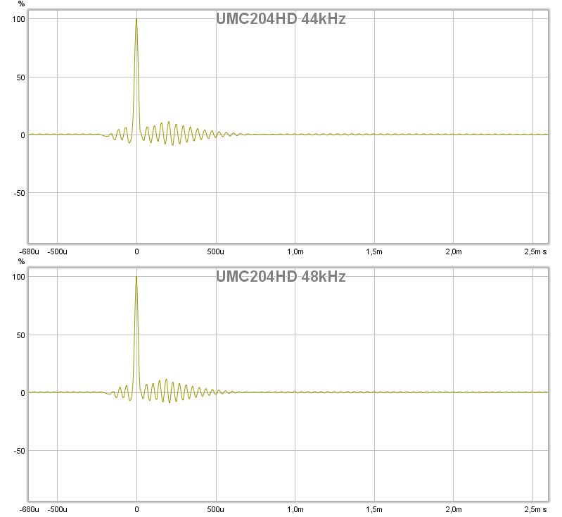

Have only loopback measurements for UMC204HD and find visuals below in same scale as yours, bit surprised they exactly the same even mine is another brand and 2ch in / 4ch out where yours is a lot more, from inside inspection of mine can tell its the famous asynchronous USB Xmos chip and Cirrus Logic ADCs/DACs in this interface. It looks problem is their coded filters at 44/48kHz if using 96/192kHz ringing gets much less. Don't no about Mac OS but in Windows OS shift REW to ASIO and 96/192kHz gets available settings. First below is UMC204HD at 44+48kHz and second UMC204HD at 96+192kHz, third is talked more about below.
Yes onboard ALC892 codec from RealTek on this Ivybridge generation computer is much better, even the still avaiable old very cheap 16bit UCA222/202 from Behringer is excellent into IR and actual also sounds very good when playing native CD material and i think xrk971 support me in this opinion, he have UCA202 which is relaxed silver painted and i have UCA222 which is bit alarming red. Find it bit strange why most old interfaces is perfect filtered by the book and many new ones show such tendency.
Agree using such ringing interface if we want to see speaker IR alone its better into REW not set a calibration file for that loop and instead add from a saved mdat-file that interface loop to current measurement session and divide.

. In a speaker measurement you won't find the ringing of a DAC after the main pulse. It will be dominated by different frequencies and/or reflections of the driver itself. You'll only see the pré ringing part. What you're looking at is a combination of the entire frequency response. Though high frequencies usually dominate it's shape.
I'm not surprised you can't hear a difference between them when most of the ringing is above 20 KHz. It's good to know what you have, but there's a lot more data behind that IR rendering which is why there are so many ways to view the same data.

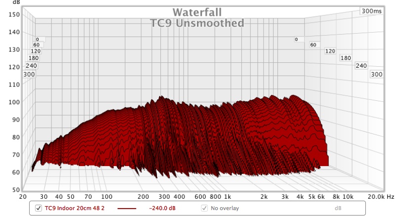

I'm not sure about that. The waterfall plot looks very clean to me. Here is an un-smoothed plot of an indoor measurement at 20cm.

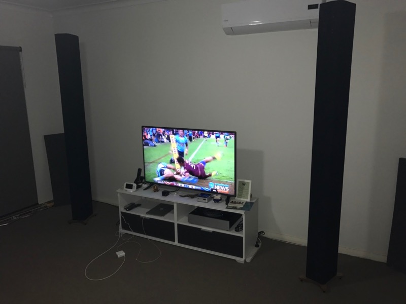

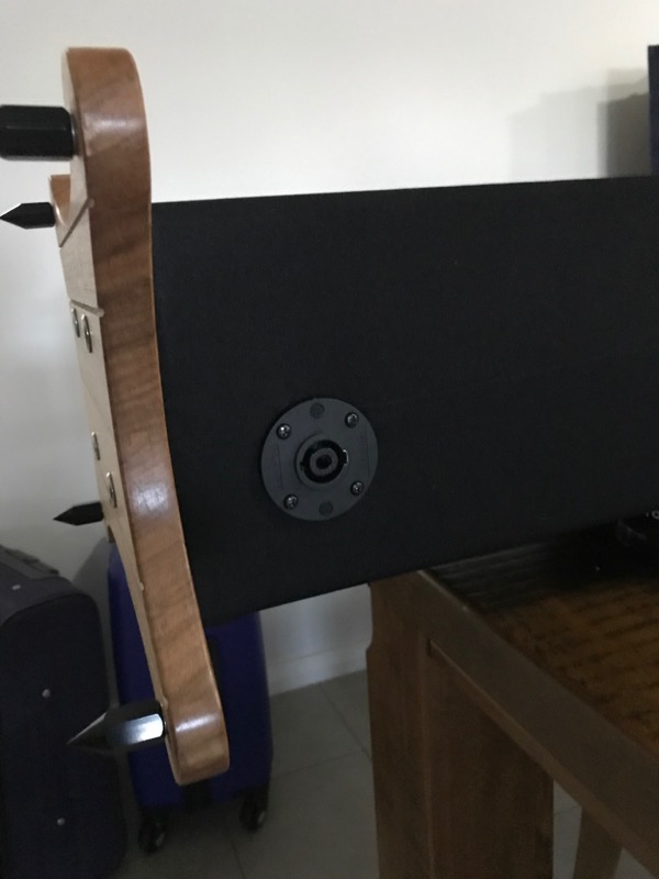

As it could be forgotten that this is a thread about a line array build I thought I would show what I have been up to today.
I felted the other speaker and put the socks on.
This is how the speakon looks on the back with the sock in place. Pretty happy with that.
I have put them in living room in preparation for some listening, not the best photo but that's the best I can do tonight
