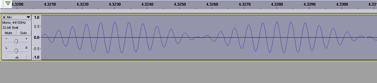

I have uploaded an audacity screenshot showing the result of adding a 2205Hz and 2400Hz waveform. The graph I referenced had evidence of two independent ringing frequencies which constructively and destructively combined resulting in the waveform. So the amplifier rang at two distinct frequencies which had roughly the same decay time, possibly a result of combining the left and right channels together.
I think I see what you are saying. In Byrtt's graph at 192K it might look like that but the shape of the ringing is divided by the peak into pre and post ringing, the shape is only relevant if it appears either before or after not separated by the peak.
In my Scarlett graph and in Byrtt's UMC graph the post ringing does show that same pattern. Hard to say why that is as there was no sample rate conversion or mismatch involved.

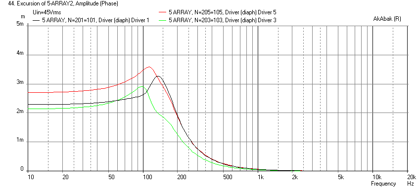

Here are the simulations of the cone displacements for a 2L rear chamber per driver, with 9V (parallel) and 45v (series) with stuffing in rear chamber.
SERIES:

PARALLEL:
618348d1495874276-full-range-tc9-line-array-cnc-cabinet-array5-parallel-displ-45-stuffing.png
This is an intriguing result. It makes a strong argument for multiple low power amplifiers to drive two or three parallel connected drivers, or perhaps a 2s/2p at the most, in order to maintain better control the voice coils.

Yes, I never would have thought the differences would be so great until I ran the sim. It was Wesayso who urged me to run the sim. In reality, we probably won't hear much of this because the cones are flapping about in their linear range. It's when you start pushing power through them and some may be hitting xmax or beyond. There will be more distortion on the cones moving more of course. On a a line array with 25 drivers may be less noticeable than a single. But I the quality of the overall I integrated sound in distortion and phase space may not be consistent. Even if we can't easily hear the difference. It does say to choose parallel over series. And ideally a single amp for each set in series. Here is where 16ohm drivers like Faital Pro 3FE22 are handy.
As this simulation of pure parallel vs series has the greatest variation around the Fs of the drivers it would be interesting to see if the conjugate impedance flattening circuit that wesayso uses reduces the variance, while a little more work to put the components in the simulation it could be a useful data point.

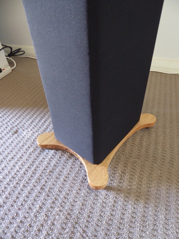

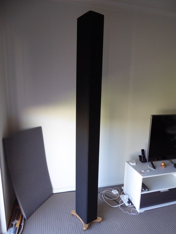

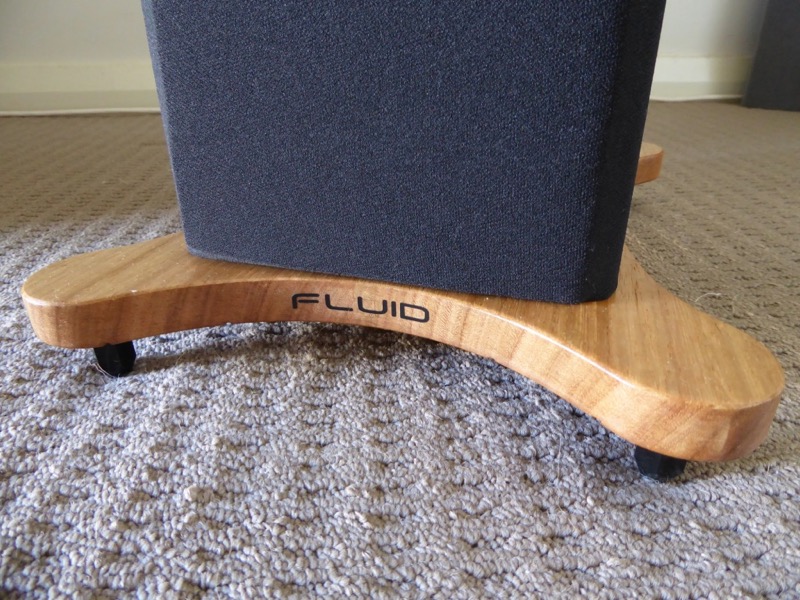

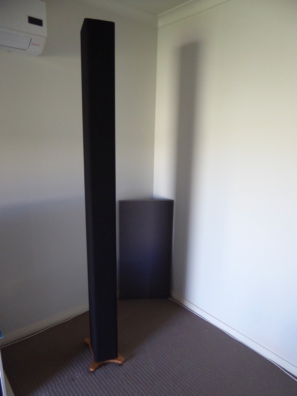

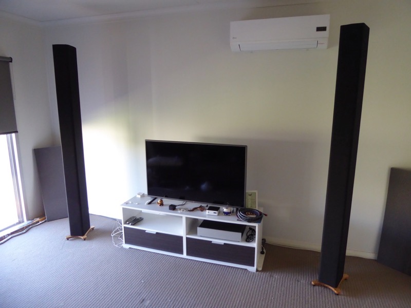

I have tried to take some better photos of the finished speakers in room.
I am very happy with how they look and are pretty much what I envisioned except I think that I underestimated the height in my mind!
Not the best pictures in the world but hopefully you get the idea. Big black rectangles are not that easy to photograph inside 😉
I am going to be away for the next few weeks so in room measuring and listening won't be happening until I get back.

Hello Fluid,
Going away for a few weeks without leaving behind a listening impression of those 'big black rectangles'?!
Very nice build. Guessing these speakers would pull the 'disappearing act' to a spectacular feat as often attributed to such arrays and considering your matt black stealth finish, only feet are showing!
Hope its not too early to ask, are you planning on a sub or a super-tweeter?
And, what amplifier are you using, an UcD? Sorry, I missed that in the long thread.
Thanks for all the positive comments guys, I was starting to think I might have scared everyone off with the side discussions of ringing impulses and series/parallel wiring!
Hello Fluid,
Samuel I am afraid so, the only listening I have done has been to one speaker in mono with rough EQ and I liked it. Hard to say anymore than that given the circumstances but I did listen to it like that for about an hour. If it was rubbish I would have stopped at one or two tracks 😉
I don't plan on a sub or super tweeter. The point of these for me was to be able to get a full range music system in a small footprint so that they can fit easily in a living room.
I could be persuaded on the subs as there is no replacement for displacement but extra speakers wires and amps for them isn't what I want right now. I have the parts to build some synergy style horns and subs will be part of that system.
One of the great benefits of a tall line array like this is that vertical listening height is not really an issue, if you put a single tweeter in that goes away. I do not see any value in producing frequencies above 20kHz and the arrays get close enough for me in the measurements so far.
The amp I have been using is my 8 channel UcD one, only the two UcD400 modules are being used. I have built a First One M to power this system along with an ES9018 DAC. It remains to be seen if the amp has enough power at 160W (8 Ohms), it should be OK as Wesayso uses 100 watts. I need to do some measurements on that amp to confirm if I have the bias set correctly before I start listening to it seriously and I need to know how much voltage I get out of the DAC at different frequencies due to the EQ scheme.
Wow, they really look great!
Thanks 🙂
They look really professional fluid. Very clean. Can't wait to hear what you think about the sound of the line array!
Thanks, me too but it will have to wait as I have run out of time 🙁

Very nice build Fluid. Super pro looking with a cloth grille. Are those base foot extensions strong enough to withstand the weight - I see grain going across area of max cantilever stress.
Have good holiday.
Thanks 🙂
I'm not worried about the wooden base, it would take quite some effort to weaken 19mm solid oak. The wooden base is two pieces joined through the centre with a glued tongue and groove joint. Each side has two 40mm x 6mm bolts with large heads that go through the wood and screw into insert nuts that are set in the bottom of the cabinet. Each spike is fitted into another insert nut that is screwed into the wood very tightly. The load is spread quite evenly so I can't see there being undue stress on the outside.
Wow, gorgeous build fluid! Nice work! The wood provides a nice contrast. Room looks a little bare though. Are you planning to build some kind of absorbers, etc... maybe you already have something.

You are right the room doesn't have many absorptive surfaces. This is a rented house which will not be the arrays forever home and it is also a living room so there is not much likelihood of large damping panels and bass traps appearing. I have considered making a damping poster like wesayso did to put behind the listening position as that could be used anywhere in the future. I am hopeful that the arrays will be pleasant enough in this room but I am under no illusions that it will not be as good as them being in a treated room. I think it's important to consider how they perform without treatment as the vast majority of listening spaces have no room treatment.
