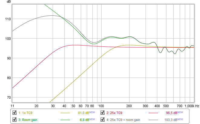

One response below is 1x TC9 feeded 12,5 watts and the other is 25x TC9 feeded 12,5 watts, look the lower red curves which show excursion fall from max excursion to about 0,5mm with 25x TC9 and now lets tap response out at 25x TC9 curve four meter away (-6dB) from 1x TC9 curve which is close to PRO world recommend 84-86dB SPL at listening position.
attachment.php

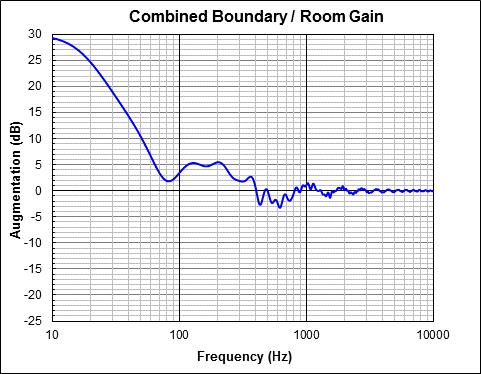

Grey is sum of room gain times 25x TC9 response into REW.
attachment.php

* 26 dB rise at 30 Hz vs 250 Hz
There is that level of change in the frequency response but it is because there is EQ cut above 150Hz due to the line array gain in that region. Seems like you keep missing that part. If you add in the room gain the boost would likely drop to 12dB or so but I will show the in room plots when I get there.

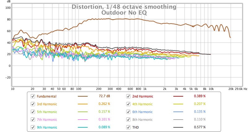

Where does this 10% number come from? Un EQ-ed line array as posted by fluid?
I don't know either REW says 6% at 50Hz in my measurement.

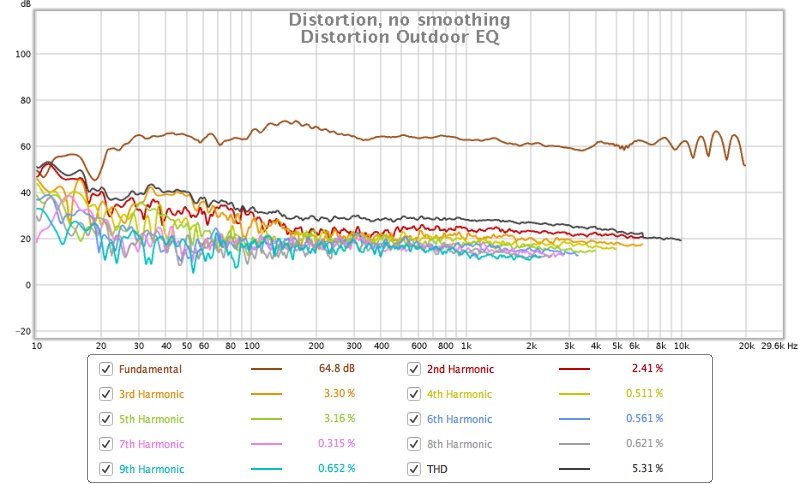

Seems like there might have been some confusion over the distortion graph being EQ'd vs No EQ. What is interesting is that the EQ did not raise the distortion very much in the low frequencies outdoors.
Lets only compare or discuss above 50Hz because below that environmental noise could well have affected the measurement.
If we were to add 10 to 15dB to the signal from room gain like Byrtt showed the distortion would be very good to quite a low frequency.

The graph in:
http://www.diyaudio.com/forums/atta...rray-cnc-cabinet-distortion-outdoor-no-eq.jpg
says it all and don't defy physics

But, at 87 dB RMS and normal roomsize (roomgain) and RT60 values I believe you in saying this construction can play very undistorted.
To make any useful bass with an array of small drivers you need the room. This system is meant to be close to a wall (I am 0.5 m from the wall with the baffle for a reason)

Again the needed execurtion at 30 vs 250Hz sees the difference in dB not the absolute values.
The EQ cuts from 150Hz to 1.5K which reduces distortion in that range as you see in the EQ vs no EQ plots above.
What you might not appreciate is that the drivers are barely moving to produce the un EQ'd response at 80dB. The rolloff of the sealed box dictates the low end response and that is basically the same as a single driver in a 2 litre box. But because there are 25 drivers when the low end boost is applied it still doesn't cause the drivers to have to move a huge amount which is why the distortion doesn't rise hardly at all with the EQ boost at that level. Cutting sharply below 20Hz helps a lot too.
The downside like with all EQ boosted sealed speakers is that to achieve the boost the overall signal level has to be attenuated and then more power applied back with the amplifier limiting the maximum spl.
In this system it is much more likely to run out of amp power before the drivers run out of linear excursion.

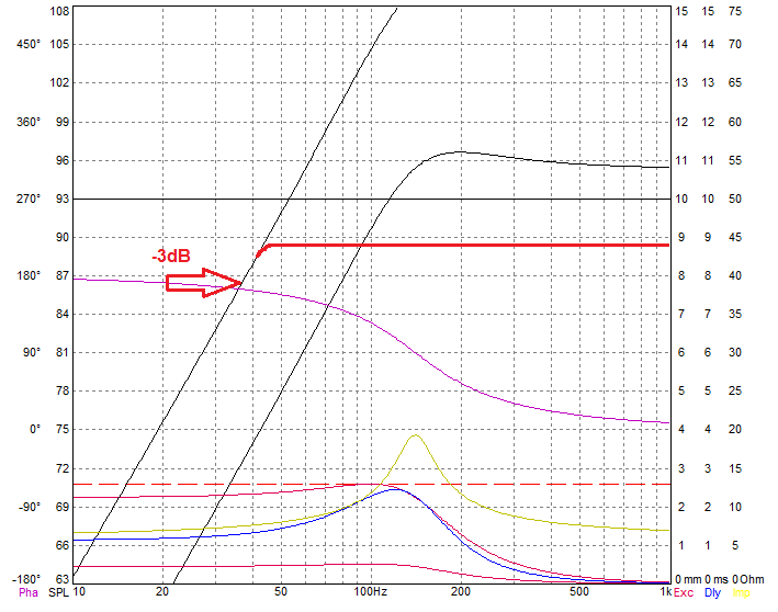

https://www.parts-express.com/pedocs/specs/264-1062--tymphany-tc9fd18-08-spec-sheet.pdf
So 85 dB at mid and 60 dB at 30Hz
32 drivers is 2^5 so max 6dB*5 = 30 dB rise with 32 drivers summing perfectly. That is 90 dB sensitivity total max at 30 Hz. That is 2,83 volt applied to each driver.
Interesting to model the cone displacement at that frequency and volts. (or is it 3mm at 9 volts => 1mm at 3 volts.)
And the x-max is tiny 2.6mm so very little cone displacement is needed to push the cone into unlinear area.

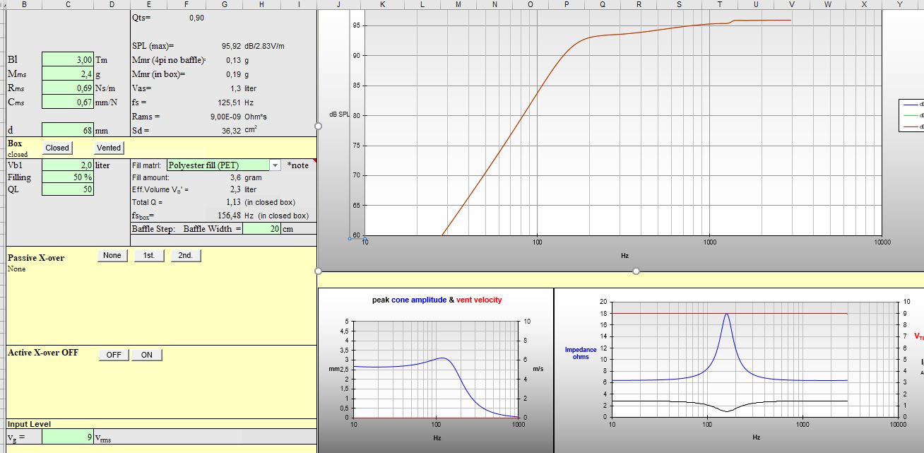

Enclose simulation from scan-speaks excel sim.
Share links to zaph's measurements of similar vifa driver.
http://www.zaphaudio.com/temp/Vifa-TC9FD18-08-TS.gif
http://www.zaphaudio.com/temp/Vifa-TC9FD18-08-FR.gif
http://www.zaphaudio.com/temp/Vifa-TC9FD18-08-HD.gif
Scan speak estimates 61 dB at 30Hz for single driver at 9 volts.
+6 dB each doubling of number of drivers gives max 5x6dB = 30 dB
So drivers combined can produce max 91dB at 30Hz when compared to other single drivers.
The drivers are actually a 15" with Fs at about 120 Hz , 3mm x max and 125dB/m SPL at 2,83V (At high frequency they only add 3dB each doubling and betwwen 6 and 3dB in between)

Simmed without help from the room the X-max figure will get you to about 94 dB at 30 Hz, which luckily isn't x-mech on these drivers, they have a little extra movement to spare. This is before any room gain is accounted for.Free standing outside you'd be wise to cut them off at ~70 Hz to hit an honest 110 dB.

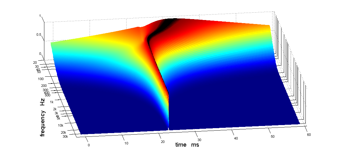

APL Timing chart:

You've already seen one of many distortion charts available in my thread.

Synthetic example below is 17Hz-22kHz pass band with a downward tilt as frq goes up, using traditionally minimum phase XO at HT recommended 80Hz frq point both LR 4th and 8th order shown will introduce some delays, do we have tendency mask these delays asking for a more hot house curve at lows and thereby demand for sub section has more head room as the nice performing ones torgeirs talked about.

Yes, sorry to make a stirr. Just to clarify. To compare the 25 units with one 16 inch, the about 120 hz Fs has to be taken into the equation.
I think it is interesting to read that a "25 cone unit" that is driven below fs from 150 hz can produce undistorted sound at normal levels.
I look forward to the 30 hz + 1k test. How loud can the 30 hz be before distortion can be heard/ measured at 1k
Think the bass stimuli could also be pink noise from 30 to 150 hz. (Region where displacement is "constant" with Volts and frequency.)
