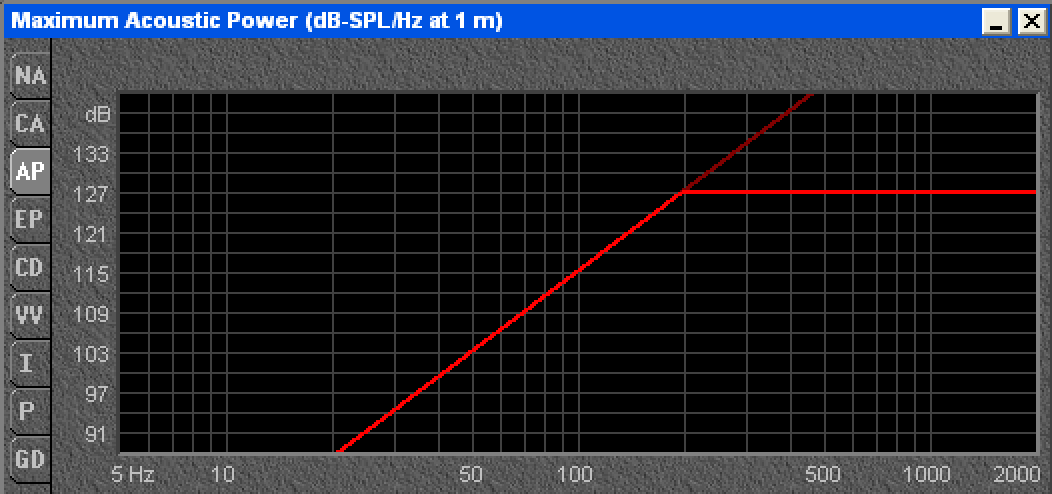

I couldn't help myself 😀 Owen's comment about volume displacement got me thinking that I could compare the array to my LX521 speaker that has two 10" Seas drivers with 14mm x-max in an open baffle. Here is the linkwitz spl max spreadsheet, green is the LX521 and blue the array. They are the same at 50Hz and below 50Hz the array has more output. The red line is the two 10" woofers in a sealed cabinet for comparison.
attachment.php
In my current room the LX521 can produce more than enough low bass for my taste even on tracks that have significant content below 30Hz which really pumps the woofers. It is the sound of the mids and high frequencies that has me turning the volume down.

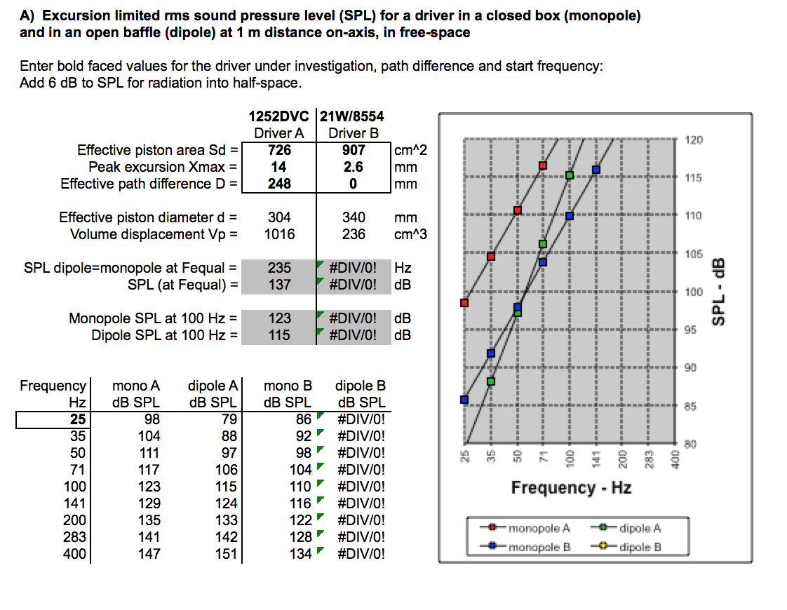

The linkwitz values are a bit lower than some other calculators. The 94dB at 30 Hz that Torgeirs quoted, is the exact same figure that Bassboxx Pro gives for 25 of the TC9 drivers at x-max in my cabinet.
attachment.php
Click on the attached image at the bottom for full size image.
This compares well to the Small chart for VD vs SPL. A single array has a VD of 235cm3 and the 200cm3 line is at 96dB which is a peak figure and would be 93dB for RMS.
Not quite, but close:
Scan speak estimates 61 dB at 30Hz for single driver at 9 volts.
+6 dB each doubling of number of drivers gives max 5x6dB = 30 dB
So drivers combined can produce max 91dB at 30Hz when compared to other single drivers.
Simmed without help from the room the X-max figure will get you to about 94 dB at 30 Hz, which luckily isn't x-mech on these drivers, they have a little extra movement to spare. This is before any room gain is accounted for.Free standing outside you'd be wise to cut them off at ~70 Hz to hit an honest 110 dB.
Yup, and now add the room gain (BYRRT's chart seems about right) due to the arrays being close enough to the wall to profit from that.

A single Scan Speak 30W type of driver (I'll be using 2):
466 x 12.5 = 5825 (volume displacement)
One array of TC9's (I am using 2):
36 x 25 x 2.55 = 2295 (volume displacement)

To compare VD
Epique24 15.6 x 24 x 0.19cm = 71.1cm3
TC9 Line Array 36.3 x 25 x 0.26cm = 235.95cm3

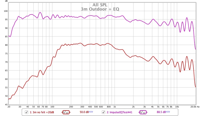

Here is my array outdoors with and without basic EQ on a graph with 1/12 Oct smoothing that has a similar scale for comparison.

Of course Fs matters. Below Fs, you need higher and higher amounts of EQ and power. Remember that this is a driver with an Fs of 125 Hz. While the idea of single driver (albeit 50 of them) operating from 20 Hz to 20 kHz sounds romantic, there is no real downside to using multiple subs and evening out the room response. Once properly integrated I bet you cannot tell the difference between the two arrangements.

I know it would be less ideal with your small cabinet, but did you ever EQ it to 20 or 30 Hz and listen to it that way?
The disregard for Fs I mention needs some explaining I see. As long as there is room for EQ, both in output of the drivers as well as the headroom in the rest of the chain, the exact point of that Fs does not matter. Without EQ these things will sound like .....
