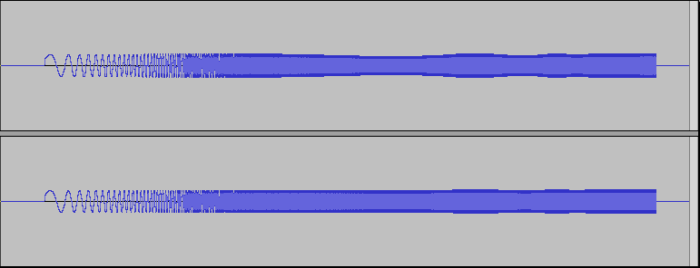

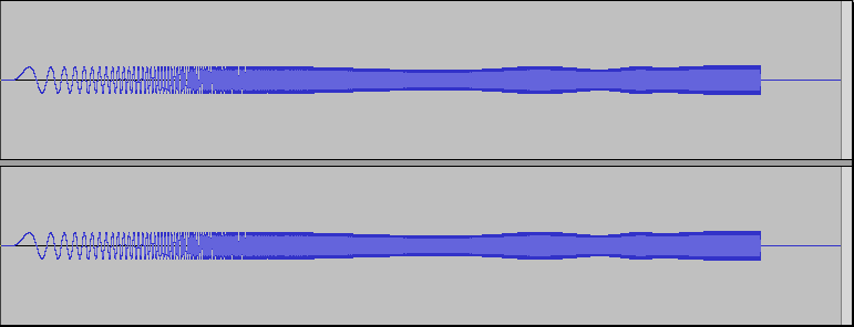

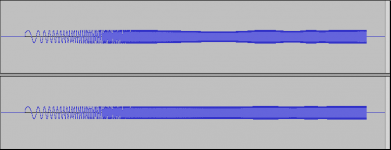

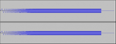

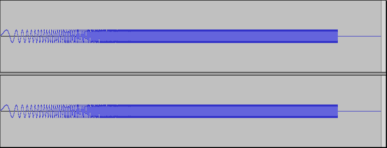

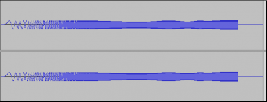

From above work find Audacity views below for exported 16bit REW measurement sweap without filter, then comes fabfilter and last one is my homebrew filter.
Looks like your 1st method was a good one, byrtt. Quite similar between FabFilter and homebrew!
Fluid, I understand my room and my setup are completely different. I will continue playing with your preset. I said I preferred without, but that doesn't mean I'll stop tweaking! This is DIY after all! 🙂

Reading a 16bit perfect impuls with REW that has been through JRiver without filters and with fabfilter looks as it should but I have to debug later why there is no IR in written file when convolution engine is used : )
The IR you play trough JRiver and record, open it in an audio program and ad a second of silence to the start and end and try again. Convolution might move it out of the recorded window.

Strange, as the side info (responsible for the room queues) is not changed in this processing. Did you start with a straightened or corrected IR?
You might want to experiment with a reversed filter. Where the mid part stays linear and the sides get treated. Or maybe even out the differences between mid and side. As long as the relations in level between mid and side stay. Do play with bringing up the level/gain of the sides to + 0.5 dB.
I think it was a measurement sweep he played rather than a Dirac Pulse, without the reverse filter the IR doesn't get recovered from the sweep when done that way like it does in REW.
Thanks tip wesayso, i tried different time frame added but it only adds grass which actually is different because without there is no IR inside written disk-file, case is only for diskwriter combined convolution engine, when using IIR filter containers or fabfilter combined diskwriter works fine, will revert to god old loopback of soundcards digital I/O and use JRiver WDM-driver in loop.
How irritating !!! to get a break will go out eating for a wile and come back ...🙂
BTW what you fluid/wesayso call a Dirac pulse is that the same as a perfect syntetic IR created in Rephase ?
Yes, a Dirac pulse is a perfect IR as created in RePhase. I've had it happen to me, the case you describe here. Never did find out why. I can run them now, including the whole chain and even the convolver, but there have been glitches like this for me too. Very frustrating...

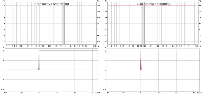

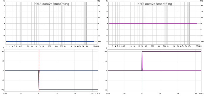

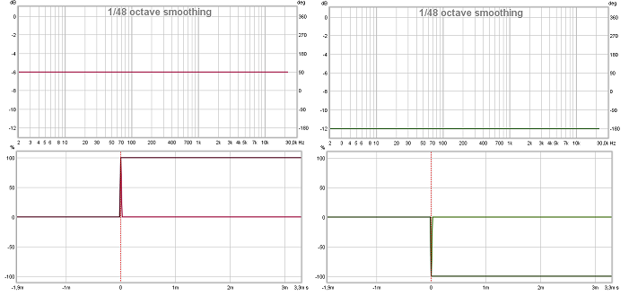

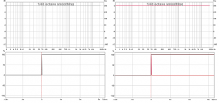

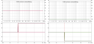

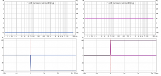

Had also some fun Benchmark JRivers M/S en/decoding filters.
Encoding L_CH -12dB plus phase inverts and Encoding for R_CH -6dB:
attachment.php
Decoding L_CH -6dB and Decoding R_CH -12dB plus phase inverts:
attachment.php
SUM of chained JRiver M/S en/decoding L_CH / R_CH:
attachment.php

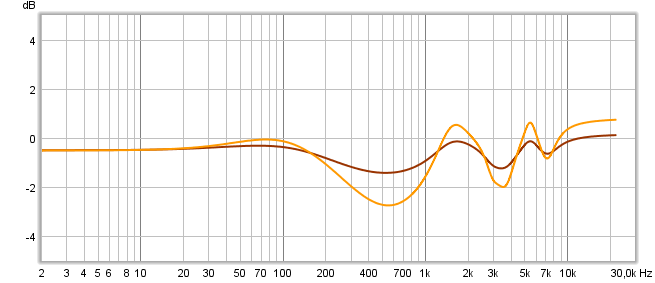

Looks like your filter was about double from that graph.
I'm not sure I understand the other graphs, are you trying to show that a pulse that is different in phase and level in either channel comes out the same when encoded and then decoded by the Jriver Mid Side process?
i.e. The Jriver Mid Side is working as it should and not doing anything to the signal?
It's no surprise really that it doesn't improve the sound for you but your descriptions are interesting I shall have to listen for that. Interesting that you found minimum phase to be better as it destroys the effect entirely for me. Thanks for taking the time.
Did you try to alter the relative level of Mid side with the pan control in FabFilter to see what effect that had?
Try those drum samples I sent you before, the dry studio at 6 feet is about as close to an unmolested drum kit recording as you will find. To me it sounds as close to a real kit in a room as I have heard. If you don't have them I can send the link again.
Orange is actual my convolution filter benchmarked but its set as in post 790 and actual fabfilter is set same but outcome when benchmarked is only in half, as example numbers for cut filter at 600Hz is -3dB which is same as orange where brown fabfilter is in half. Must be the complicated matrix of L_CH and R_CH from encoding to decoding that make it sum that way, and over my head to figure that out : )
Yeah at least it looks signal come harmless thru Jriver M/S en/decoding, what happens inside guess is supposed to be following schemes explained from gearslutz:
ENCODING: The left and right channels of a stereo recording are encoded to Mid and Side.
M = L + R
S = L - R
DECODING
LEFT = M + S = (L + R) + (L - R) = 2L
RIGHT = M - S = (L + R) - (L + R) = 2R

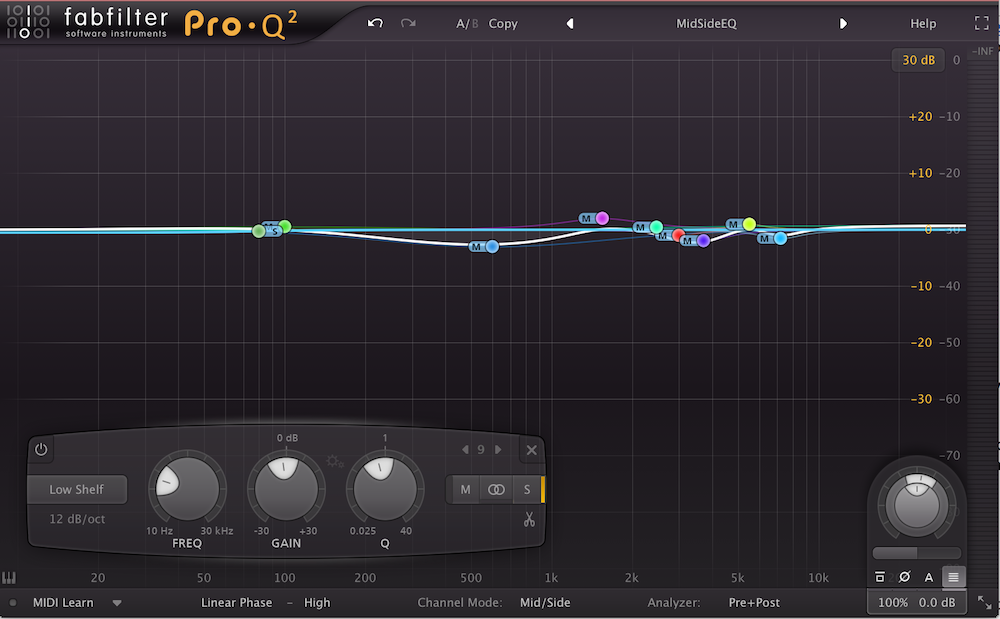

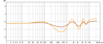

From a post in the Beyond the Ariel thread, I'm posting some details of the Mid Side EQ than I have been using. Wesayso has posted the specifics before and these are the settings he used.
I concur with wesayso that the EQ needs to be linear phase to sound "right". And the difference between linear and minimum phase EQ is not subtle in this application.
Mid Channel
100Hz Q 0.5 Gain 0.5
600Hz Q 0.5 Gain -3.0
1550Hz Q 1.5 Gain 2.0
3000Hz Q 3.5 Gain -1.0
3700Hz Q 2.7 Gain -2.0
5500Hz Q 4.0 Gain 1.0
7200Hz Q 3.0 Gain -1.5
High Shelf 2470Hz Q 0.5 Gain 0.8
Side Channel
Low Shelf 80Hz Q 0.70 Gain -0,5
This is what it looks like in the plugin
635963d1505718428-range-tc9-line-array-cnc-cabinet-screen-shot-2017-08-26-4-59-32-pm-png
Wesayso boosts the sides by 0.5dB, I can't make up my mind but I have settled for cutting the sides by 1dB for now.
The more the sides are boosted the wider the stage becomes, I find that a bit weird and make it more mono by cutting the sides a little. That is the part that can be a bit track dependent as to the setting I prefer more.
There are a few plugins that can do this sort of EQ.
I am using FabFilter in MidSide mode and anyone that has that plugin can PM me to get a preset to save themselves the bother of inputing the EQ parameters.
IIEQPro can do it and Voxengo Ozone. Equilibre is free but only has 4 bands of Parametric EQ which isn't enough for all those listed above.
Voxengo MSED can do the encoding and decoding but would need to be used in a host program that can chain plugins.
Metaplugin can be used in Jriver to allow multiple plugins to be routed any which way but is not free but does include a mid side plugin.
If there is any interest I can try and make an impulse in Jriver that could be used in a convolution plugin or try and make a comparison track for people to test for themselves if they don't have the correct plugins.

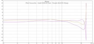

Hi fluid,

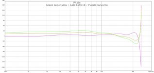

Think it could make sense you would choose the short sharp filter which is minimum phase, cause is after have bench I/O on UMC204HD at 44,1kHz which has very same replica IR to yours Focusrite

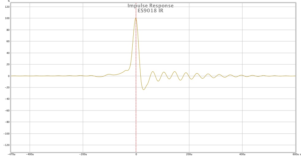

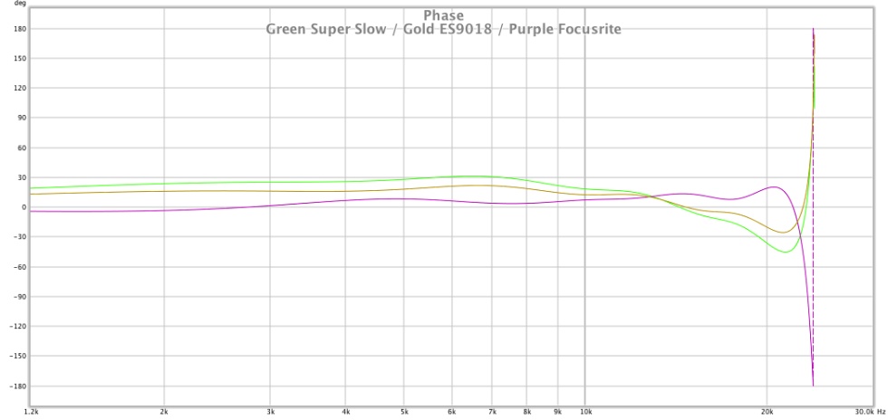

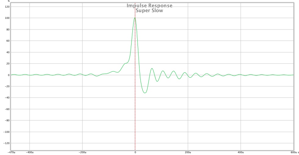

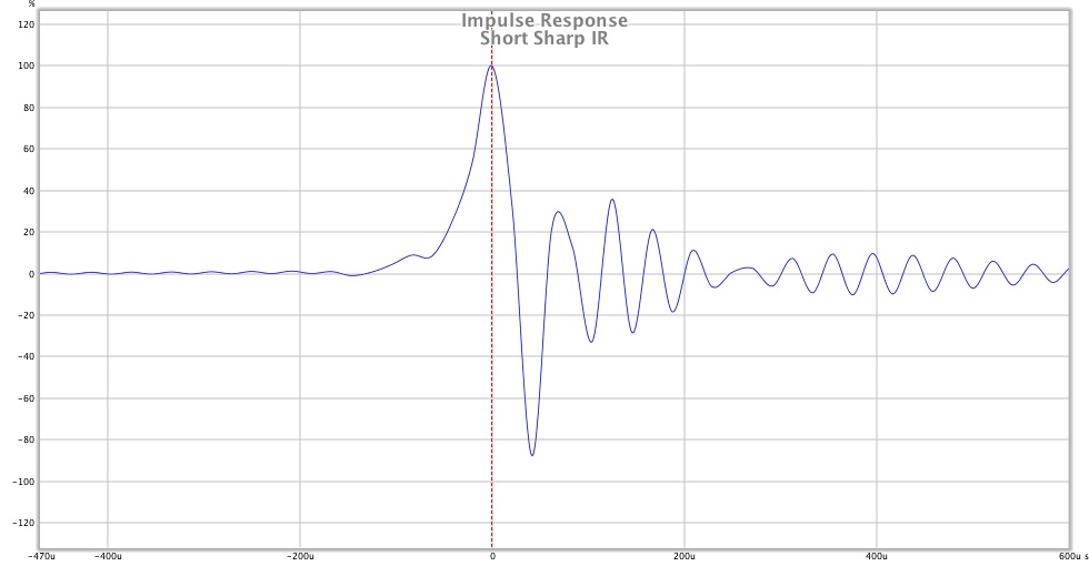

Could be, although the Short Sharp has considerably more post ringing and is quite 'wild' as an Impulse response 🙂 It isn't an apodizing filter like in that Ayres paper in that it actually has a slightly higher corner frequency than the Sabre or the Focusrite.
attachment.php
The Super Slow Filter and the Sabre Fast Filter are somewhat similar overall and the most well behaved in the impulse response.
attachment.php
attachment.php

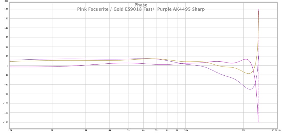

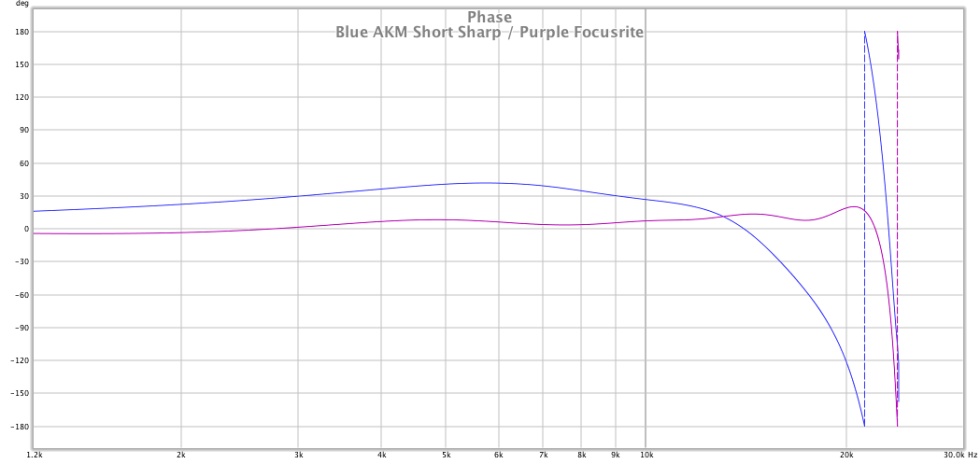

There are some phase differences
attachment.php
The minimum phase filter having the most obvious change
attachment.php
The Super Slow being the closest in shape to the Sabre
attachment.php
As far as I remember the Focusrite sounded a little better than the Sabre but it is hard to know if that was familiarity or because it had been "corrected" as it was in the loop when the measurements were taken.
I have tried before to divide out the signature of the Focusrite from the measurements to use the correction with other DAC's and overall it was not successful. There was either no real change or it sounded a bit weird on some vocals. The only thing it was useful for was when I used it to generate the measurement I based a rephase tweak on, that was only below 100Hz and got the generated minimum phase to line up better below 20Hz. It wasn't the only thing I changed so hard to say if it made any real difference other than making the graph look better.
Maybe at some point I can take some measurements with different devices in the chain and generate corrections based on those to see if there is any change. I am getting a bit tired of "tweaking" for now and also getting short of time.
The effort I have put in has got me some pretty good sound so I can enjoy that for now 🙂
