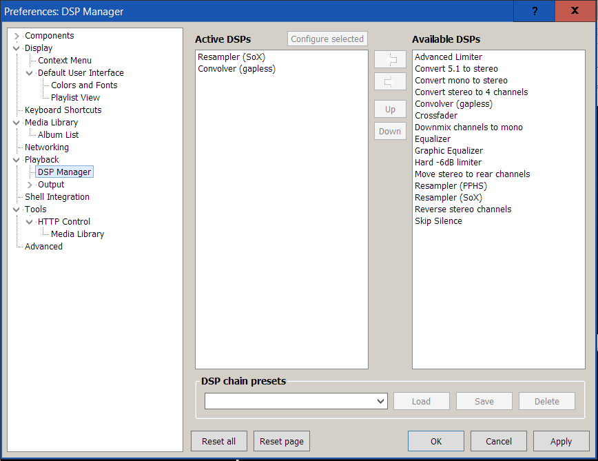

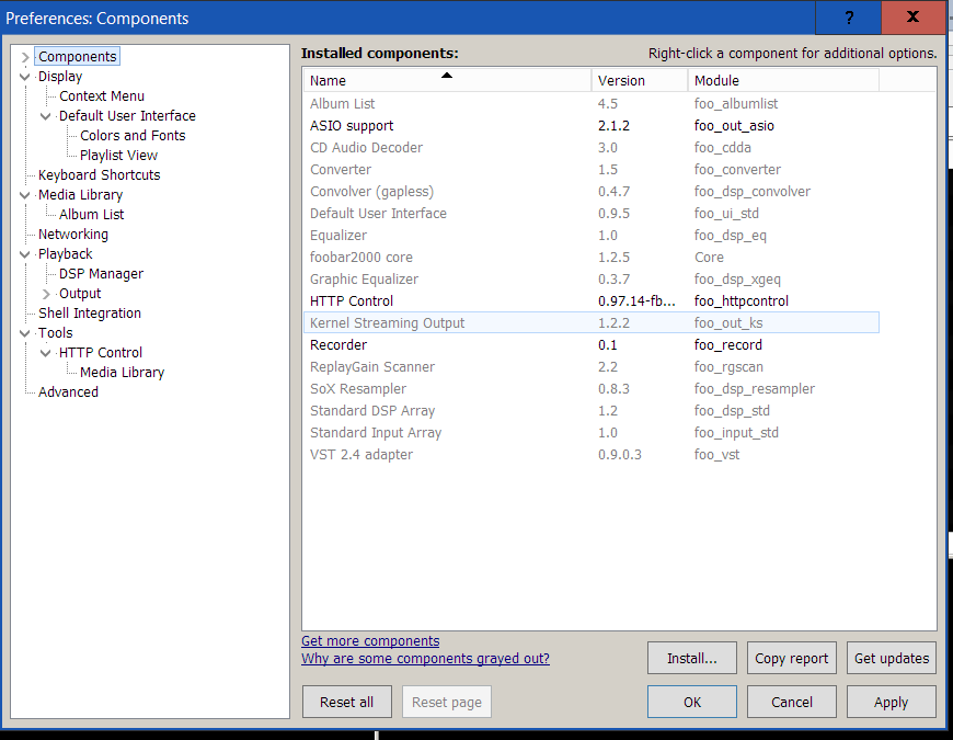

I followed the dawlab.net instructions:
I did download the foobar VST 2.4 adapter and dropped it in foobar components.
It shows up just fine in the "installed Components" in foobar preferences, but do NOT show up in DSP manager as available DSP´s...
wesayso:
None of the two equalizers installed in foobar and available in DSP manager can load the Fabfilter presets...

But this is exactly what isen´t there...In the DSP manager preferences there should be Components then under that VSTPlugins

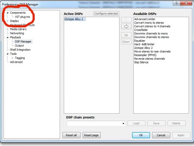

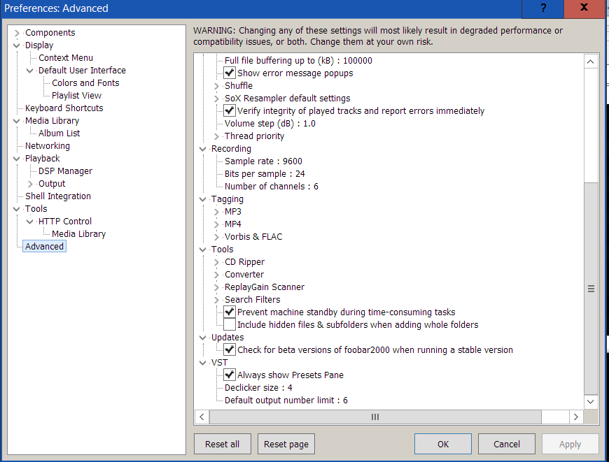

Look at these three screenshots:
You can't click on the > Arrow in front of components to un-hide the VST plugin app?
It is shown as a right pointing arrow before the Components text: >
While in the video, to load VST plugins it's pointing downwards...
Duuhh-............
There it was.
Thanks wesayso and Fluid.
Now I have it installed, all I need now is time to evaluate it.
