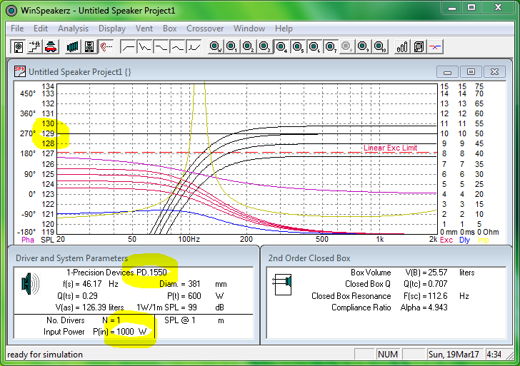

600/800/1000/1200 watts into 1x PD.1550, now take 2x PD.1550 to have same area as 50x TC9
Max 123dB single = 126dB for pair at full XMax
Thanks Brytt,
My guess was not bad... 123dB at XMax for a single driver, or 126dB for a pair.
The PD 1550
PD.1550
is a great value driver, but no longer state of the art... PD have higher output lower distortion drivers available that will go about 3dB to 4dB louder with lower distortion..... But they cost double what the 1550 retails for.
Assuming you have an accurate set of measurements or are working with a trusted manufacturer (Precision Devices are very honest) a good guide to a drivers true output capability is:
Average the SPL over the bandwidth you are intending to use the driver and multiply up the 1 watt graph until you get to max AES power handling.
Using the attached 1550 graph that might be 80Hz to 500Hz.
Average SPL over that band is approx. 96dB or 97dB at a quick guess.
So 1 watt = 97dB
2 watt = 100dB
4 watt= 103dB
8 watt = 106dB
16 watt = 109dB
32 watt = 112dB
64 watt = 115dB
128 watt = 118dB
256 watt = 121dB
500 watt = 124dB
600 watt = 124.5dB .... This is the Max AES continuous power handling limit including the quoted manufactures spec of 2.7 dB power compression ie the drivers true MAX SPL at 600 watts = 121.8dB... Way lower than any Sim will suggest....
Running the driver into extreme power compression.... Gives a distorted :
1,000 = 127dB
2,000 watt =130dB
Hope this helps clarify the difference between Sims and real world results...My best sims are mdf test box and measure....

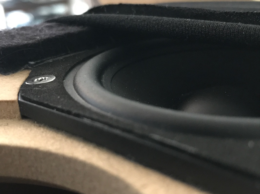

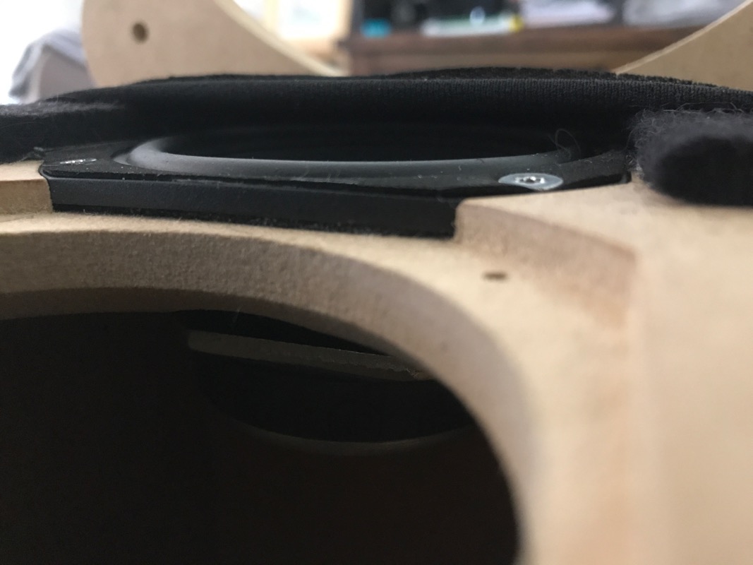

Thanks for the input guys, this quote tells me loud enough and low enough for music.

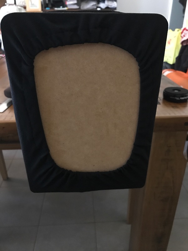

Just for wesayso here is a couple of shots to show that there is plenty of room for excursion under fabric, difficult to take a picture of but I think you get the idea.
Test sock on bottom with test base attached
Elastic for the top to put some tension on the fabric

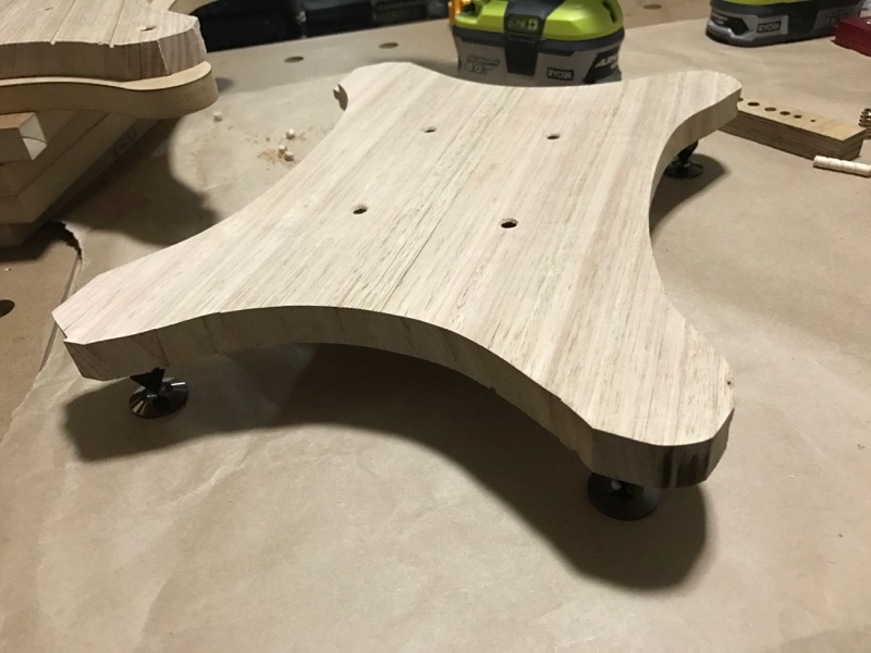

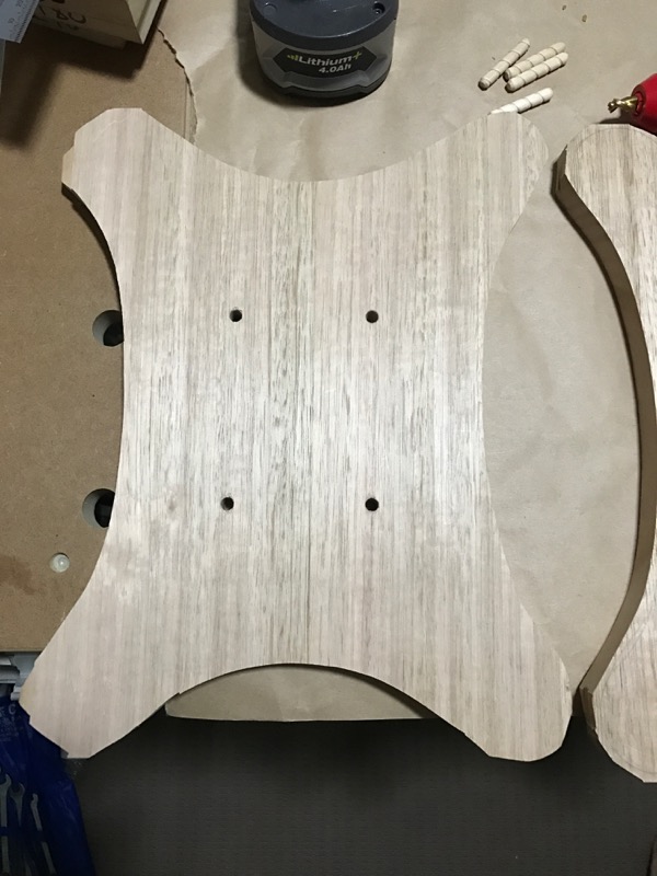

Hardwood base blanks roughed out ready for flush routing

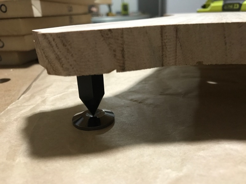

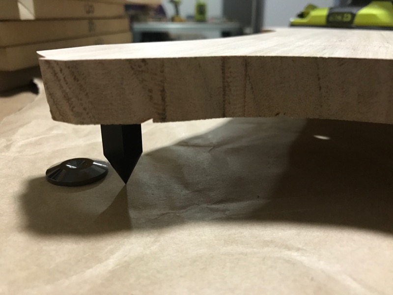

Unfinished bases with the spikes mounted, with and without the pads for hard surfaces.

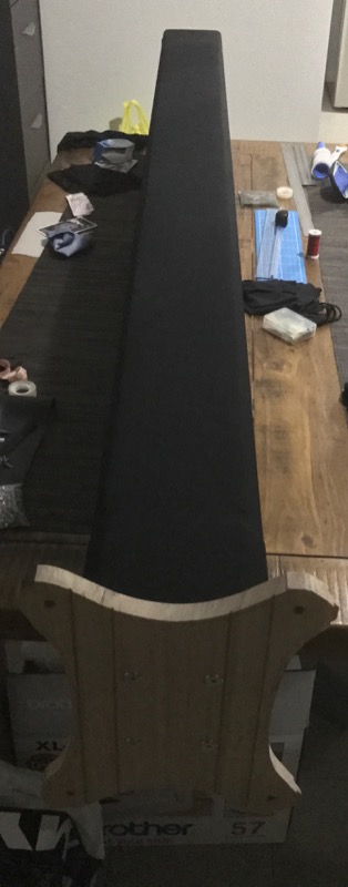

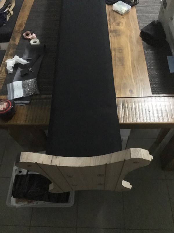

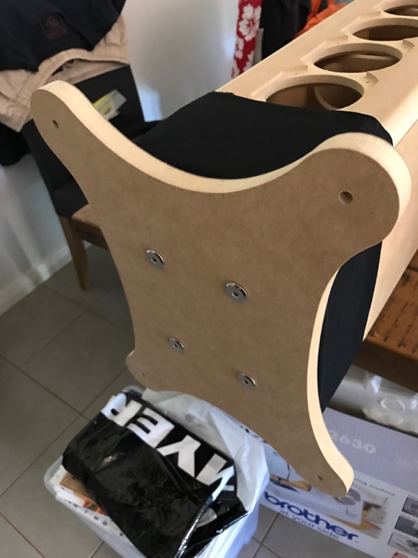

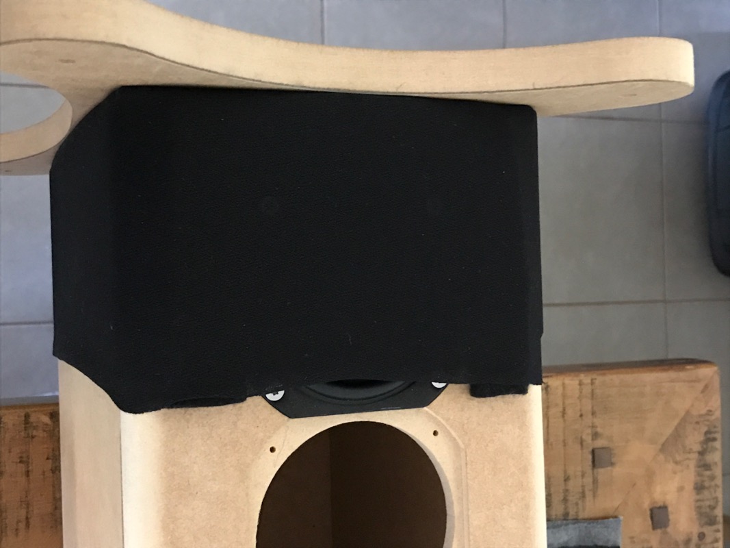

I couldn't resist to take some pictures of the full sock over the cabinet with the wooden base. Terrible pictures due to no natural light but I think it conveys what they will look like when finished.
Monoliths!
So cool!![]()
Good going fluid!![]()
Thanks!
Looking great fluid! I have to say, you build super fast! I haven't seen a whole speaker covered by a fabric sock before, but I have to say that it looks good!
