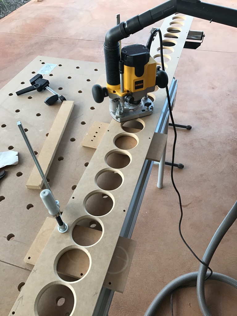

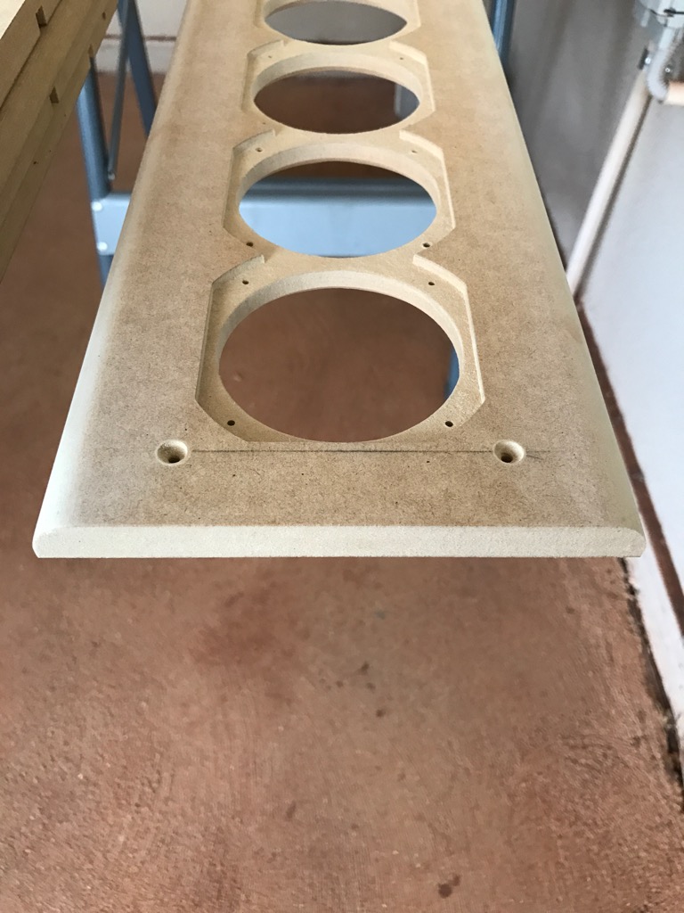

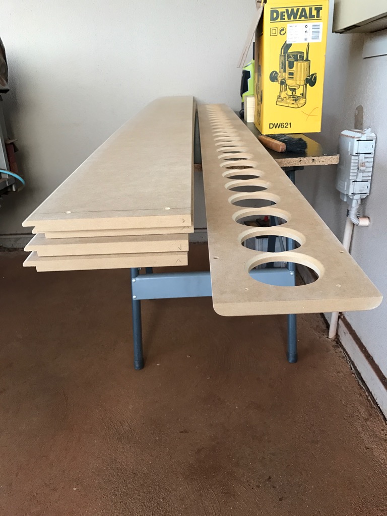

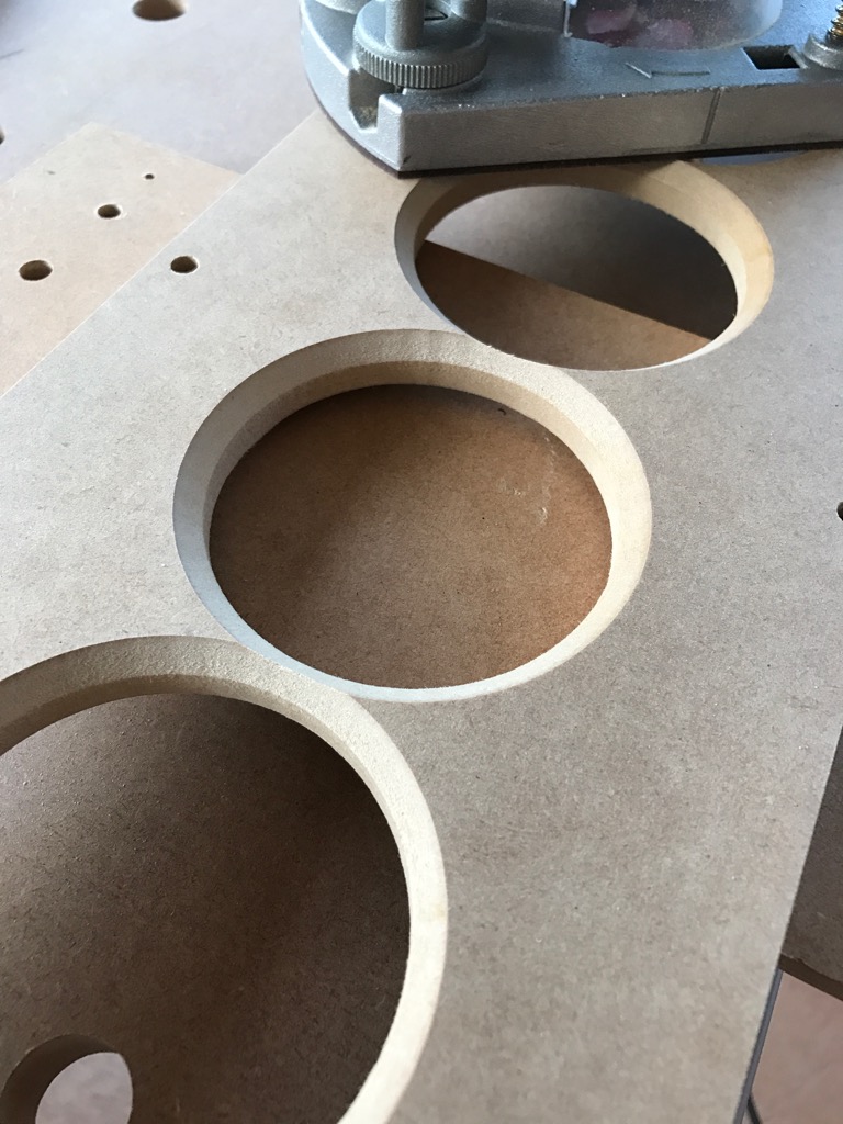

More progress today, routing of the edges and driver recesses completed.
The Dewalt 621 is a really good router for hand held work, has a lot of adjustability and power but is still small enough to move around easily. Pretty good dust collection too.
attachment.php
attachment.php
1/4" roundover for the back side to avoid losing any strength in the dado housing joint.
attachment.php
With a little bit of sanding the 1/2" roundover matched the 16mm MDF quite well.
attachment.php

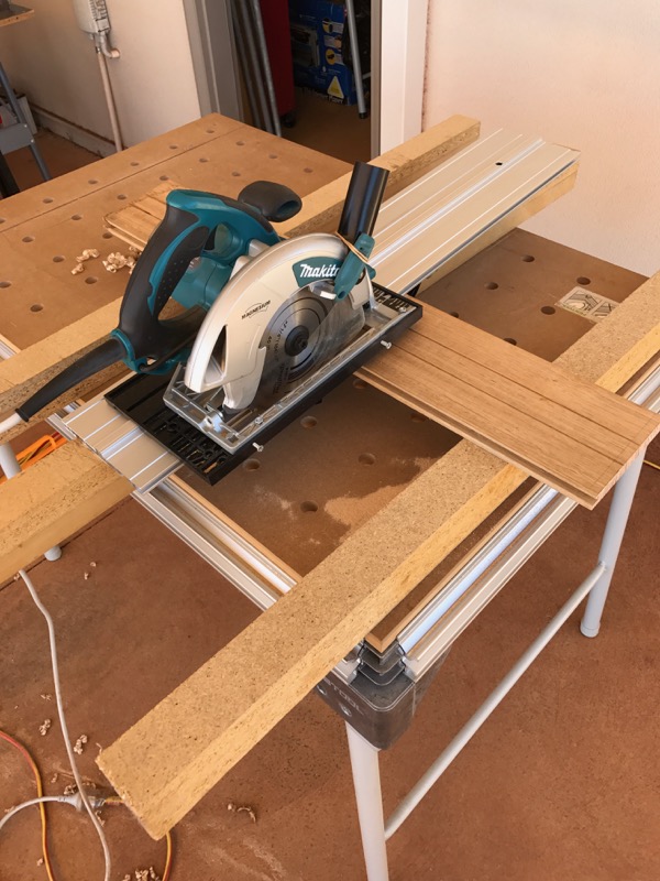

Cutting the oak boards to make the bases, I use this setup for cuts where the dimensions aren't critical
attachment.php
Still produces a nice cut though

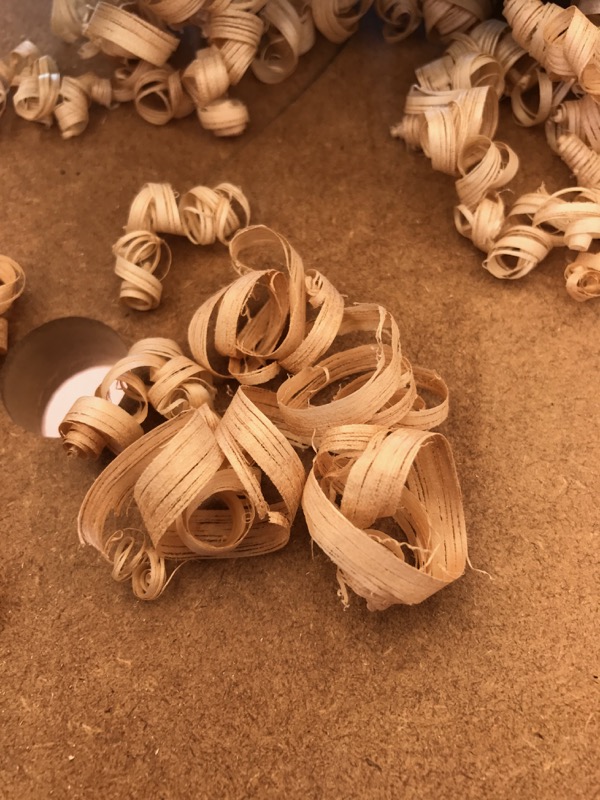

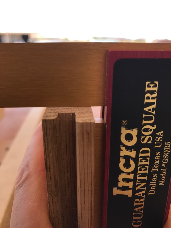

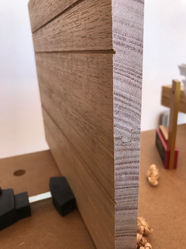

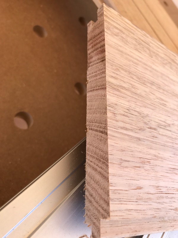

The tongue and groove edges didn't fit as well as I had hoped straight from the board
attachment.php

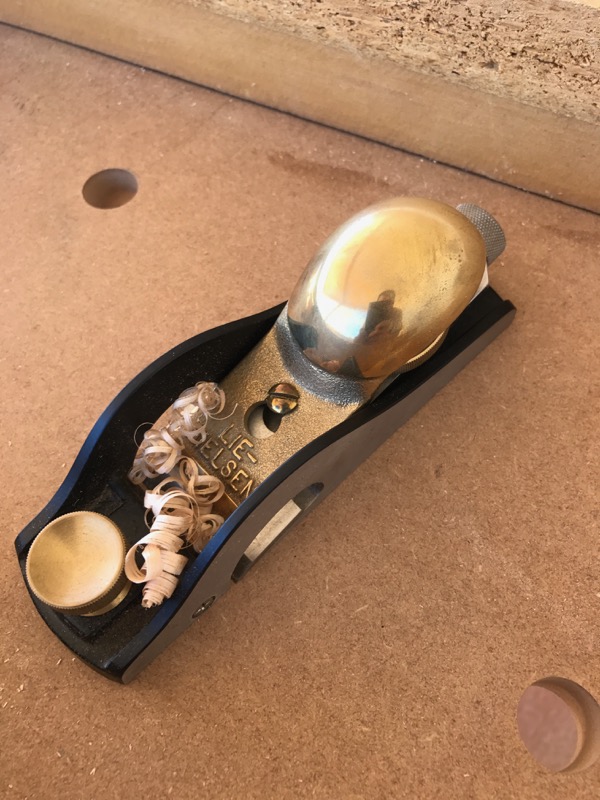

Lie Nielsen to the rescue
attachment.php
Now the edges are much better
attachment.php
I love using a hand plane, so much better taking shavings than making dust!
attachment.php

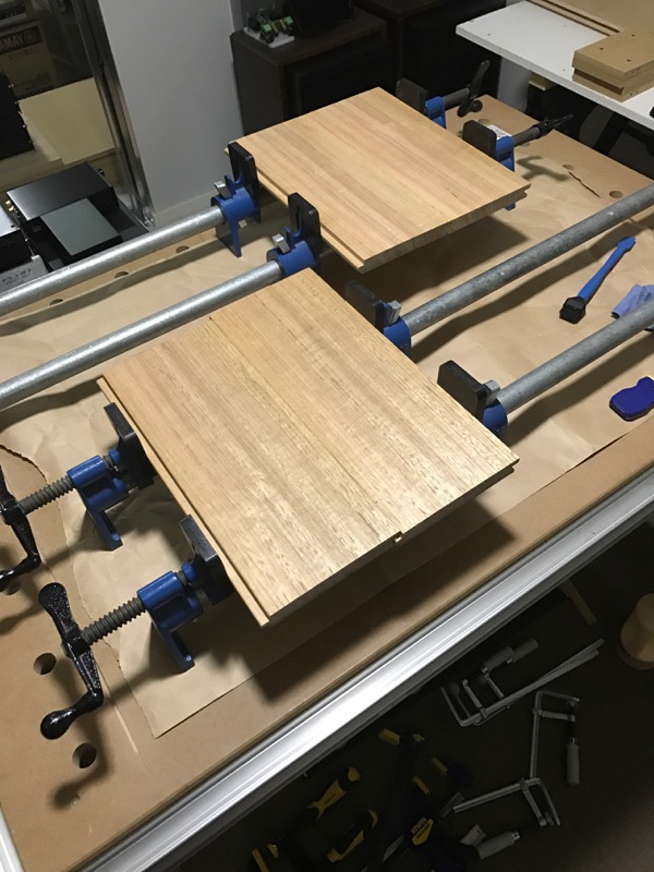

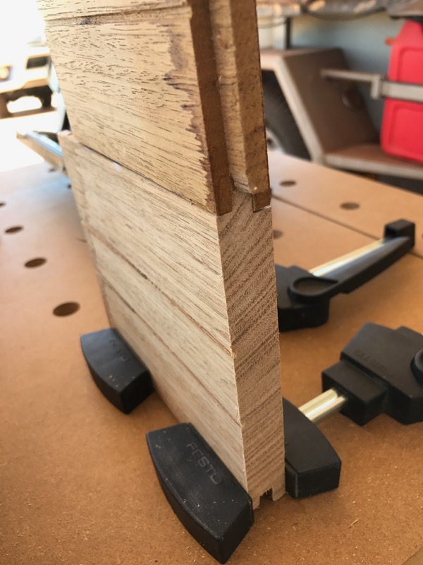

Gluing up the blanks
attachment.php

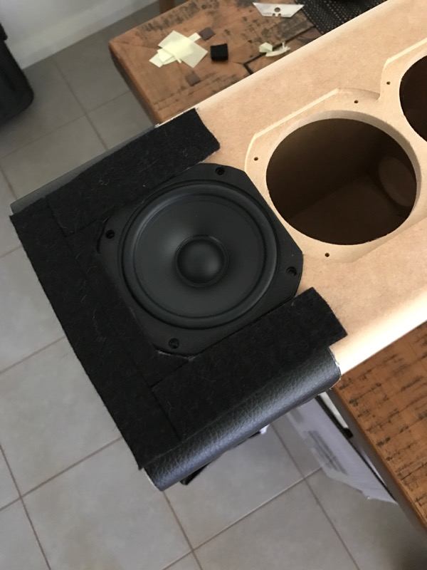

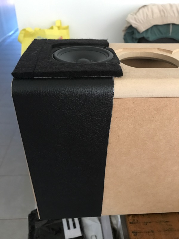

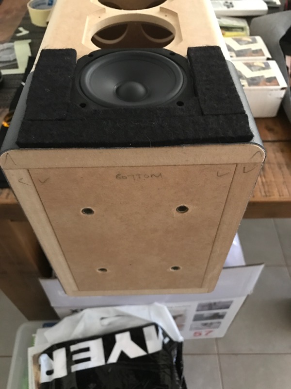

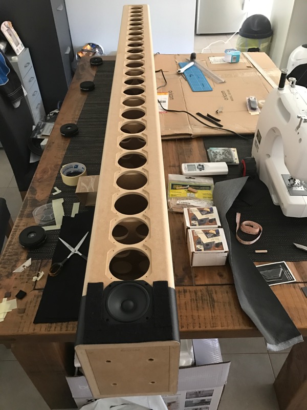

A fabric sock goes over this all? With at least enough wiggle room for the surround to move?
Yes, in these pictures the driver is just placed in with a bit of foam tape underneath so it will be a few mm lower when fixed. The felt is 4.8mm thick so there should be more than enough room for the excursion of the driver. I can always add a little more if needed.
I like the vinyl you used. That might be an idea for my Sub build too.
It is actually very nice and is the most leather like I could find. The material is quite thin so it is good for this application. The edging can be a bit tricky but you should be able to hide it in your shadow gap. You could stretch it over your baffle roundover and it should be OK for the rebated driver too. In the test it was stuck down with double sided tape but I will use PVA rolled on both surfaces and left to dry then using an iron to re-set the bond. Same technique works well with veneer.
