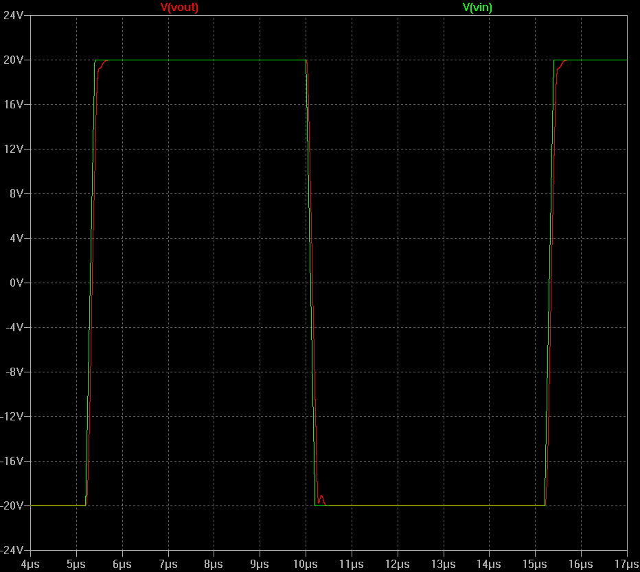

Nice comparison. Never thought the difference is so significant (especially in terms of thermal stability)...

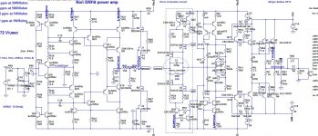

Gentlemen, couple of questions (I started drawing the IPS schematic in DipTrace for further layout development).
Do we need the pot at the input (P4)?
Do we need the CCSs' pot (P2), assuming we were going to use DC servo?

Valery, input pot is there if you want to use this amp without preamplifier, so it is up to you.
For P2 you can put provision for both, the trimmer pot and a resistor in series with the pot and decide later during the test if we need it.

OK, good, I will reserve the plug for P4 and do both options for P2.
With regards to the servo, I would use a straightforward approach and connect it to the input via some 100K resistor - small enough influence on input impedance and enough current to control DC offset...

The internal speed of the power amplifier is 400 V/us . The SR is limited by the input filter.

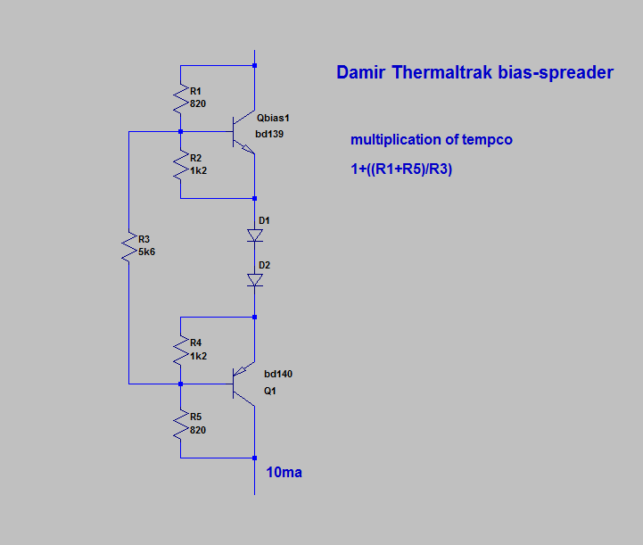

I have test your bias-spreader today and it worked very well, 2 diodes is enough to thermal compensate the output stage. using the 4 diodes can cause overcompensation.
It is only need to use two thermaltrak transistors (NJL3281D/NJL1302D) the other pair can be a (MJL3281A/MJL1302A) as it is the same transistor, but without the sense diode, and it costs half the price. of-course it can be use 4 thermaltrak transistors but one pair will have the diodes without use.
this is a image of the bias spreader. R1,R3,R5 have to be static resistors, R2 and R5 can be in serie with trim-pots to set the output Bias current.
With the values in the picture the tempco is 4,35mv/cº for compensation of the output transistors.
The two transistors will have to share a heat-sink with the prédriver and driver transistor for better thermal compensation.

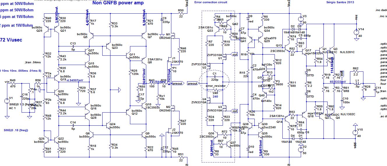

This is the circuit I have been testing, I will start to make a test pcb with it for evoluate the concept and test other ideas that I have.
This circuit as is, does not have any protection circuit yet
R31/28 are Trimming potentiometers for setting the bias, r32 is a Trimming potentiometers for fine calibration of the distortion cancellation.
The decoupling caps should be close to the respective transistors especially those 220nf ones that should also have low Inductance (ESL).
what would you like to be include or modified ?
PS: spotted already an error
R13 and R26 need to have lower value (1K)

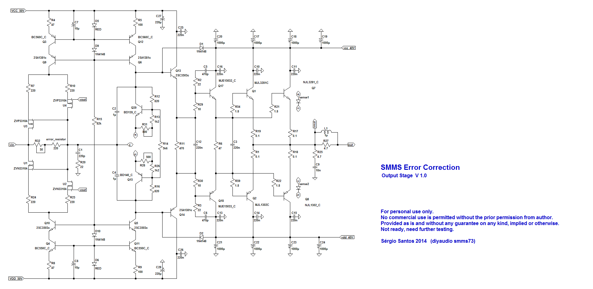

Hi Sergio,
I'd like to discuss one point, related to bias setting approach.
As the spreader here is not "2-sided" (in this case it would not matter if it is symmetric or not), but 3-sided (with central connection on the left and requirement for its shoulders - top and bottom - being balanced), it will be very difficult (if not impossible) to adjust the bias and keep the spreader balanced at the same time with 2 trimmers (R31/28) as shown. See what I mean?
I would leave one of this trimmers for balancing the shoulders, and put the second one in series with R14 for adjusting the bias symmetrically. I understand - adjusting R14 also influences multiplication factor, but adjustment required (and though influence on multiplication) is going to be rather low.

Good morning Valery.
I think that a few mv of difference between the upper part from the lower part do not make any difference as the servo will compensate that. It only make sense to use two trimmers in a test pcb. Then one see what Is the value of the needed resistor, in a final pcb only one trimmer is need for bias adjust , R31 can be a fixed resistor. I think that is also better to leave the multiplication factor fixed.

I'm just not sure how critical it is for error correction circuit, if the spreader shoulders are slightly unbalanced. If not critical - then no problem, I agree.
