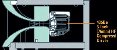

I'm just trying to noodle the optimum WG throat to match with a "throatless" compression driver having this internal construction. Suggestions?
Hi
Here is what JBL uses in the S9800 to match the compression driver's mouth in the vertical plan (the 435Be driver layout is identical to the 2435)
