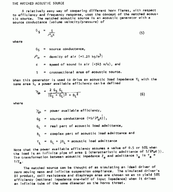

I basically did what Earl said he would do in post 2469.
There is btw no EQ applied to the plots. See attachment for details on the "matched source" concept, from AES preprint 1038, "What's so sacred about exponential horns", by Keele.
Bjørn

Hi Bjorn,
Unequalized plot of a guide/horn of uniform beam over a frequency range would look something like this. Note that without equalization, the SPL will drop with frequency increase, and this is consistent with my measurements. Your plots in post #2540 of the OS wave guide do not show this, and therefore the results are equalized specifically for the OS wave guide.
Now, in the LeCleach horns, due to the fact that the beam is not a uniform pattern over the frequency range, the on-axis response would have pretty much the same SPL. But in your graph, it shows a rise is SPL on axis with the increase of frequency. It seems that the results were equalized using the same high pass filter as used in the OS wave guide.
I beleive a sanity check would be to just measure any horn/guide and compare the results. They should have a similar trend as in the graphs you show.

Seems like yet another post is required 🙂
Yes, since here the driver mass rolloff comes in, and the SPL will drop with frequency.
Did you read the explanation of the "Matched Source" concept? The matched source behaves like a driver with zero mass and infinite compliance.
So no EQ is applied in the polar maps (and certainly not EQ specifically designed for the OS), but the effect of driver mass rolloff is removed. In other words, no highpass filter is added, but a lowpass filter is removed.
Bjørn
