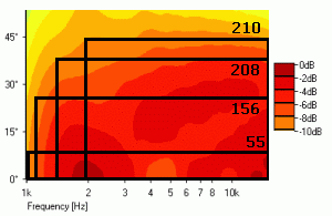

Hello Soongsc,
with the help of Bjørn Kolbrek' polar map for the OS waveguide I'll try to give my definition of constant directivity.
First we have to define an attenuation level that should correspond to the limit of the area of the polar inside which the waveguide can be considered as CD. Not easy but you can by example take a value a bit lower than the min relative level recorded on axis on the polar (see attached graph): here the min is -8dB so let's take -10dB.
The question now is how to define the angle range and the frequency range inside which the CD equalized can be defined as CD at -10dB.
We can draw several rectangles inside which the polar doesn't fall below -10dB. For the purpose I traced 4 rectangles. For each of those rectangles we can say "the OS waveguide is CD at -10dB within such frequency range (the width of the rectangle) and such angle (the height that due to symetry along the axis we can have multiplied by 2)". In every 4 rectangles I traced the OS waveguide is CD at -10dB. Now which one should be used in order to be eventually a reference for further comparions.
A solution that's seems correct to me is to take the rectangle having the max area. The area is given (in undefined area units ) by the numbers in black. Here the rectangle having the maximum area is the one having an area of 210 area units.
With that definition one can says that the figured OS waveguide is CD at -10dB between 2kHz and 20kHz and from -45° to 45°.
That's another story if one defines the CD at -6 dB...
For what it's worth... ;-)
Best regards from Paris, France
Jean-Michel Le Cléac'h
