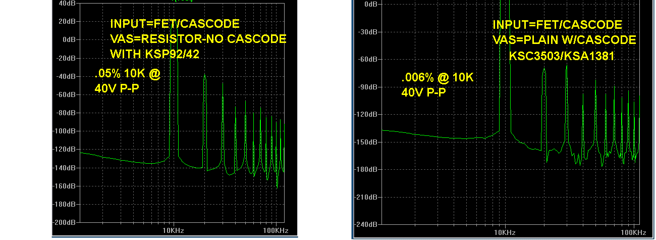

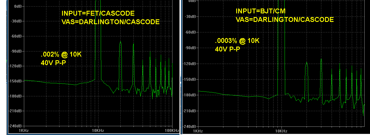

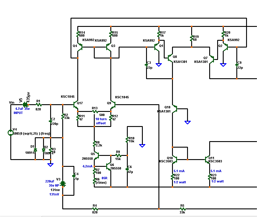

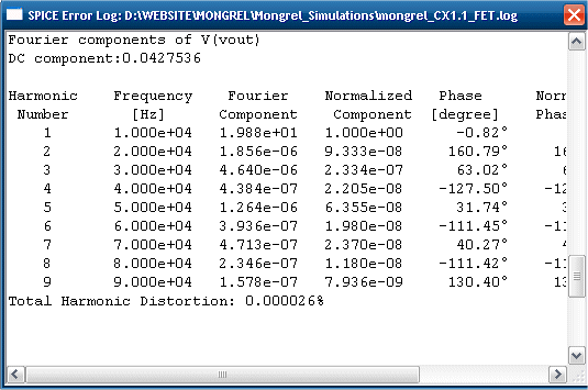

(pix2) is with Nico's mods (different amp, essentially) and the figures get wild (real low) I actually pulled off .0005%- 20khz at over 100v p-p with the circuit in (PIX3)... a new record at that level. :eek: It has 120v/us symmetrical slew ...fast as hell. ( PIX 3/4) is the circuit and crazy THD@ 10K- "normal levels". With a Jfet input and cascode it performs almost as well.
Definitely a "strait vanilla" amp ... 26 PPM/10K even !!
When I make the board ,A "3 in one" universal voltage board (jumpers - extra pads) will be the way, allowing for any and all mods shown above. Then one can hear these plots for real. :)

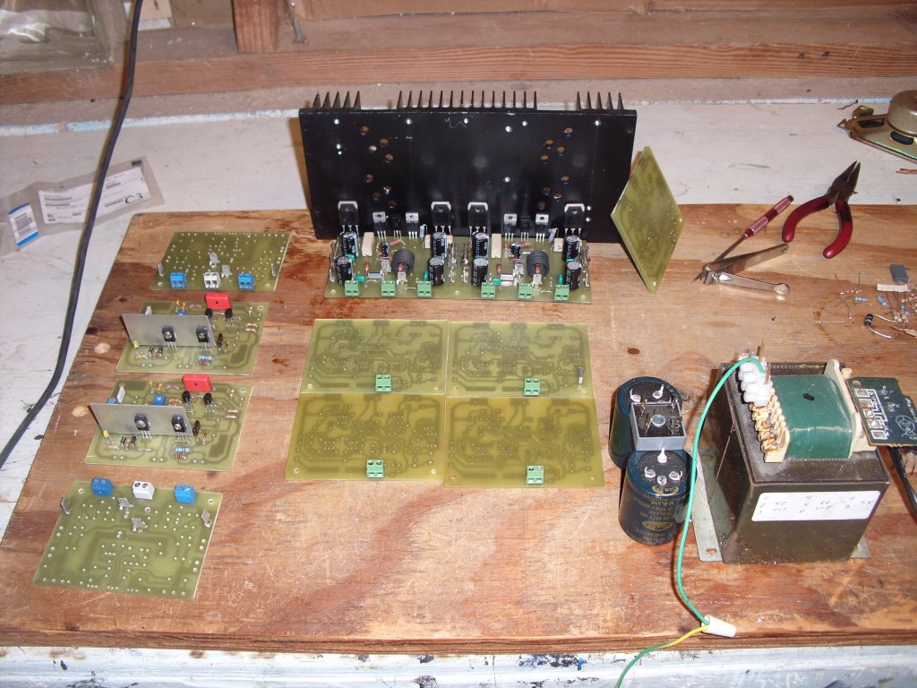

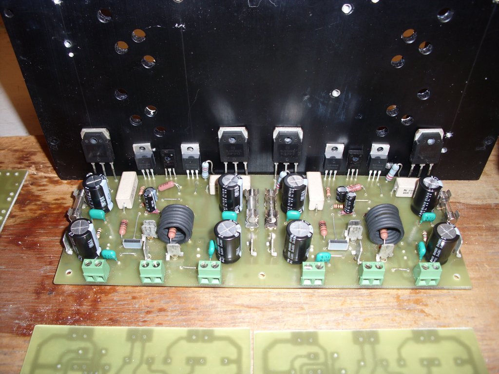

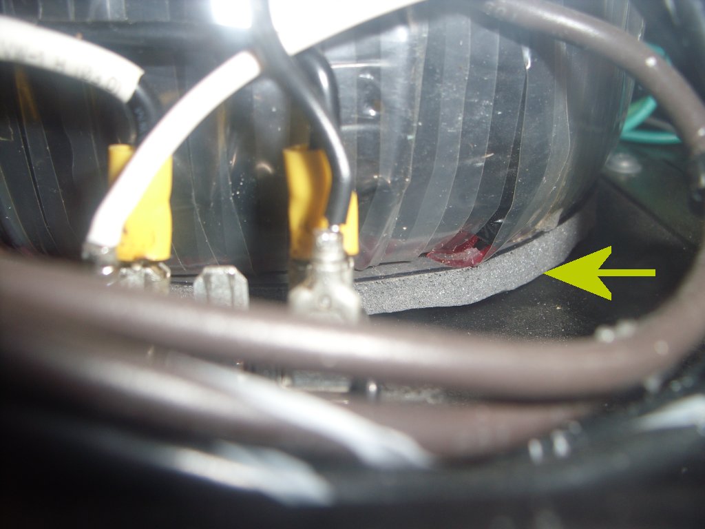

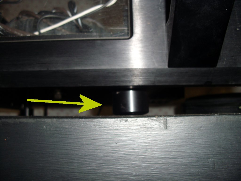

First 2 pictures show that I do not consider microphonics as audiophile "puffery". I have had my high gain "blameless" actually exhibit this while the input stage was tapped with a screwdriver. With this amp, placing it on a speaker un- isolated had a detrimental effect on the resulting sound. The isolation feet on the Genesis case plus the foam on the toroid totally cancelled out this "effect" when I tested at 200W+ with the room "a shakin' " :D
On my initial test bed (pix 3/4) ,I will even consider a neoprene mat to isolate my creations from the environment. I have 2 trafo's to separate the rails(voltage stage/ power stage) in my R and D setup (pix4) and will make a mini version of Nico's regulated PSU to fire up the voltage boards. If only I had some laterals , I could go "all the way". :)
