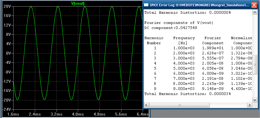

We are looking at 2nd harmonic at -158dB(v), that I would say is vanilla^2, it is probably 20dB below the noisefloor - how on earth did you manage that?
The next qualifying stage for an engineer is that of magician.![]()
I am astounded , a simple amp that is PPM , my LT is not rigged... run it. It does quite well for THD20 as well.
Edit: consider this is the input/VAS in isolation as well.

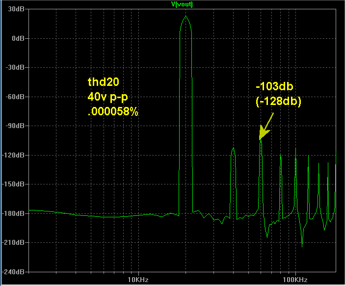

Is this the performance of the full amp?
What bias are you running at?
My only advice here, is increase the bias to around 700mA and watch the higher order harmonics be transported to another dimension.

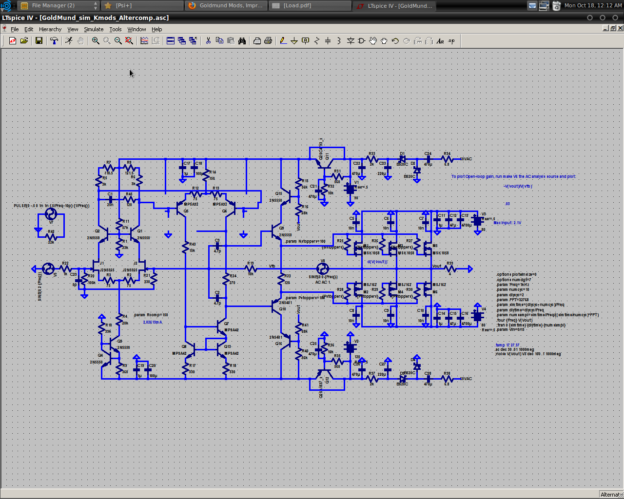

Which schematic is this?
Yeah Nagys
download this , Linear Technology - LTspice IV Downloads and Updates
, run my last .zip file attachment (post #284) in a folder.

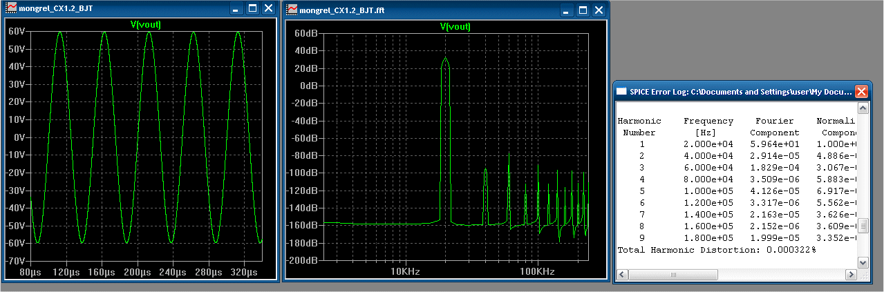

The FET input version does almost as well.
With my NJW BJT's biased at 80mA each.
.001% 120v p-p THD20
.0004% 40v p-p THD20
145ppm 120v p-p 1k
37ppm 40v p-p 1k
Just hook feedback back to main OPS , Move "Vout" there ,too.
Adjust "R38" (rbias) to 125R = 81mA.
I would assume laterals would perform as well , depending on the virtue of their models.

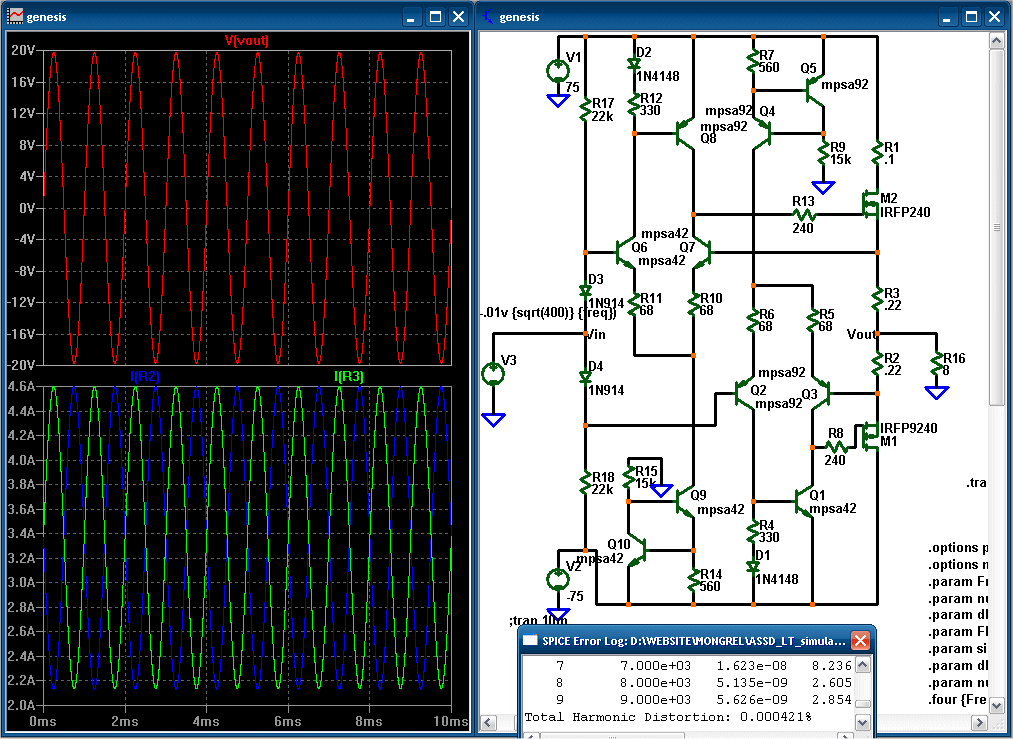

genesis , the $8000 "zero THD amp"
I did have the pleasure of listening for an extended period the mighty genesis stealth 200W class A. It did leave a "benchmark" in my head as well as allowing me to reverse engineer it's IRF power stage(below). At 4A class A dissipation per IRF240/9240 pair , it was the most fatigue free listening experience I have been exposed to. Upon investigating it with simulations , I found it to have distortions in the hundreds of PPM (.0003% or less). The voltage stage was a balanced VAS fed to a jensen 1:1 audio transformer.
So I have heard a VERY low distortion audiophile amp without the image being "swamped out" by H2/3. The soundstage and detail was exquisite , almost surreal ...... and this came from a amp with -110db second harmonic content. The Class A OPS could have me fooled with it's absence of crossover distortion but this too can be seen while simulating a typical BJT output stage. Underbias a BJT pair and the H3 will shoot "high to the sky".
