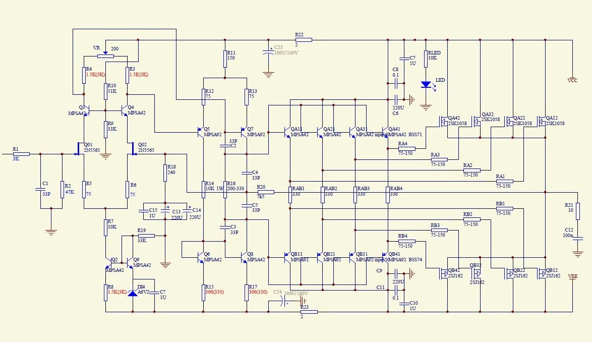

My adaptation ,a beta enhanced VAS w/ current mirror has not been as thoroughly explored at DIYA. Nico and ampslab have first "dibs" on this , so we know it works. Why not "vanilla" , add your tube preamp or DSP and have a transparent reproduction of the soft clipping attributes enjoyed by previous technologies. Most of the Goldmund's magic is in it's deployment ... separate power supplies , anti-resonant construction , choice devices, to-3 laterals (we don't have them anymore) , and of course the $30USD 2n5565.
Already an expensive build even if ported to source-able, available parts , to capture the original goldmund might be a hard to reach goal for many DIY'ers.
With all this in mind , why not explore as DEEPLY as possible what may make this amp sound good, (best ??? - very subjective) objectively.
We know it needs a better power supply than your basic DIY build (more boards/money$$) , I feel the laterals are most of the "magic" (I KNOW that). Why not give it a superior input/voltage stage ???

A lateral MOSFET will conduct less as the temperature rises. (negative coefficient) That is why they are so easy to implement. (No Vbe - less parts). it's BJT driver will do the opposite .. keeping equilibrium (stable at all temps)
By keentoken - Here is a compensation scheme that has worked well in simulation to quell stability problems caused by output devices in dual differential designs like this. However, 20KHz THD increases.
That worked well in that Pioneer M-90 clone .. huh? THD20 did rise there , too. In that case , there it was just a second "tandem" differential with stability problems , not the VAS itself.

The problem I see is that the frontend sees a mainly capacitive load. Both types of compensation, lead compensation and miller compensation (and including TMC I believe), only respond to voltage change. If there is no voltage change, as is true for a capacitive load at HF, the compensation does not respond and the full OLG is dumped into the capacitive load. The type of compensation I just employed responds to current changes, not voltage changes, and so is more effective against capacitive loads.

OS, remind me of where we discussed this. Rise in THD depends mainly on the value of R45. If low enough, THD20 does rise.
- keantoken
Around post #615 ... http://www.diyaudio.com/forums/solid-state/169590-mongrel-supersym-ii-62.html
OS
Okay, TMC could work, but I don't know how to figure out the values, except by the babylonian approach.
OS, on this version both lead compensation and Miller compensation were increased by the same amount. For the lead compensation, it should probably be the same. After a point, increasing it won't help, and may in fact make things worse. Phase shift definitely decreases.
We should probably increase Miller compensation, and find the "sweet spot" for lead compensation.
Also, after discovering the original rails are less voltage, we can probably use the original transistors too.
OS, the compensation idea works the same either way. Point is that the RC senses the current output of the following stages. And I don't think it was your VAS that was unstable, but the output stage throwing the frontend off.

RAS ELD has been my Goldmund for more than 1 year but is now a commercial amp with a few changes. It does sound pretty handsome and it contains almost everything that has been mentioned in these threads. The commercial equipment contains a regulator on each channel as well as a few other refinements which I cannot show here, but what I show is a complete working machine in every-day use.
Some may not call it musical for what that statement means, but it is like water, it has no taste, no color, no flavor, no smell and, it gives what is inputted, no more no less. Some my prefer flavored drinks others fizzy drinks, etc, this amp does not do that, it is completely vanilla.
Maybe you could use some of the ideas from it. I have not been a fet input fan, I stick to BJTs, of course one change is front end that now uses 2SC2240 and 2SA970. I will post some sims below, not that they are of much use in practice, but gives an indication.

What does Q9 give us? Is there temp compensation or higher PSRR or ?
The 4pair paralleling of the drivers is going to make for set up difficulties.
The output bias will depend on individual Vbe of driver + Vgs of FET + tolerance of 330r.
A common driver pair will remove the Vbe variation.

It gives us a very boring CCS. Since the Vbe tempcos cancel, the Zener tempco is the only worry. PSRR and Zout are much worse compared to the 2-Q version I use. Only advantage may be that it's an extremely inert CCS, with no feedback loops which may give trouble.
- keantoken
or simply remove Q9 to leave a Vref applying voltage over the fixed resistor+Vbe..... Since the Vbe tempcos cancel, the Zener tempco is the only worry. PSRR and Zout are much worse compared to the 2-Q version I use. Only advantage may be that it's an extremely inert CCS, with no feedback loops which may give trouble....
