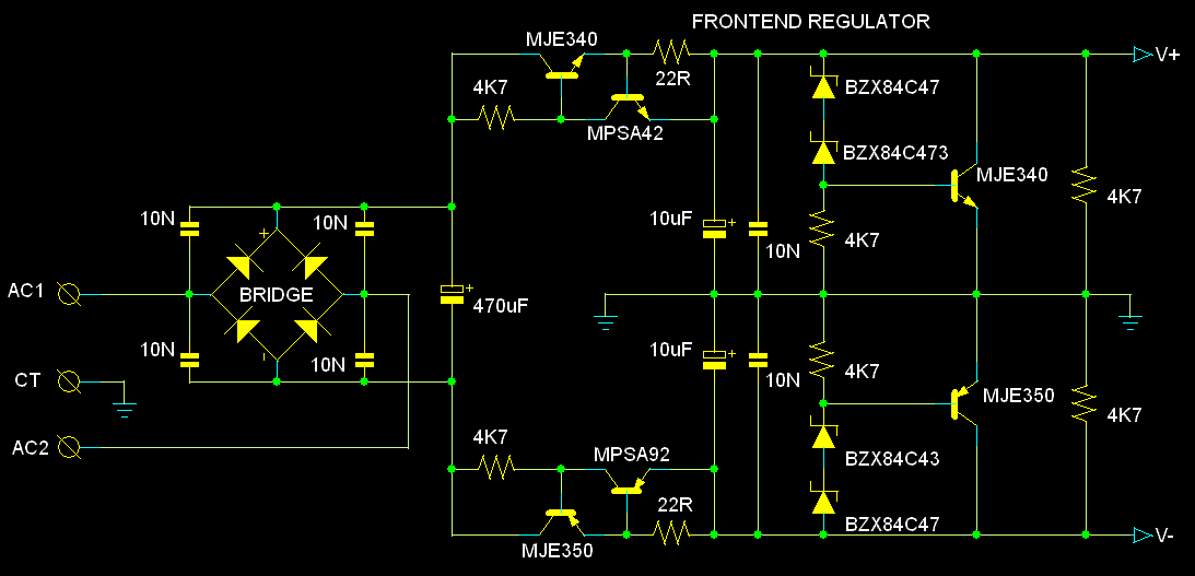

hi nico... is this circuit correct?
Yes it is and will work fine. There were others that wanted/discussed a more elaborate shunt regulator. In short it consists of a constant current generator and a power zener formed by the zener diode and shunt transistor.
Zeners wil determine the operating voltage while the current generator will set the operating current. Always set the current >20% than what you need so the zener can regulate the voltage.

Dacuycoy,
This is not the same CCS that Nico presented in post #180.
As it is in your post it shouldn't work.
George
You are right, your tempco is from two different junctions, I will try that.

Dacuycoy, your schematic is terminally flawed. Look at where the MPSA42/92 are. The CCS for both polarities is wrong.

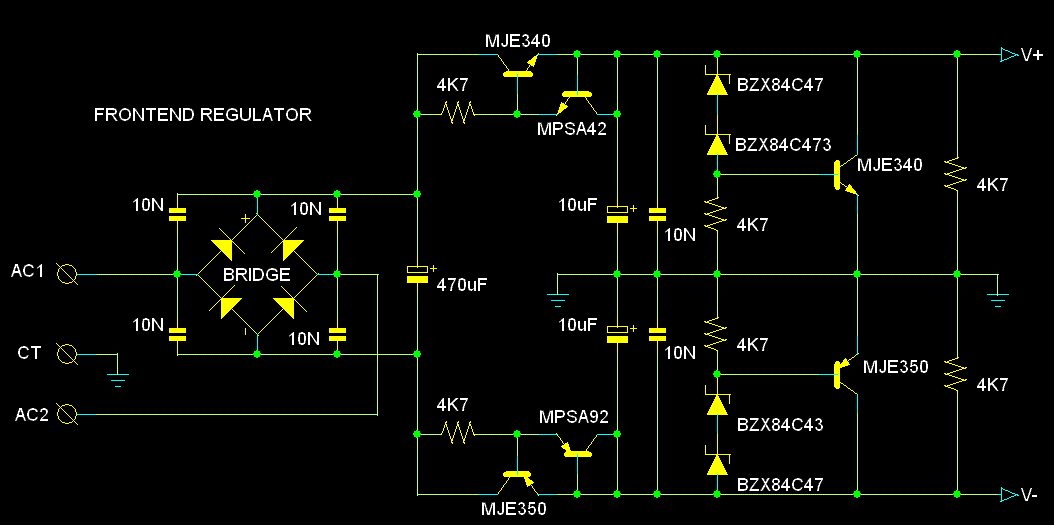

Dacuycoy,
Some thought of improving the circuit
a) Replace the 4.7k resistots with currenr doides
b) Add small cap across zeners
c) Split the first filter cap into two caps
d) Replacing the shunt element with a Darlington?
Question, do we need a cap after the current source?
Any thoughts guys, I have used this basic regulator before and can vouch that it sounds very good.

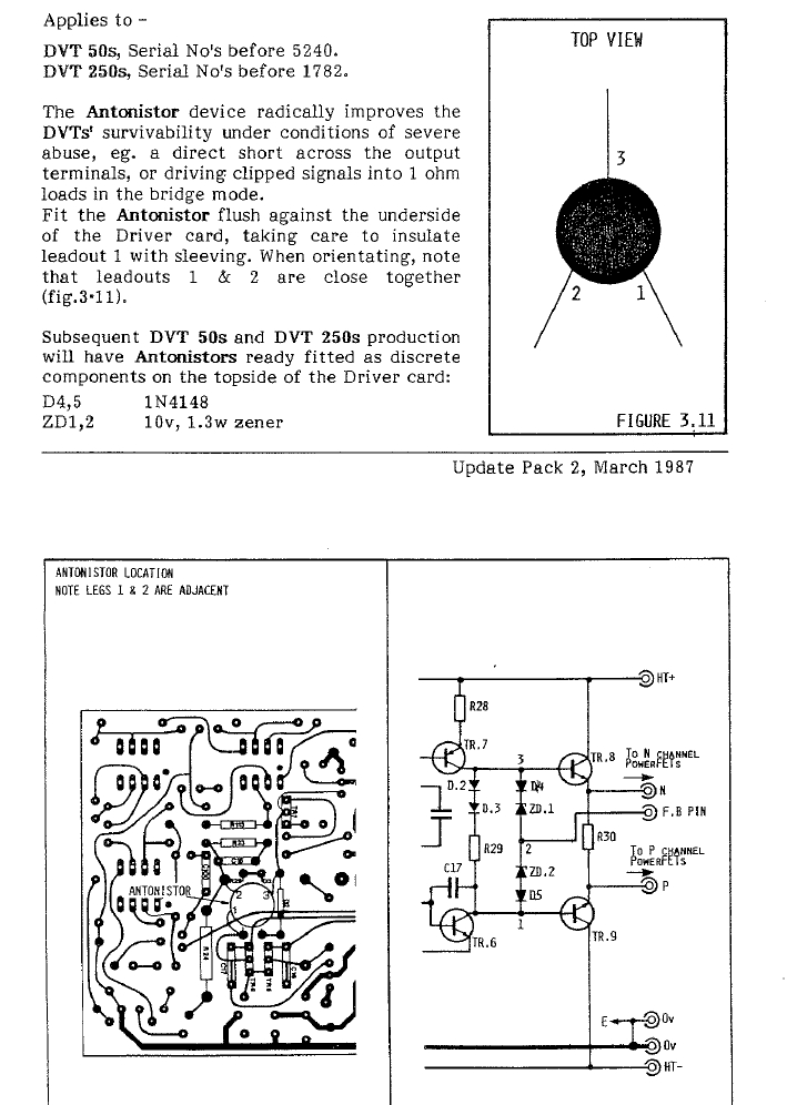

The zeners and diodes serve no purpose at all in normal usage. But (as far as I understand) greatly improve the chances of the mosfets surviving dead short conditions.The zeners and diodes are removed they have no purpose because these lateral Mosfets already has them built into the die.
With the zeners in place replace the fuses.
Adding the zener protection to the base of the drivers current limits the drive to the mosfets and allows the integral protection to cope with sub 1 ohm loads.
Without the current limiting the robust drive circuit will destroy the gate protection.
I reading this from Hi-Performance amplifiers by Ben Duncan.
Attached a part of the Rauch DVT Manual showing the zeners & mosfet drive.
Fairly relevant as very similar to the Goldmund drive circuit.
Rauch DVT 250s Dual Mono Lateral Mosfet,
per channel:-
4 x Hitachi 2sk1058 sj162 pairs,
1KVA transformer,
2 X 15,000uf caps
87 - 0 - 87 Volt rails.
300W @ 8R / 550W @ 4R.

Many high output lateral mosfet amplifiers have the zener protection circuit. Without it a high power amp blows up fairly spectacularly!L-MOSFETs
survive all kinds of abuse without multi-slope load-line limiters because (i) they
withstand considerably higher junction temperatures than a silicon BJT, for which
200°c and often 150°c is the absolute maximum. (ii) the current that can be passed
reduces at high junction temperatures, due to increased channel resistance, and (iii)
the integral protection diodes quickly hard-clamp the gate drive (provided the drive
current is limited) when the junction temperature exceeds published ratings.

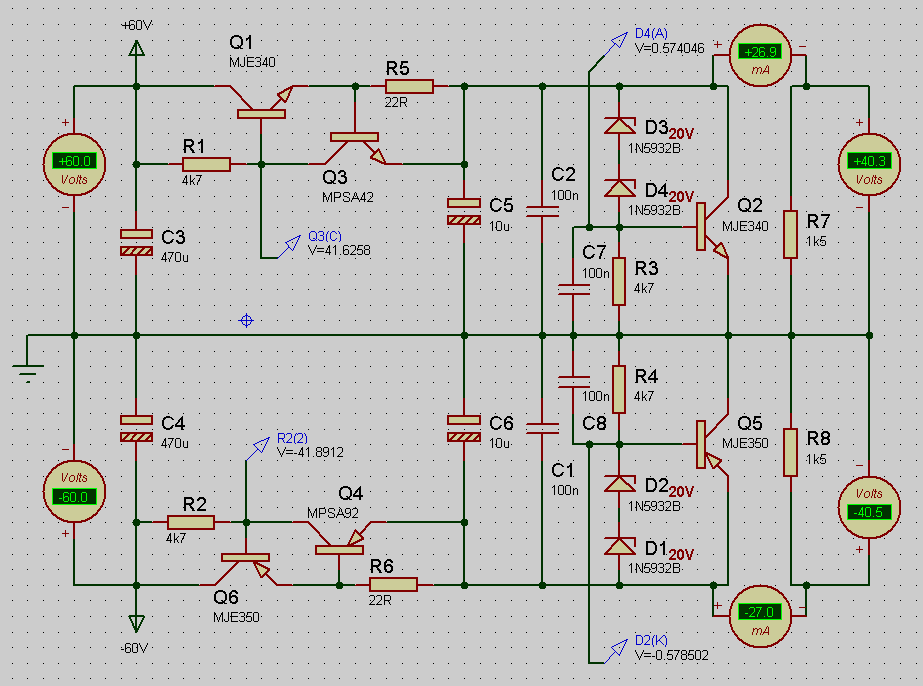

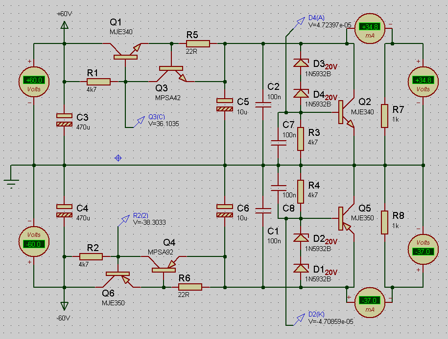

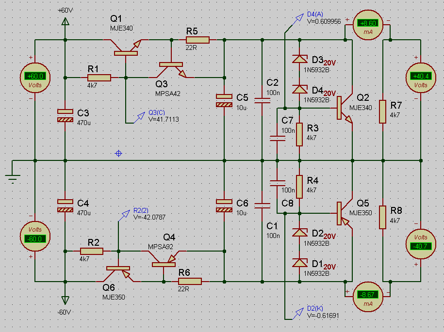

i had simulated nico's circuit with proteus profesional and here are the result. first picture 4k7 load. 2nd picture 1k5 load and 3rd picture 1k load
Hi Dacuycoy,
When using a shunt regulator, you first need to decide what current you need and design your CCS around this value plus some spare current to operate your shunt and allow for variations that may occur.
The second criteria is to decide what the operating voltage of the system is and that determines the zener.
You also need to consider the power dissipation of the series pass transistor at the full current with relation to the volt drop across it.
Finally the power dissipation of the shunt transistor at full load (when there is no external load connected).
So you can choose values that suit the application quite easily. Keep in mind that the pos and neg rails will never be exactly equal as the PNP and NPN transistors have a difference in Vbe, so this will be the difference in rails.
I suppose that you can omit the series pass transistor with just a resistor, but I like having a CCS which allows for short circuit protection, in other words current limiting.

Hi Xoc1,
I used a 22 000 uF cap charged to 50V as power supply and wired the MOSFET and driver with and without zener & diode on the driver. With a short i.e. capacitor connected across the drain and source I destroyed two MOSFETs blown open circuit. The fuses were 3.5 amp (fast blow) and remained in tact when the zener & diode was connected.
I then replaced the short with a 1 ohm load (source resistor) and the third MOSFET survived with and without the zener & diode on the driver but the fuse blew each time.
MOSFETS were Hitachi 2SK1058
I am not sure if this is useful information or proves anything really.
If I may suggest would it not be of some significance to use a source resistor instead of nothing (Goldmund) as there would be a voltage developed across the source resistor which may bring the zener protection into play.
These are expensive fets so I guess many tests would be out of the question.
