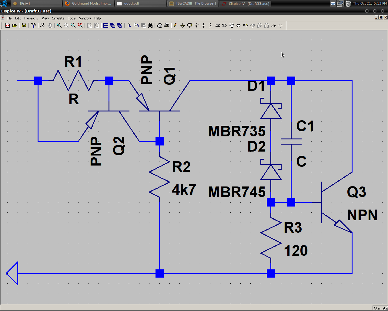

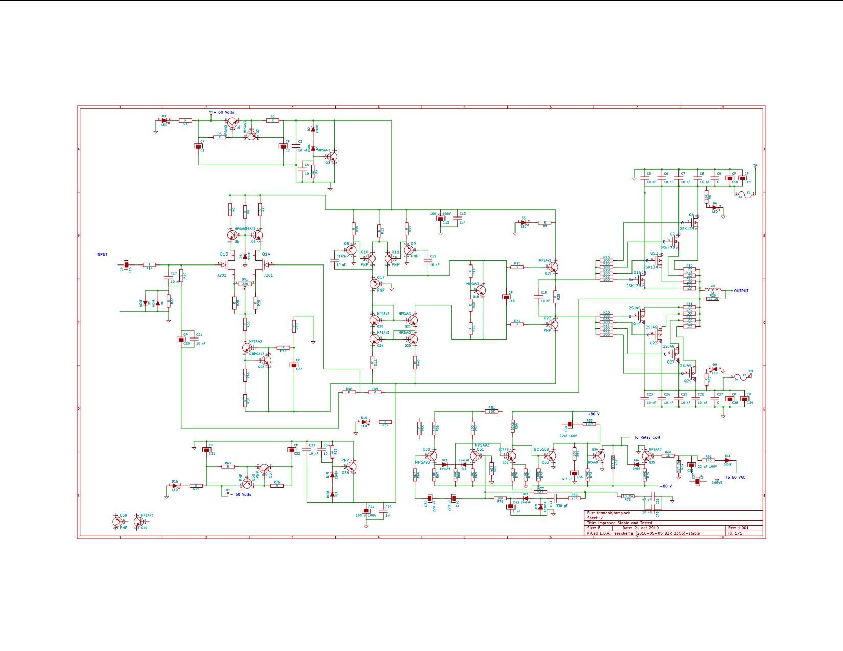

Kris, that schematic is very unfinished. Where do Q8 and Q9 connect to the input LTP?
Q1, Q2, Q36, Q37, and Q38 are all wrong. C4 and C34 should be across the diodes, not the resistor, and D17 and D3 should be zeners. Shouldn't input ground go to the top of D7/D8, not the bottom?
Attached is how the shunt reg should look, pay attention! *cracks whip*

Got all that, now.
Should Q8 Q9 and Q10 Q11 be matched pair and thermally coupled?
This turning out to be a lot easier since I have gotten up on the learning curve of KiCad a "little"!!!
Keep um coming guys and dolls, I will have this 100% 100% 100% then Alex can treat us all to some REAL eye popping CANDY... and the testing can begin...
By the way just HOW do you attach thumbnails pictures to the post of greater than 300K jpgs like Alex does the pc board layouts, I am missing the boat on this somehow...
Krisfr, why not put 10n-100nF decoupling on the collectors of Q15 and Q22?
If you put the offset adjust at R6/R7 rather than the LTP sources, VAS matching won't matter but your FETs will have to be matched. My preference is to match the LTP and use anything for the VAS.
