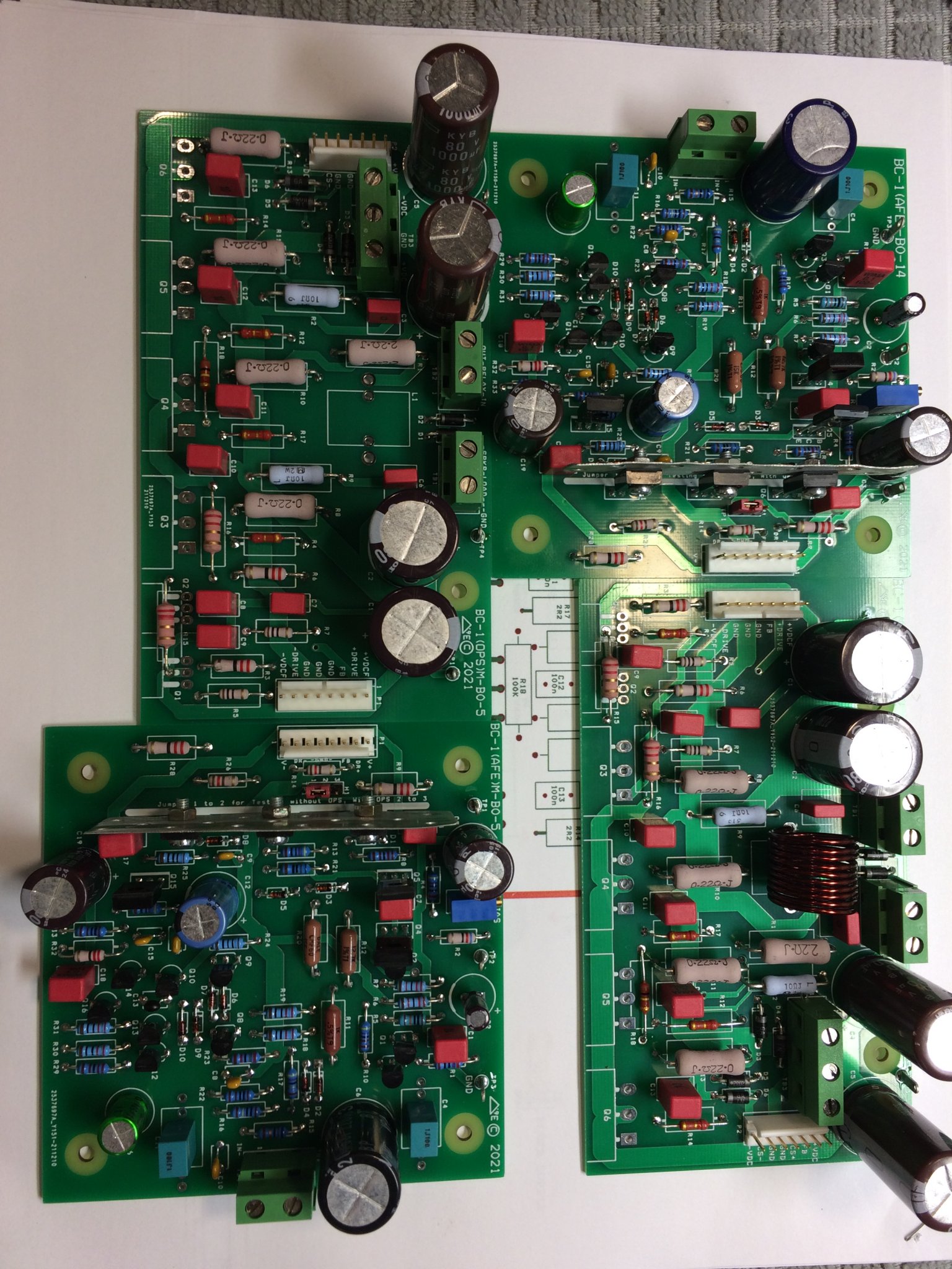

Bob: I may have missed an earlier post, but I'm curious about the BC-1 PCBs. Are they available yet? I so like the modular design idea. With them, I can upgrade the INPUT-VAS-predriver board of an old 250W Amp I have that conformed to a bad idea in the mid 80s - low feedback, low loop gain. Urei 6300. Otherwise it has a nice power supply, thermal design, output transistor arrangement. Pretty poor distortion performance however.

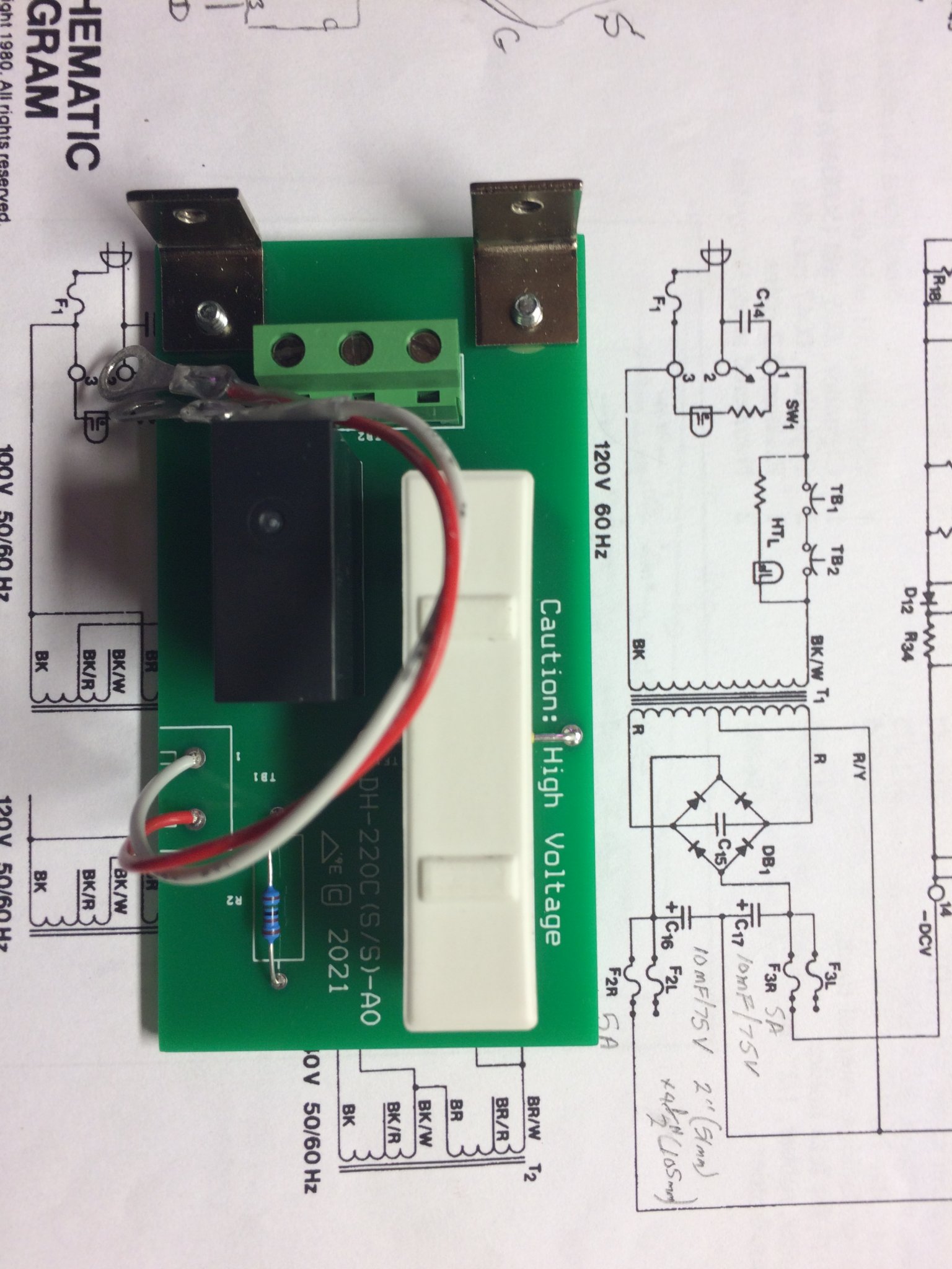

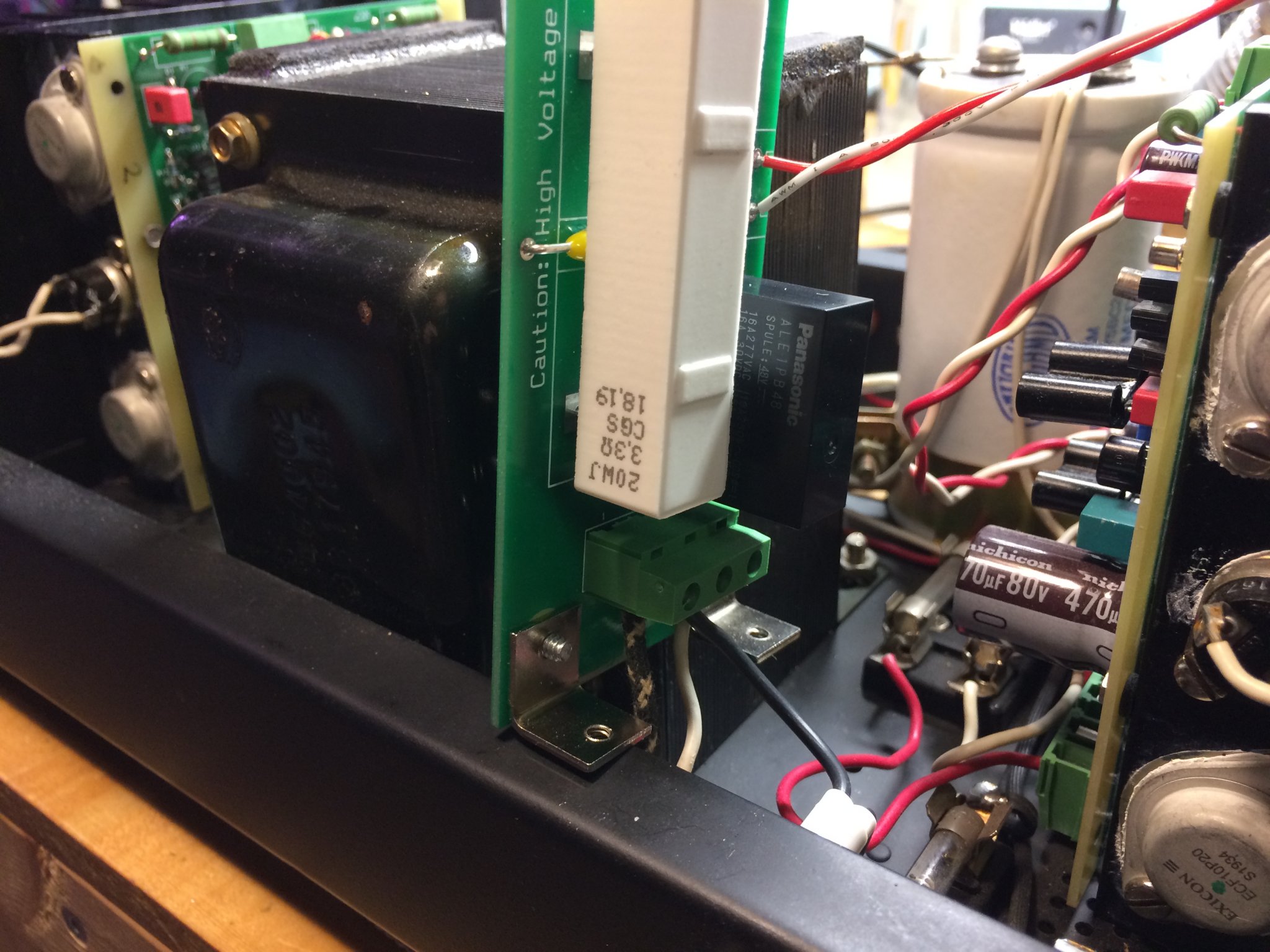

On the Hafler front, I finally fixed my old fried power switch, went one step further and designed a soft start to save the new switch contacts from frying again.

When can I get a set of boards?Bob’s Christmas present from me for 2021, Santa’s work shop runs quietly all year. Well sort of like that as shown, he gets to assembly his own from the blanks Santa gave him. I actually powered one channel up today, it holds bias and dc offset is <10mV, lots of work left to do but I think we are getting closer, bit by bit, winter is set in, iron is hot, happy new year too all.
Is the comparator/protection/relay pcb also available?
I just purchased the 220C set, but am also interested in the BC-1 set. They look great.
One other question: What's the shortest dimension of the Input/VAS pcb? i.e. Height in the last picture.
BC-1 is still in the works, release some time in I hope winter/spring 2022. It is being designed for the 3Ux300mm chassis. There is a protection & PS pcbs, just like in the book. Nothing released until Bob gives it his blessing, just like DH-220C 🙂 Just wanted to show you we are moving along, slowly, since you asked.

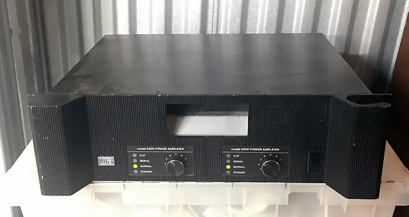

Too bad. I'm planning to cram the BC-1 into a 2U chassis from a dead Urei 6250. I guess the wider input/VAS board needn't be on the side heat sinks. Thanks for responding so quickly. Happy Holidays!BC-1 is still in the works, release some time in I hope winter/spring 2022. It is being designed for the 3Ux300mm chassis. There is a protection & PS pcbs, just like in the book. Nothing released until Bob gives it his blessing, just like DH-220C 🙂 Just wanted to show you we are moving along, slowly, since you asked.

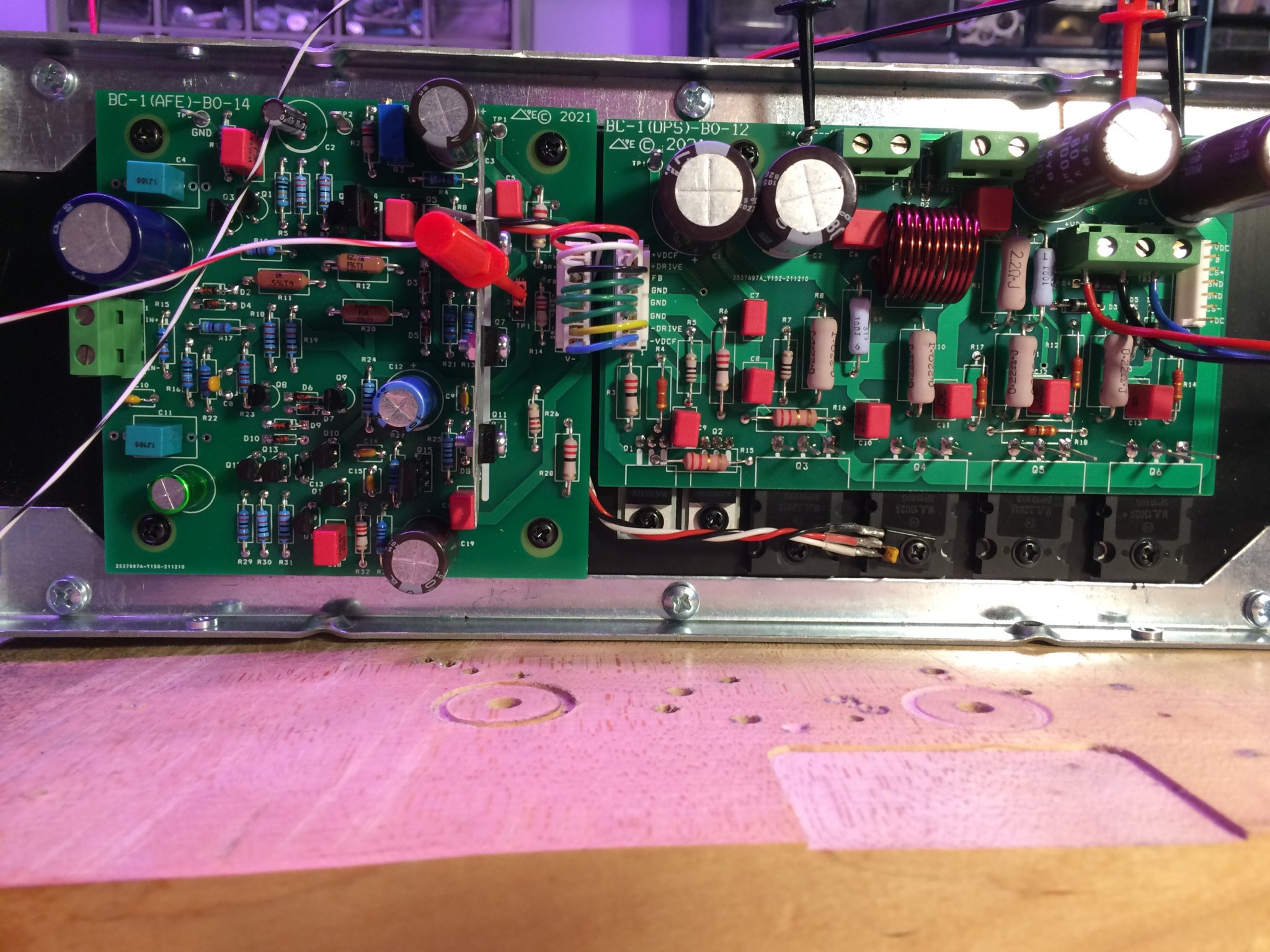

For sure, it can be done in a DH-200, since I used a couple of DH-200's for my proto builds, Bob has DH-220 and P-230 chassis, Others put them in DH-500, still waiting for a P500/505 mod to show up.
Photo above on the right is the new soft-start pcb/ckt installed in the DH-200 chassis. I also changed the power switch, since it was fried.

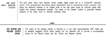

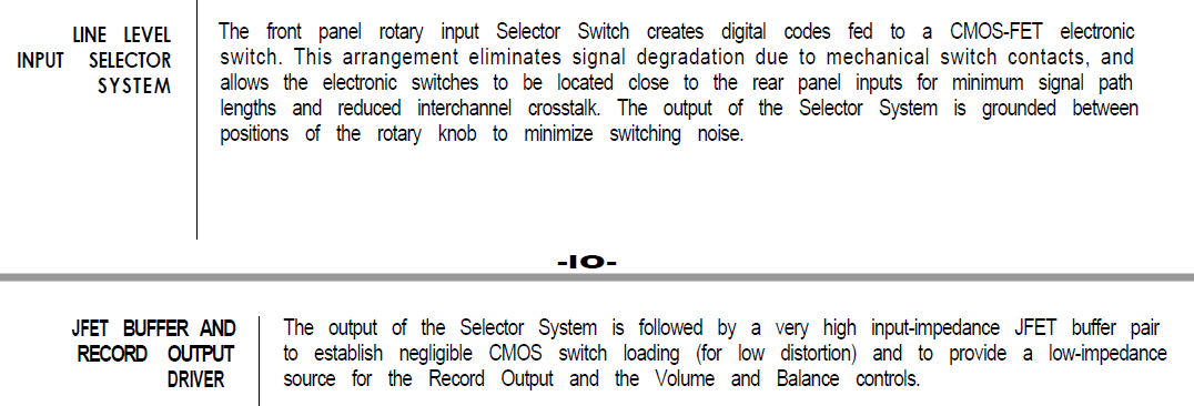

Here's another one for you. For my IRIS pre-amp Hafler indicates the following THD+N:
Moving Magnet: .002%
Moving Coil: .009%
But every analog input gets routed through a CMOS MUX (CD4051). The best performing (THD) CD4051 I can find is the old National part.
Which they indicate is 0.04% @ 1khz into a 10kohm load. (BTW, TI offers the contemporary version of the CD4051 and it's THD performance is much worse)
So how does Hafler get to the .002-.009 range? Is it the case that the output of the CD4051 driving into a higher impedance of the Hafler JFET amp makes the THD of the CD4051 improve? Not so sure.

Seems I have found an answer to my question above...Yes you can improve the THD of an analog CMOS switch. Great read, BTW.

Regarding your question, please see attached image captured from the Hafler 915 Preamp manual.
The distortion in the data sheets is worst case specified under certain conditions; so for less strenuous test conditions, the distortion will be less.
Seems that at least one way to minimize analog switch distortion is to reduce the voltage swing across the switch. Two ways to do that:
1. Reduce the current drawn through the switch Ron (for example, use a J-FET opamp/buffer after it)
2. Use the switch in the virtual ground input of an inverting op amp gain stage with the switch connected to the inverting input. Of course, you have to watch out for parasitic capacitance, etc. when you do this, but as you mentioned, you can also throw a switch in the feedback loop and play with the gain setting resistors to (mostly) cancel the switch's resistance.
