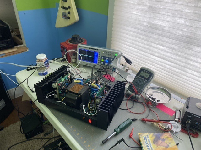

R44 is dead shorted? Q17 tests OK but what is seen at it's base when sine wave is coming in?
You have symmetry here to your advantage so scope out things on the positive side and compare to the negative side.

R44 is not showing any current through it; no voltage drop across it. The resistor itself is fine. Same with its symmetrical twin R29. Which is really weird to me.
But I'm learning how to reverse engineer the schematic and signal flow, so I'm doing a bit of trial and error and a lot of thinking and grasping at concepts. Which is how one learns, I suppose. I might be barking up the wrong tree even looking for current though R44.

As I indicated, I think your best bet in locating your issue is to scope probe and compare between the positive an negative rail circuits.

Is this the results of a first time power up test?
No need to pass a AC signal thru if you can not get it to bias up properly.
It is hard to say what exactly. Check all the components for the correct ones, orientations, in the VAS, Q7,12,7,18
You wont get proper OPS bias if the front end is not op properly.

I’m only working on the AFE in the bad channel at this point given the DC offset as shown by the AC signal images- that was just scoping the AFE driver wires, no OPS.
diagnosis progress: all resistors and diodes on the AFE fine. Which leaves…

Update.
I checked all the BJTs for shorts and diode drops from base to C and E, and vice-versa on the P-types, and reflowed any soldering that looked even remotely questionable.
Now I've got it out of the testing TP1 jumper position, hooked up to the OPS, and RV2 is letting me set the bias on the output MOSFETS. With 30mV bias, I've got a steady 1.6V dc offset at the speaker terminals without any signal or load, and that offset goes up with more bias. Still, better (for everyone, especially speaker drivers) than 16V. I'm on an isolation transformer->variac and have the rails at +- 55V
It's progress.
I'm wondering if a transistor in the negative side is on its way out.
I'm going to start poking with a scope at various points in the signal path to compare sides and, if necessary, compare channels.

Note: when one* properly places the test jumper back to the operating position as opposed to missing the middle pin, DC offset issues tend to go away.
This was not the initial problem, rather one encountered while debugging and testing. Post mortem: I'm going to go with it being a bad soldering connection in the AFE yet again. Because this amp insists on being my education on learning skills the hard way.
