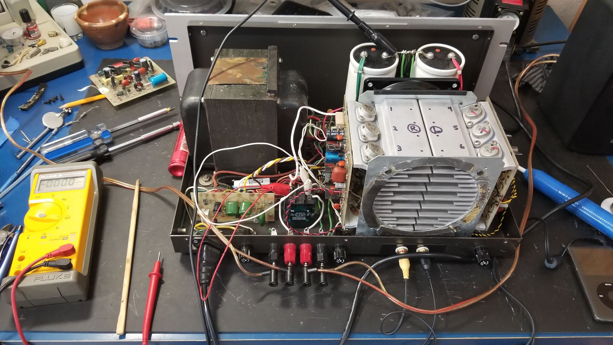

Is there a way to test Hafler DH-series amps with the Mosfet outputs removed?
I've searched and haven't found a totally clear answer.
I'm trying to locate a significant current draw and the MosFets test fine individually when removed (just testing on a cheap eBay transistor tester, so I understand it still could be an output).
Tested with Right rail fuses installed, left removed. Only got to 20vac on Variac before I noticed problems. Measured 10vdc on positive rail at filter cap, 6vdc on negative rail at filter cap. At speaker relay I measured about 4vdc on output.
So, obviously something is dragging negative rail down and dumping a portion of the rail voltage onto the speaker output.
I would like to rule out the board before proceeding.
(EDIT: also at 20vac on Variac, meter is showing about 5A current draw on AC line. Obviously not a good sign.)

Those pin numbers don't look right. You remove the FET's and link the feedback point to either Q12 or Q13 emitters.
So I would say either 4 or 9 to 8.
Easier than all that to begin with is to monitor the voltage across R33. If that rises above more than about 1 volt or so then the FET's will start to conduct. See what you have across there first.
The amp will run OK with one pair of FET's fitted for test purposes.

Update: issue solved. I feel really stupid for this, but I think it's probably an easy mistake to make.
It turns out that there is a difference in the connections for PC-10 and PC-19 boards.
I knew I had the earlier PC-10 boards, but the only assembly manuals available online show the PC-19 boards in the schematic and wiring pictorial.
Well, I was trying to solder up the dummy 1k resistors and something wasn't clicking so I dug around and managed to find a fuzzy PC-10 schematic only (no wiring diagram).
Turns out that between the board versions terminals 4 and 5 (Gate and Line out to Relay) are flipped. And Terminals 6 and 7 (Source + feedback loop and Ground) are flipped!
No wonder it wasn't playing nice.

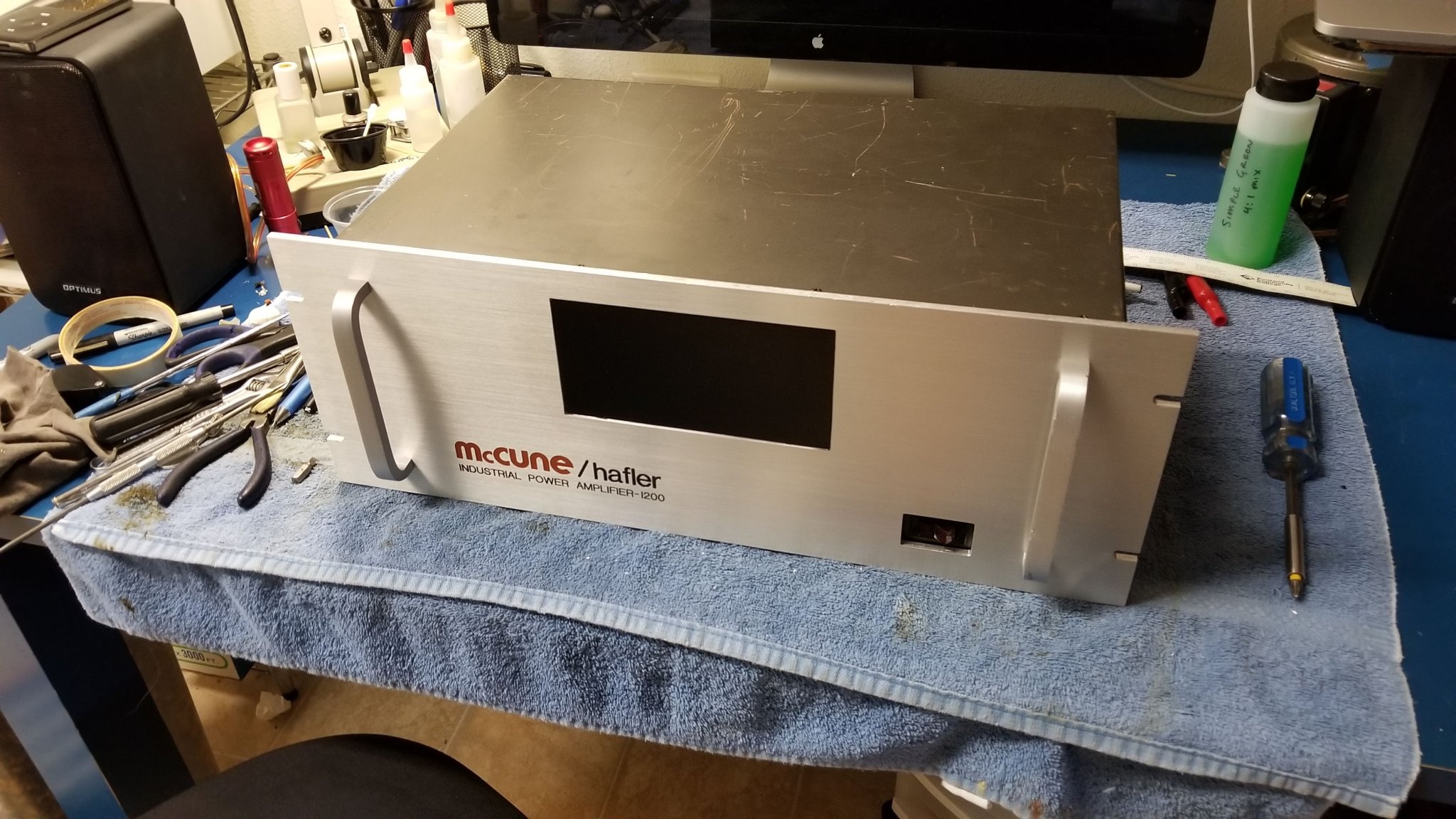

This amp's prior life was with a Pro-sound company and it came to me labelled for "parts" after the fan failed and someone tried and only partially succeeded in repairing the fan circuit. Whoever was working on it left it partially disassembled, which is why I had to reconnect all the wiring to the amp/heatsink module.
Happy to report I got the wiring corrected and it has been playing sweet music. And yes, I did repair the fan circuit. The fact that attempts to fire it up with the wrong connections didn't blow it up really impresses me with how rugged these old amps are!
