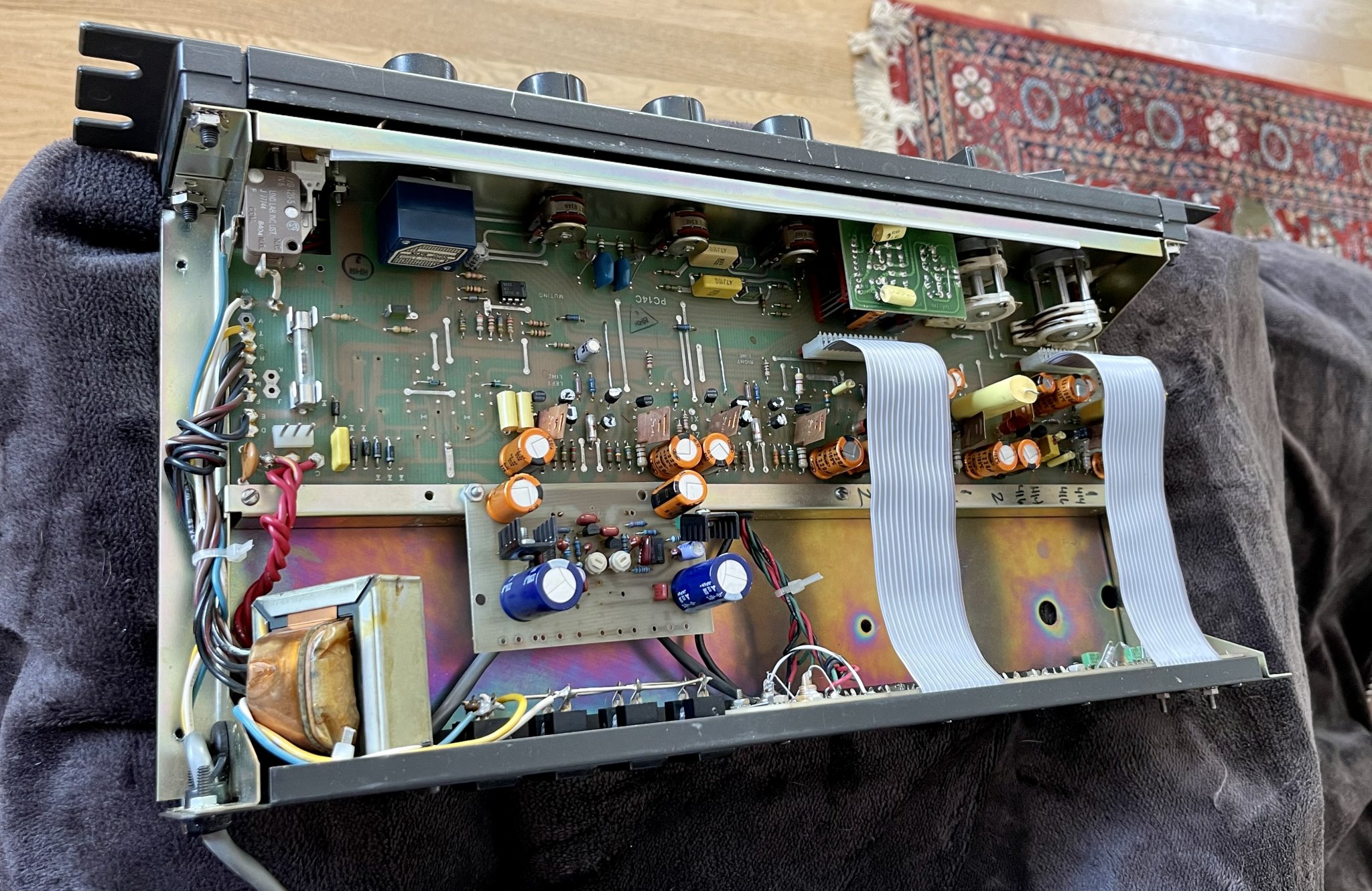

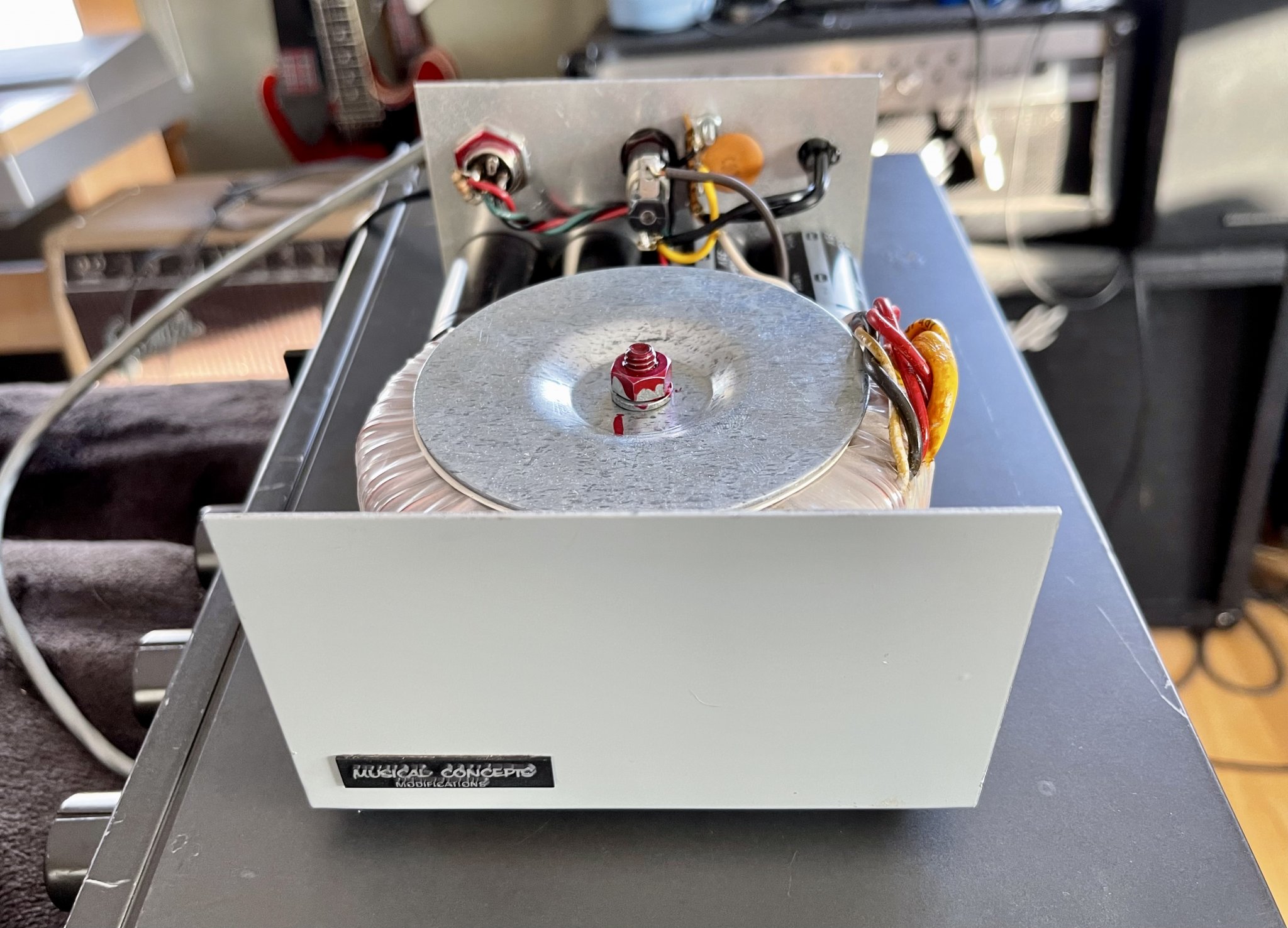

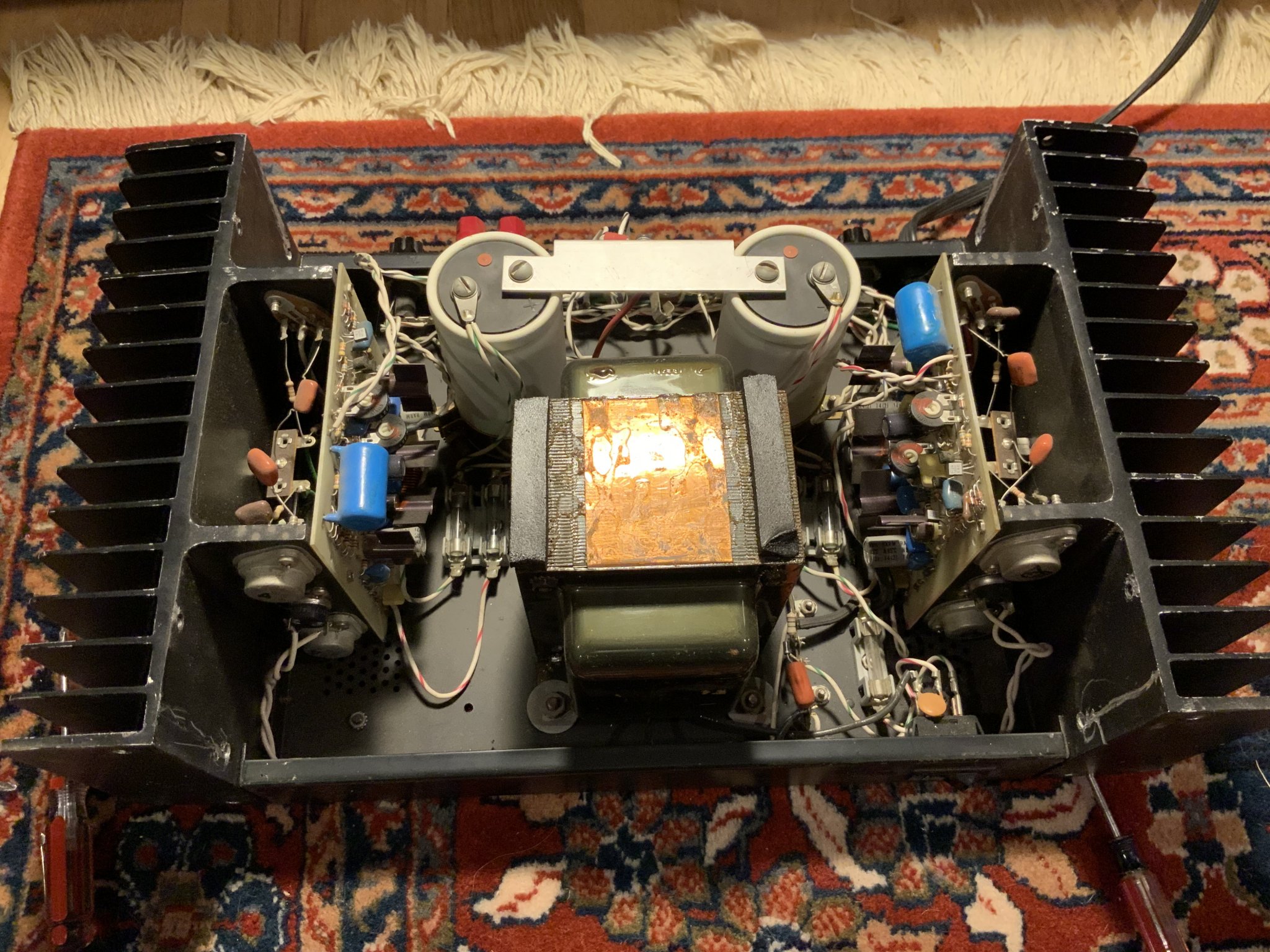

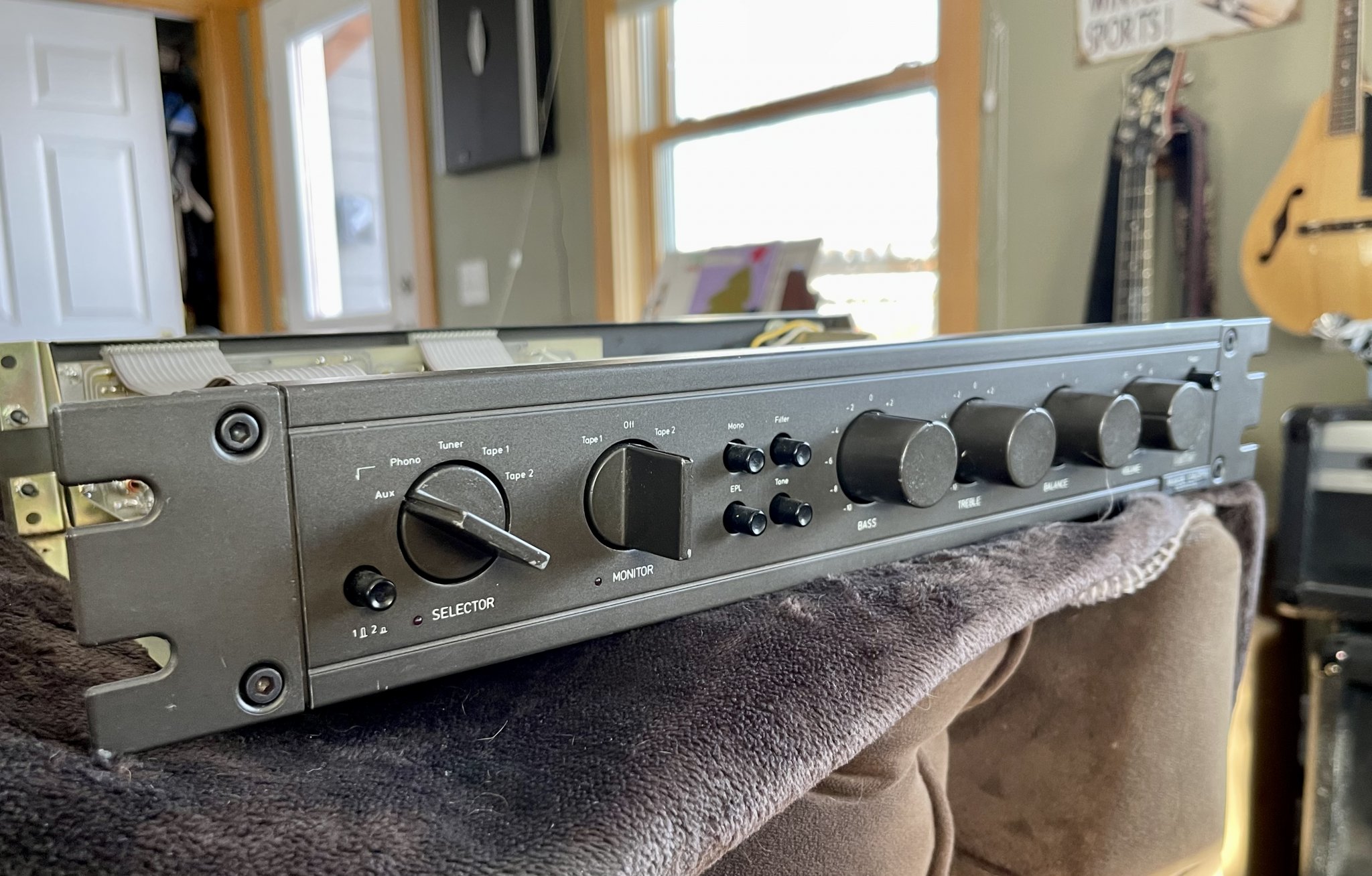

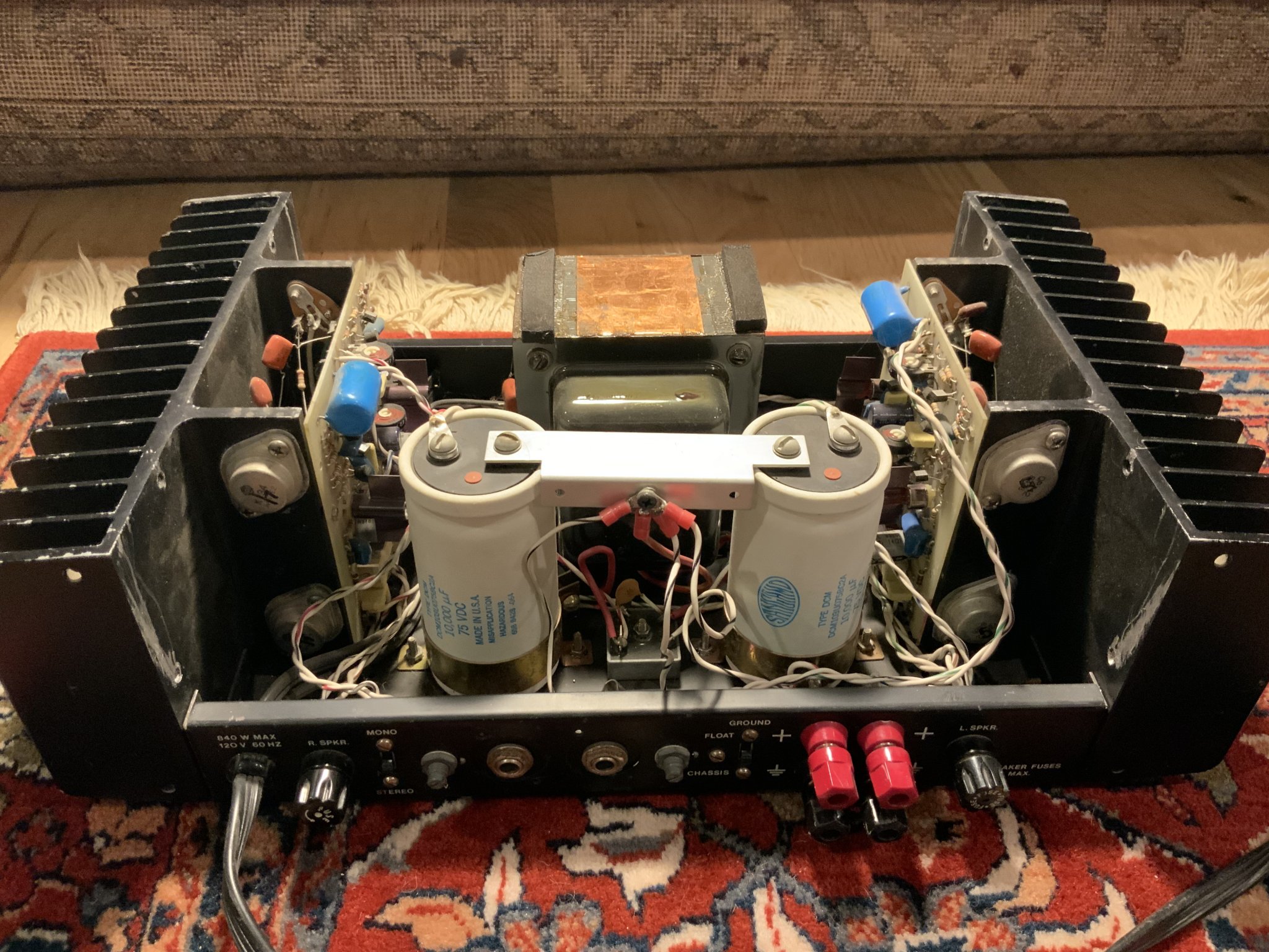

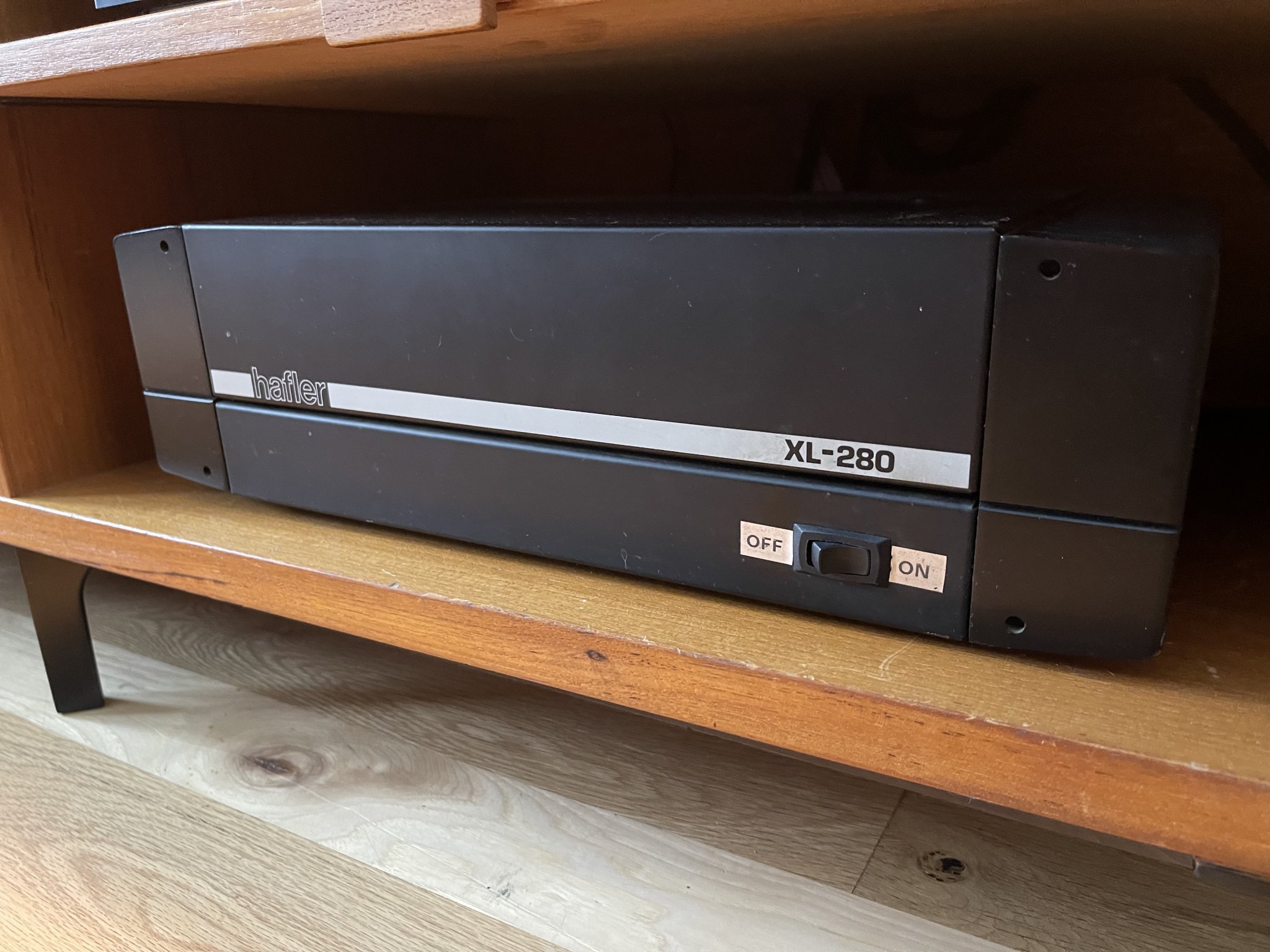

Hey folks. MOSFET sound fan here in Sun Valley, Idaho (well, Hailey, down the road a bit). Popped in here a couple years back when I received my first Hafler, a P225, which was working fine and I grew to really love. I had it at home, and a Music Hall Class A at work, also MOSFET based. The P225 started popping the left speaker fuse (I still am not super good at electronics DIY, and start to tap out after anything more difficult than replacing pickups in a telecaster). So maybe it is something simple. But I also am interested in improving it, or the XL-280 I picked up and have in use now.BC-1 is still in the works, release some time in I hope winter/spring 2022. It is being designed for the 3Ux300mm chassis. There is a protection & PS pcbs, just like in the book. Nothing released until Bob gives it his blessing, just like DH-220C 🙂 Just wanted to show you we are moving along, slowly, since you asked.
Good luck with DH-220C, I have mine running since the day I fired it up. Glad I fixed the AC switch issue, now I have to change out those old RCA jacks. I will try these Neutrik NYS367-2 & NYS367-9. The cheap ones from Asia just don't cut it for me.
I also have a previously modded DH-110 that was turned into a MC unit with a big outboard power supply. I received that used, and liked the sound well enough, over a lesser 2006 PS Audio preamp I had before, but it started humming. Kinda sounds like a bad ground. And the old two prong power cord connecting to the outboard power supply seems to be pulling loose, or at least the insulation is. So likely I will need to go through that (or more likely have it gone through). Have read about the disputes regarding MC stuff, and to mod or not to mod, and which way to go if one does. Interested in Mr. Cordell’s work and purchased the articles in AudioXPress to learn more also.
So for now, will keep using the XL-280 which seems to be working just fine, and learn, and see about purchasing either the DH-220C which I would guess would work for my P225? (will read and learn). But wanted to stop in and say hi, and throw out there what I am thinking about. For me, learning, and working to restore and/or improve these designs seems better than spending a few grand on something newer. Plus, I like the kinda beat up, ”Millennium Falcon” vibe my Hafler gear portrays. 🙂

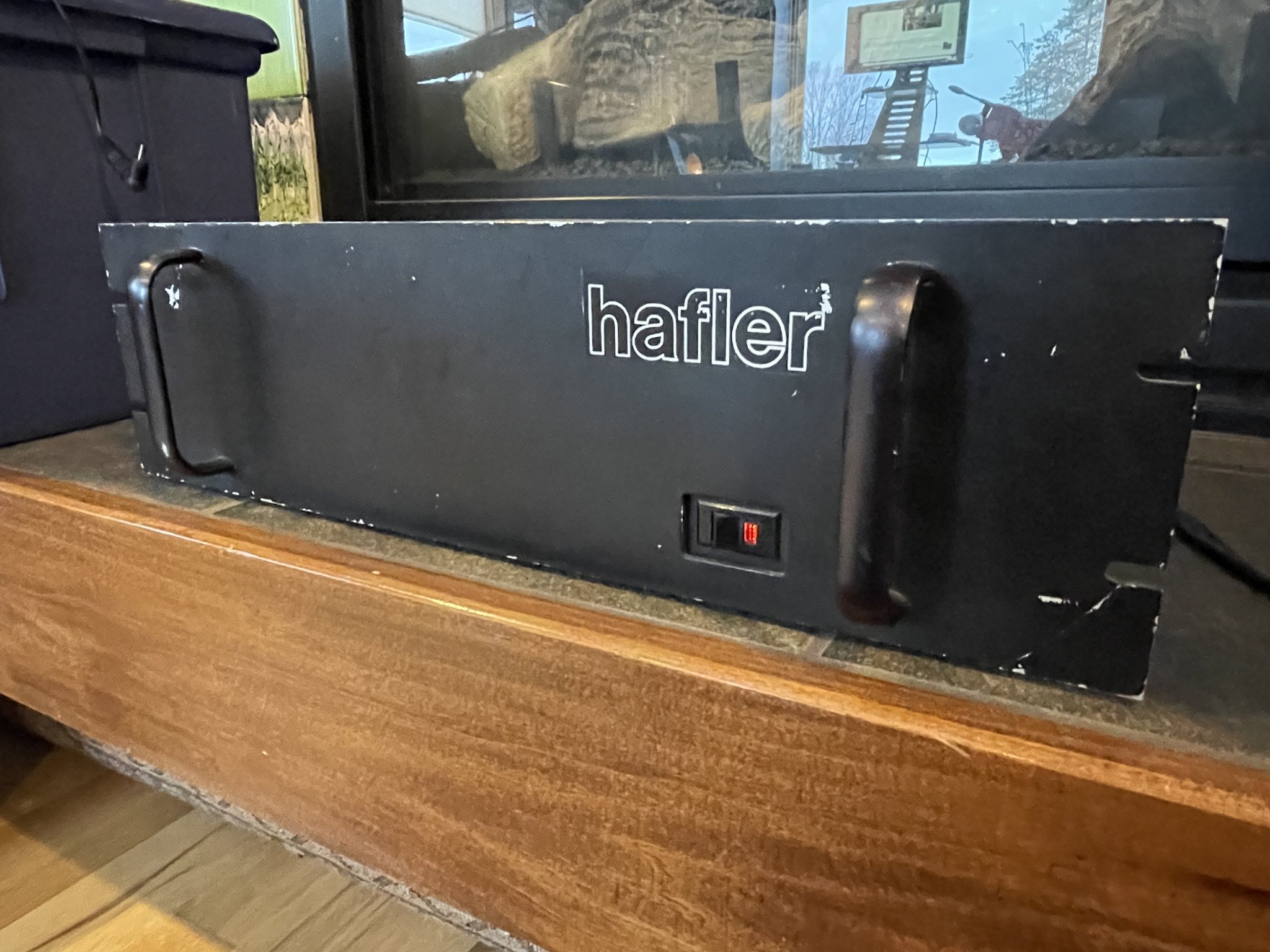

I'm rather astonished about the marks of severe abuse many of the units shown in this thread (not only your's!) show 😳!
Best regards!
Best regards!
If you are talking about the case, I agree, but as I said, it does not bother me as long as it is working properly and well, from a looks perspective. As I also said, gives off a Millennium Falcon vibe that I am fine with. But yeah, the paint on everything Hafler seems fragile, and they seem to pick up nicks and scratches easily.I'm rather astonished about the marks of severe abuse many of the units shown in this thread (not only your's!) show 😳!
Best regards!
BUT, if you are talking about something you see inside the case that indicates abuse, please let me know. I am a electronics DIY newb and trying to learn. Thank you!

No, don't panic, I was referring to the external looks exclusively 😉.BUT, if you are talking about something you see inside the case that indicates abuse, please let me know. I am a electronics DIY newb and trying to learn. Thank you!

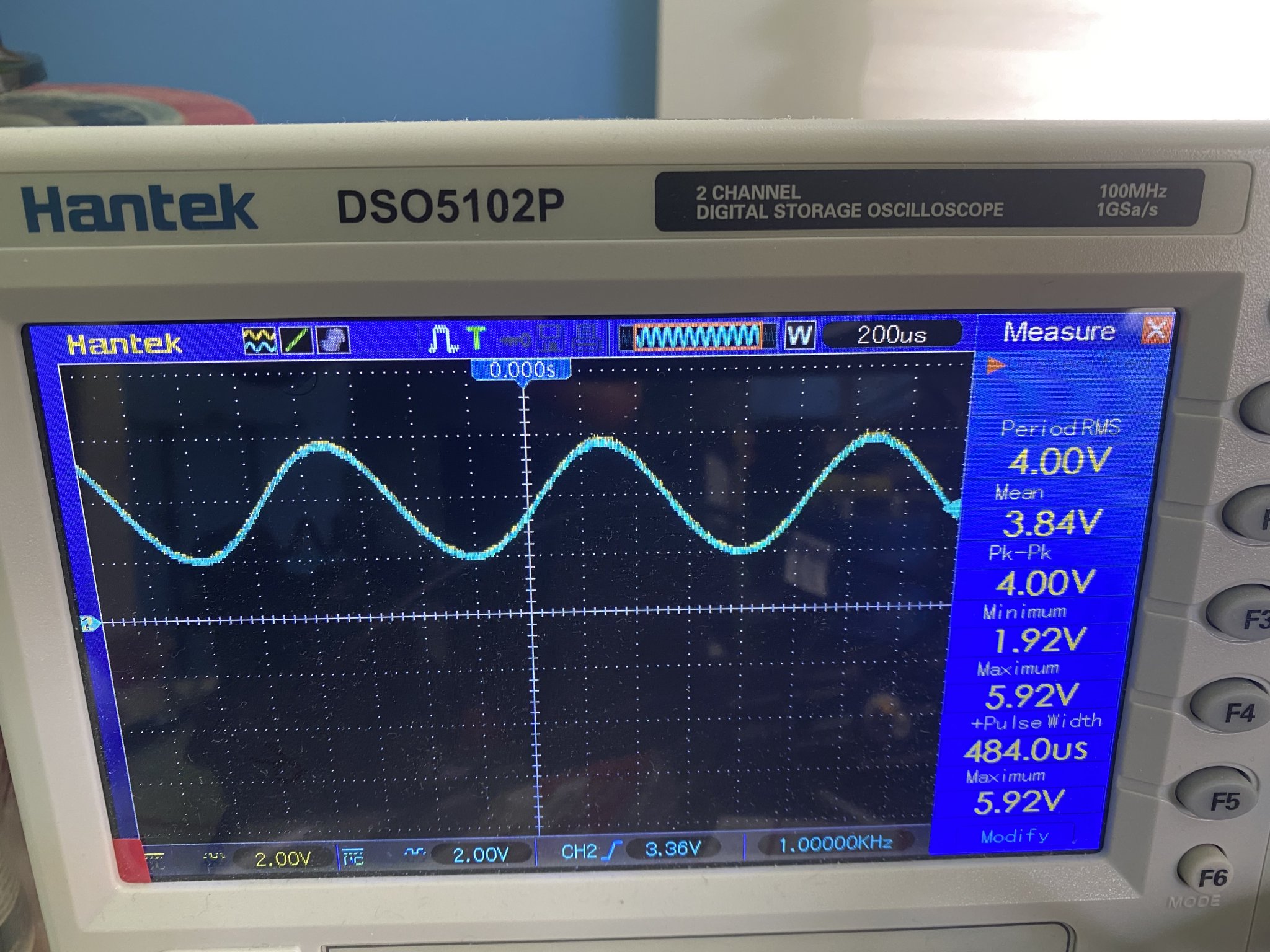

Friends,

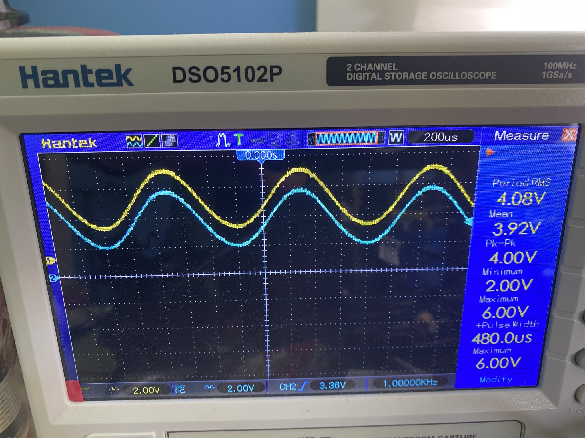

I could use some help debugging a 200-C front end module.
I finished the build in October/November and learned a lot along the way and enjoyed two months of sonic joy.
But at the moment I've got heavy DC (15V or more) coming through the output of one channel.
So I've popped the hood, put her in the service position with just the IPS/VAS board, in the TP jumper mode running, sending a sine wave and scope leads hooked to the drivers. The OPS is entirely disconnected and sitting to the side.
Both the V+ and V- side are passing the signal, but the V- is up in the + voltage range. So I'm thinking something is happening on the V- side of the equation. See attached images. On the second picture, I shifted the V+signal vertical position so you could see the V- signal sitting up in the positive voltage domain.
Voltage drops / current through R12/24 are correct, but nothing, I mean stone dead across R44. Which is weird, because I pulled Q17 and it tests properly in my little transistor tester and I am getting a signal to the driver wire to the OPS... just flipped in voltage.
Also, I've got 15mV across the +/- drive outs (terminal block points 4 and 9) and adjusting RV2 is having no effect on that.
