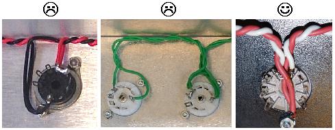

Cat5 pairs for heater wiring came up in another thread. The longest twist pitch on one of the pairs may be too long for AC heaters. Note that Cat5 gains its isolation not from tight twisting but from different twisting in each pair. It is solving a different problem: inter-pair crosstalk rather than interaction with nearby circuits.
Here is something I did, it might help. The picture is not so good but you can see some of the copper the showing. They sell this kind of copy foil with conductive adhesive for electrical shielding. It is tough tape, almost like duct tape.
After doing the hearer wire I covered it over with copper tape. I did it all correctly, run in the corners and so on but then as an extra I cover it all in copper. This does 3 things (1) it looks cool and hides the wire and (2) it sticks the wires down and keeps them in place and maybe (3) it adds small amount of shielding.
Heater wires creat a magnetic field mostly and copper does not much for that but it might keep radio and what not out. And it looks good
https://www.dropbox.com/s/vhj9ykofaodw936/guts.jpg?dl=0
The amp BTW is a modernized clone of a Fender Champ. I used Fenders 50's vintage schematics but modern construction techniques and it is dead quiet with a very low noise floor. It uses a power supply choke and some slightly over sized filter caps and is wired with brightly colored coaxial shielded hookup wire with shields grounded at one end. The heaters are AC but running at 5.8 volts and the AC is biased up to about 1/10th of B+. This I find makes it run quiet.

This topic is about heater wiring and implementing good practices during builds.
