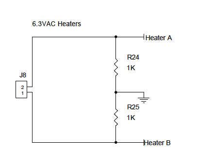

A choke of the type that you refer to will not help reduce common mode noise (data here). If there is any common mode noise from the supply (perhaps from some HF coupling from primary to secondary windings rather than through the magnetics) then a bifilar wound choke would be more suitable. Differential noise across the filament will be pretty unlikely in most cases and at the frequencies that this choke would block the noise would not be coming from the transformer in any case.
If hash getting on to the filament wiring is really a concern, then perhaps some simple decoupling either across the filament supply and from the filament supply to the chassis would be rather more effective (and a lot cheaper).

How about using a RF Hash Choke right at the filament pins on the tube socket ?
Morgan Jones talks of using an RF common mode choke in the feed to heaters, followed by balanced capacitors to chassis to, I presume reduce electrostatically coupled noise via the cathode.
Small chokes are often used as a series addition to larger inductors to improve their parasitic characteristics, extending bandwith, and inductors have been successfully used with filaments to separate signal from supply albeit a less practical way to do things.

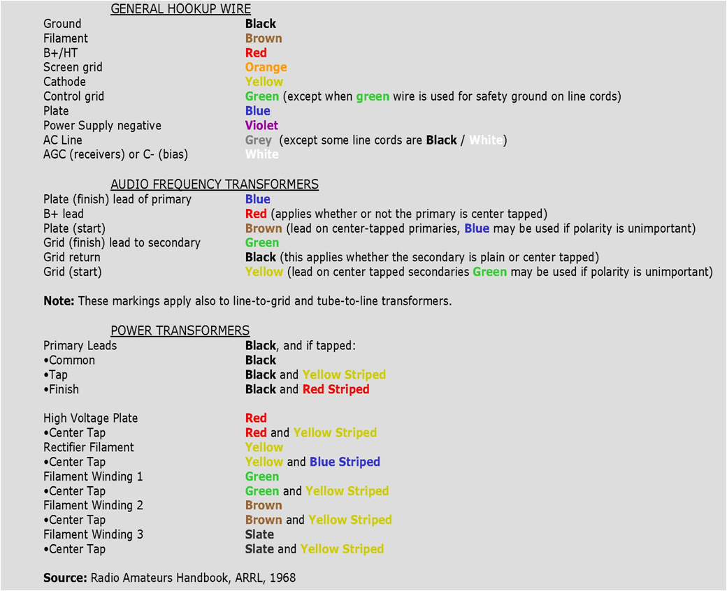

I'm working on laying out my 1st amp and I'm in the process of bathing parts and laying things out with Adobe Illustrator. I'm building a Chubby Clementine amp with point to point construction KT88 power tubes and 6SN7 pre tube. See below for the heater circuit off the 6.3V secondaries.
Here are a few questions for the heater wires:
1) what brand / type / gauge of solid wire?
2) what order should I run the wires to the tubes? Should I tie into the 2 power tubes first, or start at the pre tube?
3) what would be your preference for the two colors I should use?
Thanks! This thread has been very informative!

Solid insulated copper wire of the right thickness to carry the current while under a hot chassis is what you need. For 3A of heater current I used cores from 20A mains cable. Ignore brand. Twist the wire tightly - there is lots of information online about how to do AC heater wiring. Do power valves first, so there is not too much AC current near the small signal section. You can use thinner wire for the smaller valves.
My cables happened to be red and black, but colour does not matter. It should be obvious which is the heater wiring, and AC does not need to show polarity.
