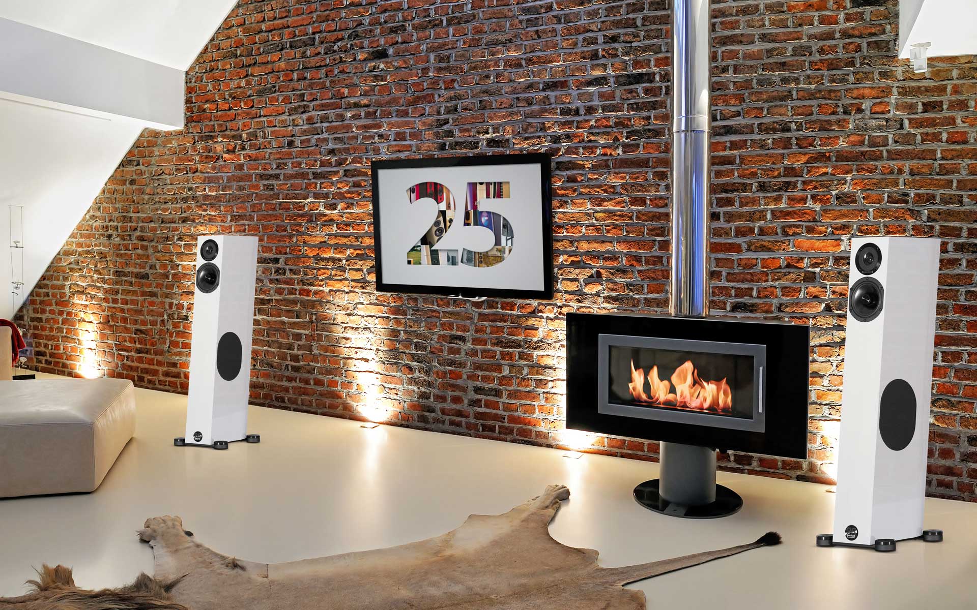

For instance you posted picture of speakers you found while surfing in post #128 and said: "The WAF isn't very high, but if you add a grill to both drivers and the woofer-gap..."
They do look a bit big, and that could be the problem, but in picture you posted they look really pretty, and I don't understand the need to cover drivers and woofer gap. They look nice and clean, no need to cover that.

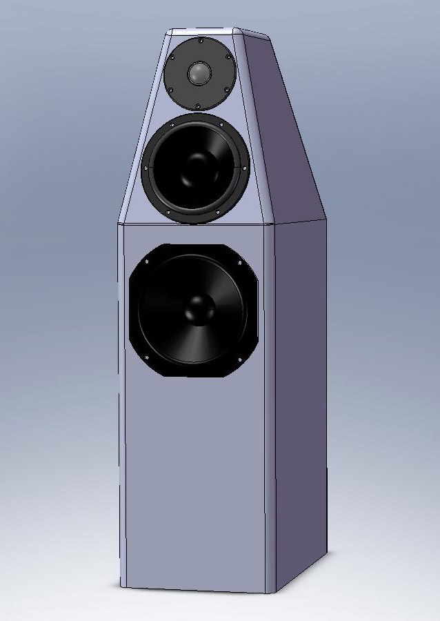

![j7Y9Wc9.jpg](https://i.imgur.com/j7Y9Wc9.jpg)

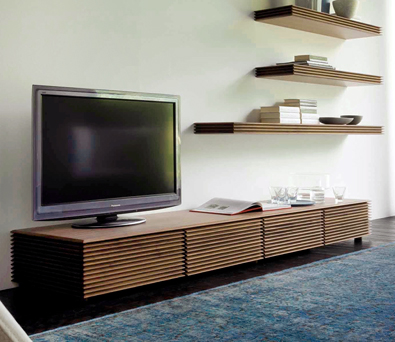

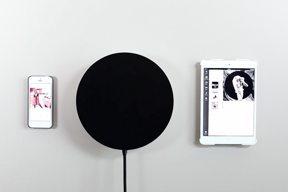

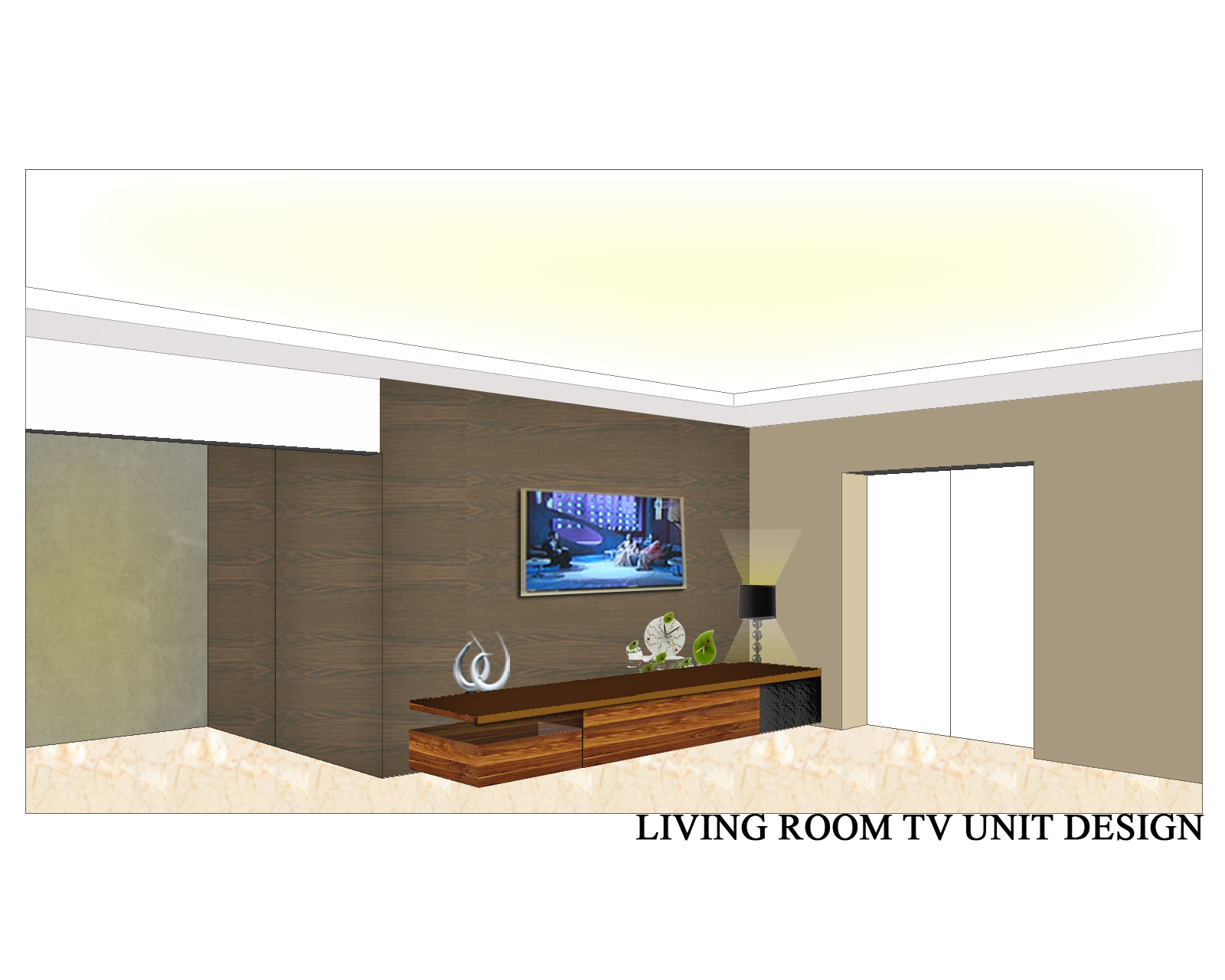

Heres a first rendering of subwoofers integrated into the console and a half-sphere on-wall speaker.
![Ne92Nfp.jpg](https://i.imgur.com/Ne92Nfp.jpg)
![bvhWMHn.jpg](https://i.imgur.com/bvhWMHn.jpg)
![mw4Fs2t.jpg](https://i.imgur.com/mw4Fs2t.jpg)
![lxD7aQM.jpg](https://i.imgur.com/lxD7aQM.jpg)
I tried hiding the cable first, but maybe accentuating it is better?
The design is heavily influenced by the Libratone Loop, but considerably larger (38 cm diameter, 17 cm deep).
The brown thing is supposed to be a piece of leather with a logo.

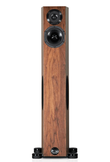

What about something like this. It's not much bigger than the speakers you already have except being deeper. This is a proven design from Audio Psychic. They were raved about a few years back but need a subwoofer to help them out for better bass.
You could build something like this with a bigger heaver base so the baby could not tip it over.
On a side note. Does it make any sense to build a pair of new speakers unless you can improve on the sound quality of the existing system and meet the WAF.

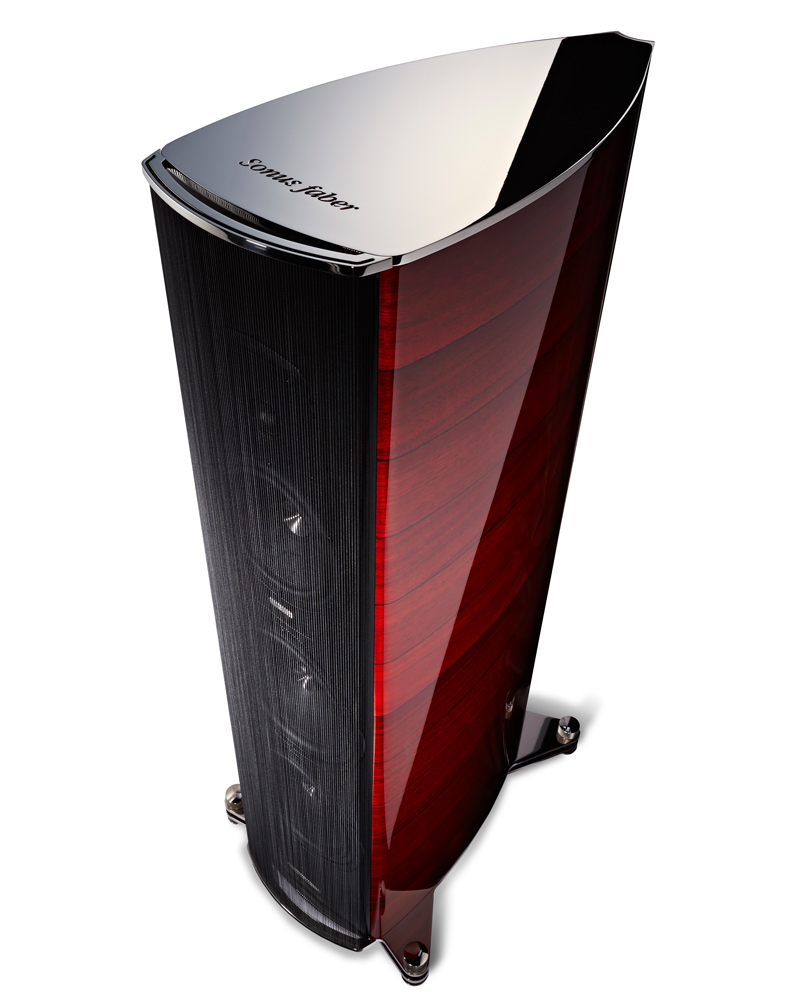

Another DIYaudio member has recently built this
http://www.diyaudio.com/forums/multi-way/250366-sonus-faber-cremona-hybrid-clone-8.html
In short I think towers of any kind are ruled out.

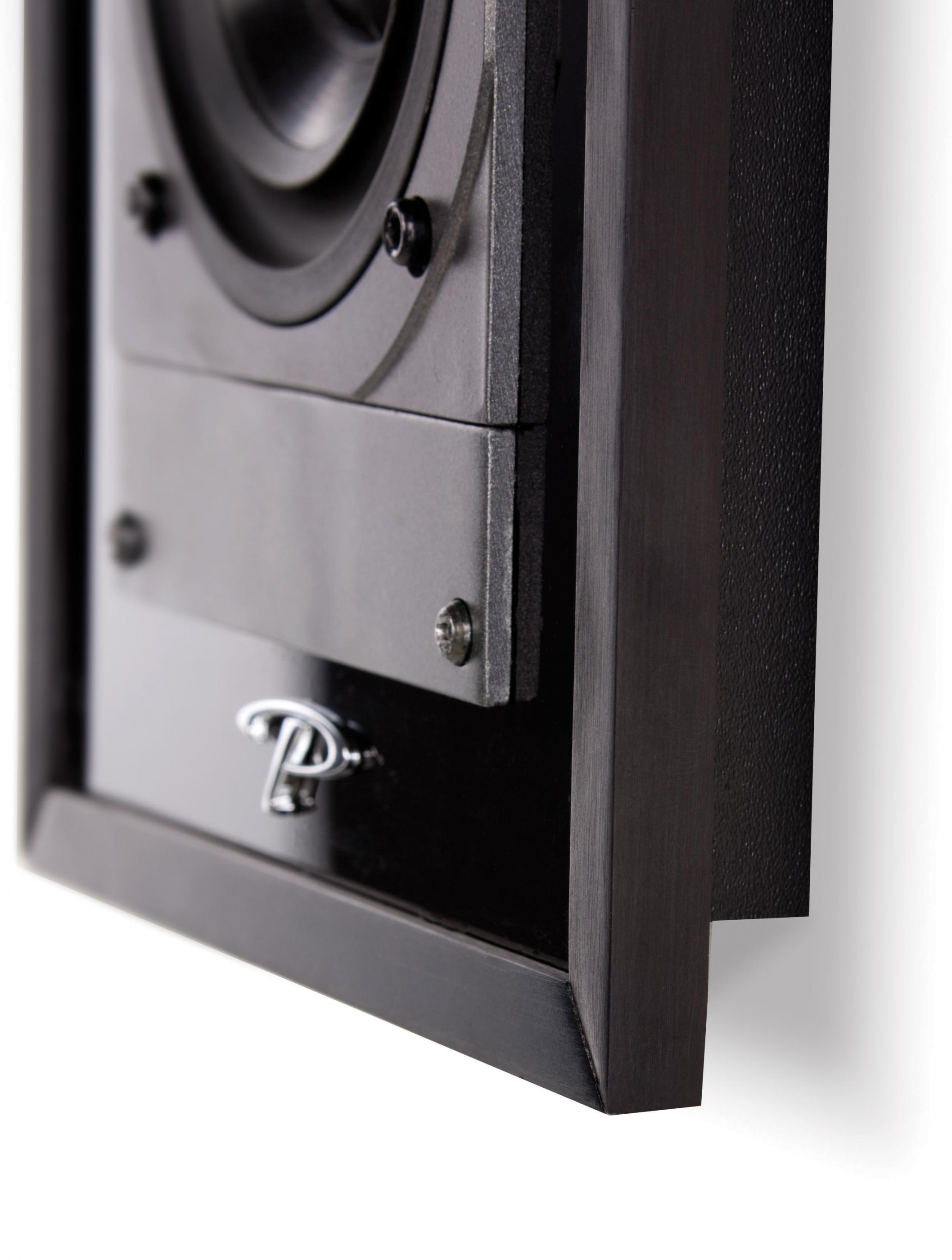

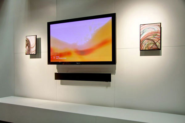

Coming back to the On Wall design. How about this?
PA1 Wall Speaker System With Dual Stereo Pairing ? Highsnobiety

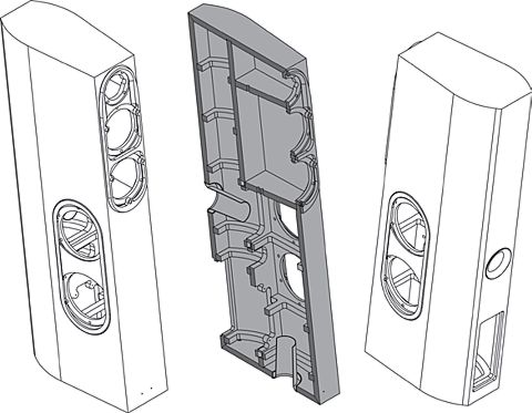

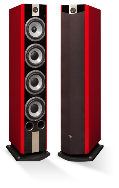

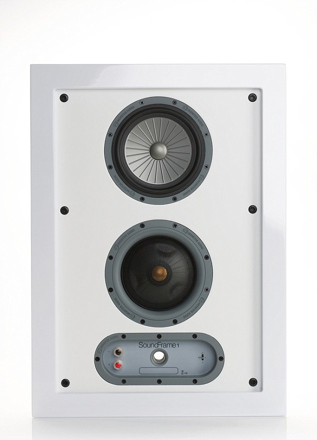

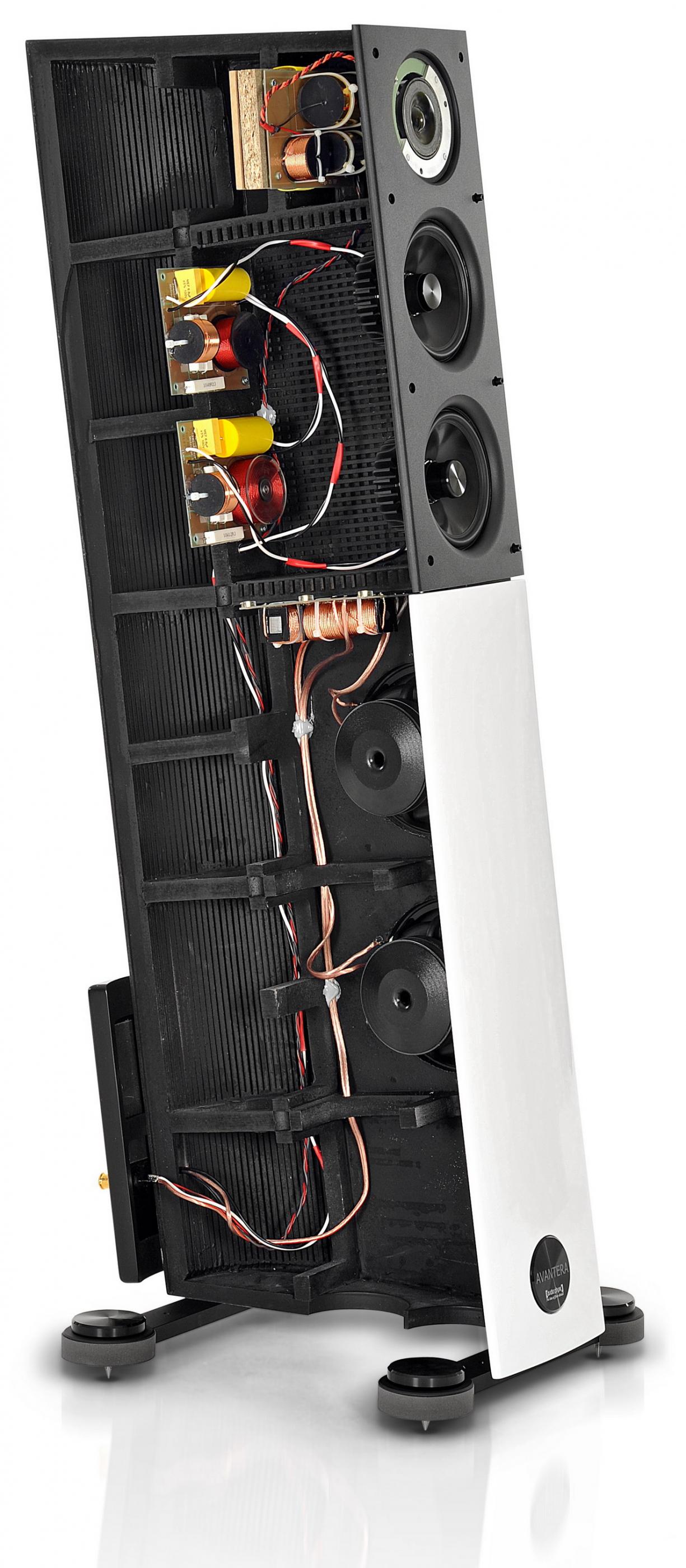

Oh and I have a few older photos too from PMC, Paradigm, Monitor Audio and more.
An if all else fails there is Wisdom Audio!

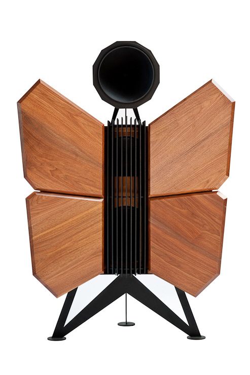

should have included these to make the others look better
QUOTE]

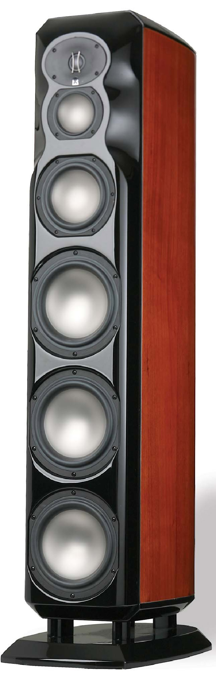

...or these...everything else looks good side by side with these
