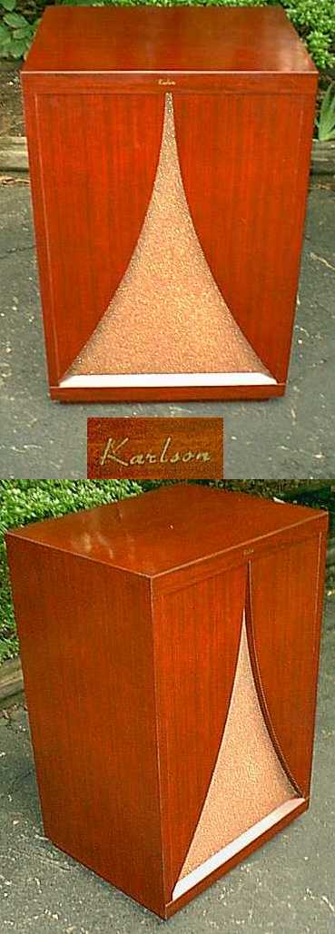

![Karlson.jpg](/community/proxy.php?image=http%3A%2F%2Fwww.fisherdoctor.com%2Fpictures%2Fother%2FSpeakers%2FKarlson.jpg&hash=3d2db2db4fed8f5d9453529b5afb995e)
Rating: 1

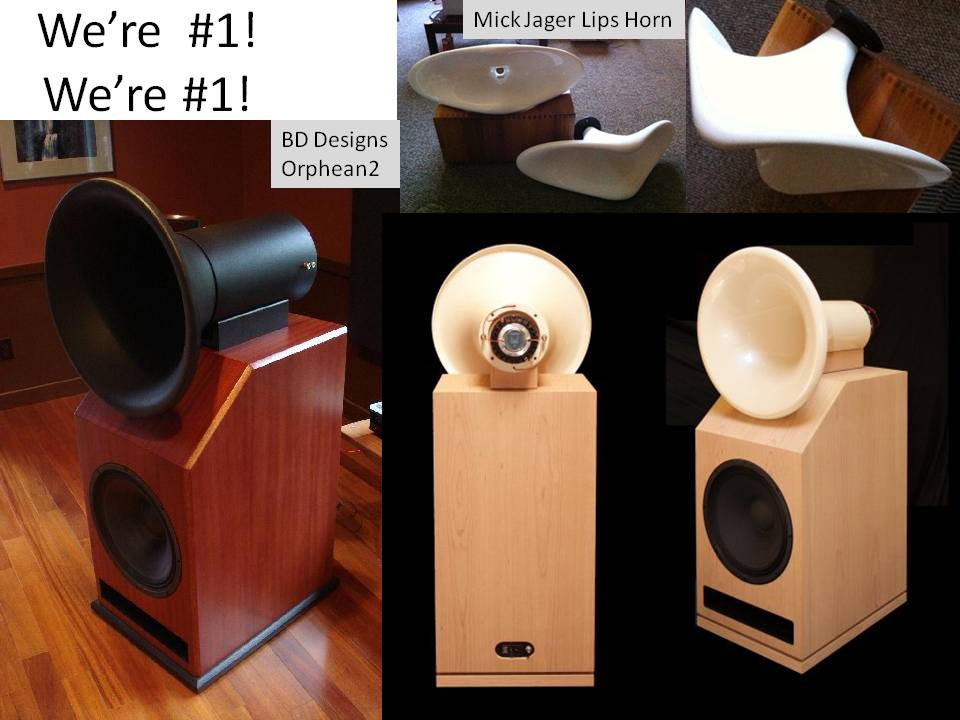

We're #1! We're #1! BD Design OrpheanII style horn speakers get great reviews. Controlled directivity over the length of a family couch is a good thing, and horns are a very good solution when your speakers are very near both a rear wall and a side wall. Not hard to copy. Several similar succesful DIY designs are well documented. http://www.bd-design.nl/contents/media/orphean system.jpg
How much wine did your wife drink before reviewing the speaker options? I suspect that after 2-bottles the Mick Jager Lips waveguide would also get a #1 grade.

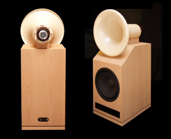

If you are commited to a small'ish coaxial speaker in a sphere, you will want to give technical consideration to having a front firing woofer as close to the sphere as possible in order to minimize lobing and maintain some control on directivity. A 200Hz Xover has a 17" quarter wavelength Center-to_Center speaker requirement for minimal lobing. The B&W engineers are very smart, and their Nautilus 800 uses front facing 10" woofers for these reasons. The MiniDSP will allow you to build a modest volume sealed woofer box and supply room equalization. A well braced, clever shaped woofer cabinet will have fewer resonant modes than a pipe.
No wineWe're #1! We're #1! BD Design OrpheanII style horn speakers get great reviews. Controlled directivity over the length of a family couch is a good thing, and horns are a very good solution when your speakers are very near both a rear wall and a side wall. Not hard to copy. Several similar succesful DIY designs are well documented. http://www.bd-design.nl/contents/media/orphean system.jpg
I'm sure they sound nice, controlled directivity is probably a good idea to reduce in-room effects (wall and ceiling reflections).
I didn't show her the "Mick Jager Lips waveguide", but I'm 99 % sure they would receive a rating of 2 or below.
/Anton
