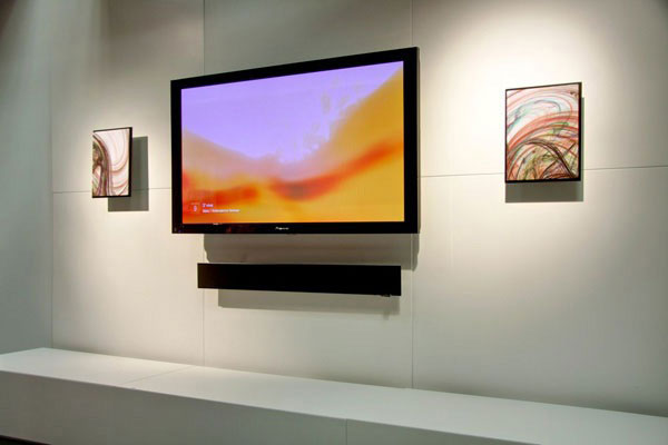

Coming back to the On Wall design. How about this?
PA1 Wall Speaker System With Dual Stereo Pairing ? Highsnobiety

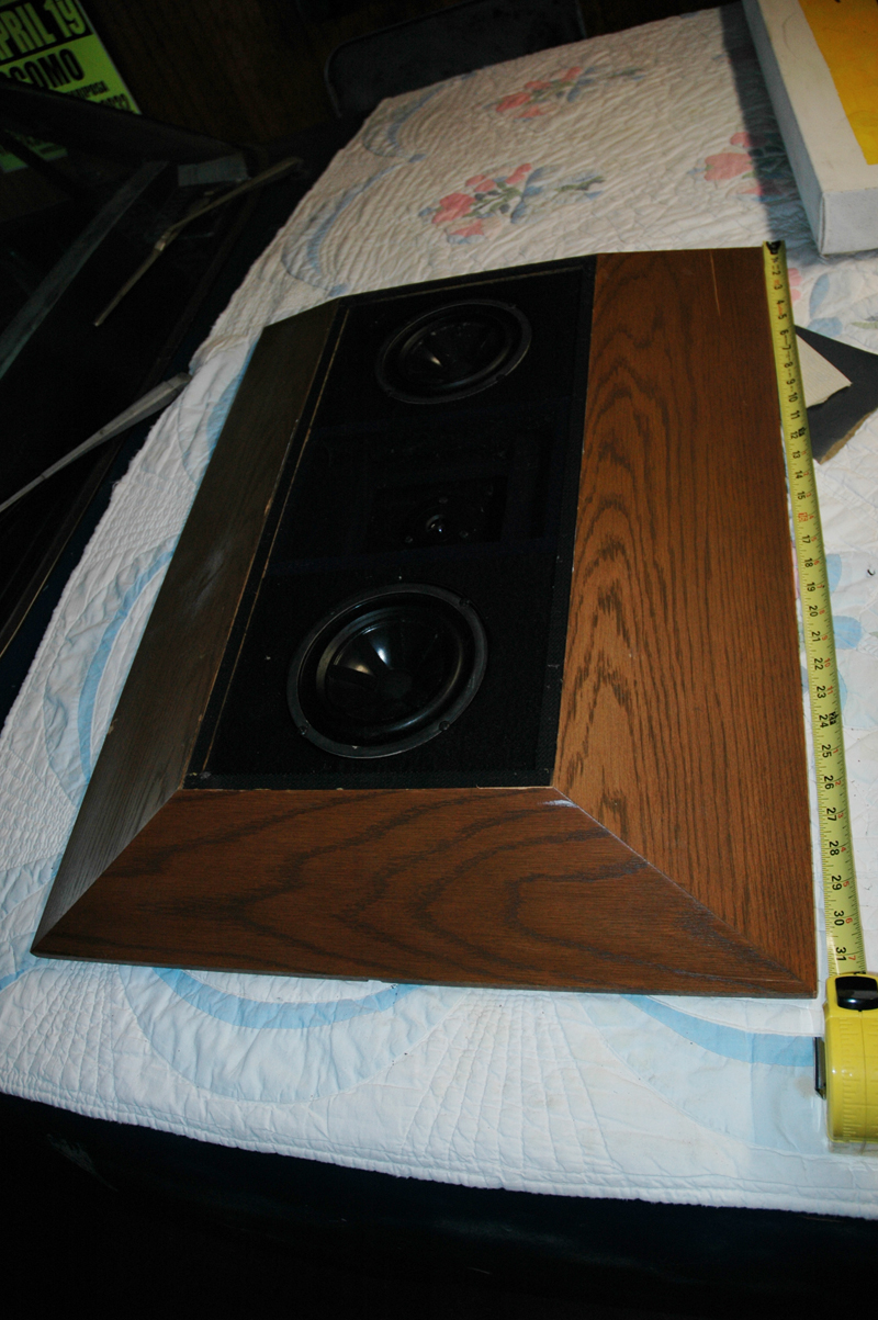

Interesting on wall-speaker. A little too much 80s look maybe, but with a different finish it could be something.An externally hosted image should be here but it was not working when we last tested it.Duntech PCL-5 simple lines

no offence, but your latest rendering with bowls stuck on the wall and red wire hanging down are not the best looking...and will probably not sound good either, not quite horn, sharp edge for bad diffraction...
...that half-sphere should be flipped, flat side on the wall, round side with full-range driver facing into the room, just a suggestion, and that could even sound good! (fast)
