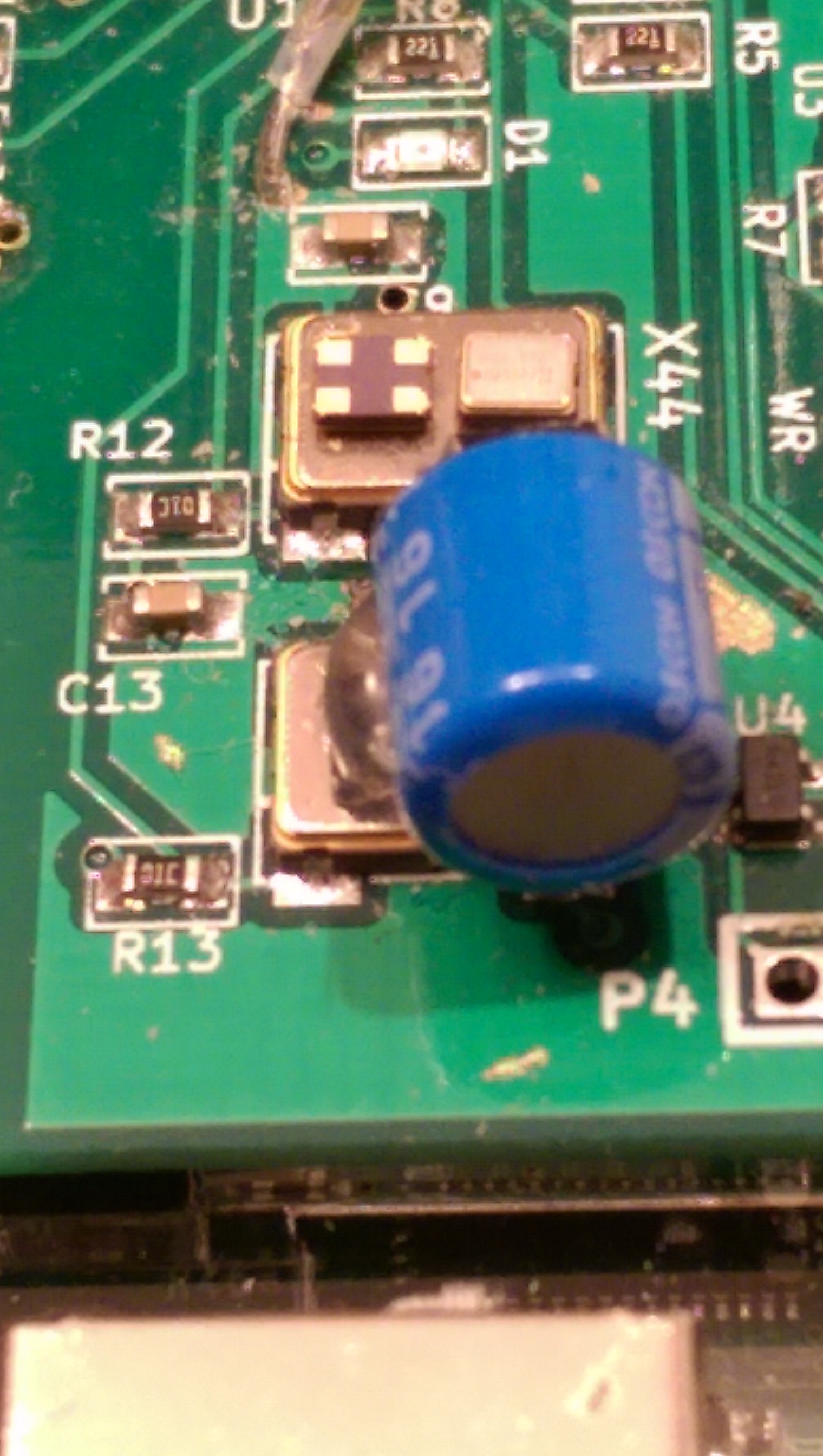

Here are two NDKs on top of one of the HFBD+P clocks.
I agree the NDK would be better. But not an easy replacement unless the pads under the existing clocks are sized to accommodate differently-sized clocks. This I doubt.
Still, I still suspect other issues.

Ok, yeah those are tiny. I bet layout is critical on those clocks-- can't just wire them in.
I soldered those NDK NZ2520SD a few times, yes, it's almost brain surgery, but doable.
This was my first attempt with very thin wire, but they broke off all the time
because they were too stiff
https://drive.google.com/open?id=0B5ivzpgUT3UYUDRFM3o0Z29vRDQ
Then I decided to try a different method...
https://drive.google.com/open?id=0B5ivzpgUT3UYTlVDeVp0YU9MWG8
This worked for me, but as said before, it's a kind of brain surgery method....
This method works best:
https://drive.google.com/open?id=0B5ivzpgUT3UYSEtkQ0VEZW5ETHM
It's just a simple, low cost, pcb. Put some solder on the 4 pads, put XO on it,
fix it on one side with some adhesive tape, press on top and solder them one by one.
This worked for me.

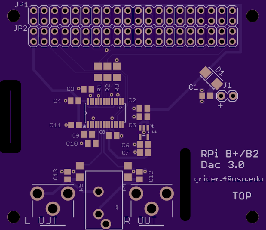

Hmm, there are starting points out there to spin our own board. Makes me want to learn KiCad!
Gotta love OSHPark! OTOH, the issue with doing a custom board of our own is getting a driver that will enable the Pi to generate the I2S stream using the bitclock from the DAC board. I suspect that U3 chip on the HFBD+P provides the information that the HiFiBerry driver needs to tell whether it is working with their DAC that does this or the earlier HFB DACs. That may be hard to fake.
OTOH, looking at the SabreBerry32, it does not appear to do the same thing, I suspect the driver assumes a bitclock and LRclock feed from the DAC card. So we MIGHT be able to use it's driver with a custom board.
OTOOH, I like what I see on the SabreBerry32. I'd like to see a more sophisticated power setup as on the MamboBerry, with its extensive filtering and two VERY high quality industry-best regulators (It really does set the standard for Pi DAC card power supply setups from what I've seen). AND I'd REALLY like to see isolation and reclocking between the DAC card and the inherently noisy Pi. I can work with the first... and live with the latter for now, as it would take a significant restructure of the interface between the Pi and the DAC card to make isolation and reclocking happen. I do like their use of the good NDK clocks and the almost industry standard ESS DAC chip. I will likely get one of these to play around with too.

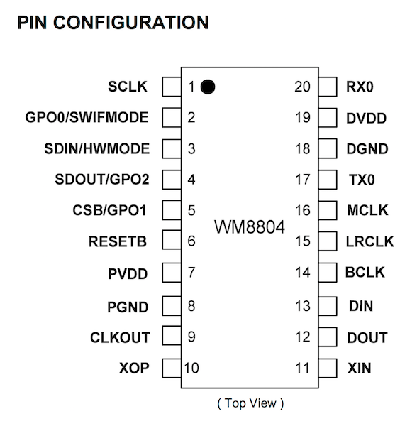

hello, i´ve been reading this tread with great enthusiasm, i ´m new to electronics... and i need some help. a bought a ak4495 dac thas has i2s input:
1 GND
2 MCK
3 LRCK
4 BCK
5 DATA
and i want to connecto the i2s out from hifiberry dac pro to ak board...
is it ok to do it like this?
from p4
1 GND - GND
2 MASTER CLOCK - MCK
3 BIT CLOCK - ?????BCK??
4 FRAME CLOCK - ????? LRCK??
5 DATA- DATA
