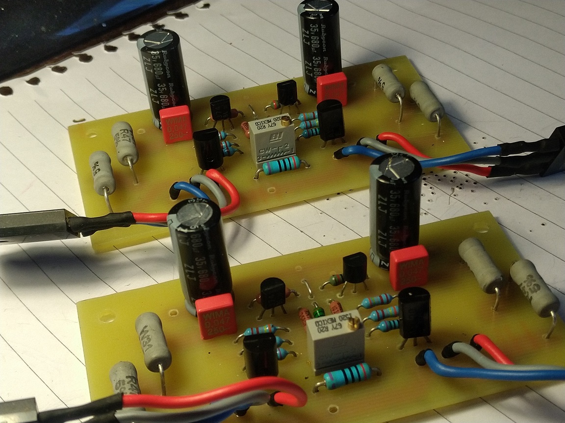

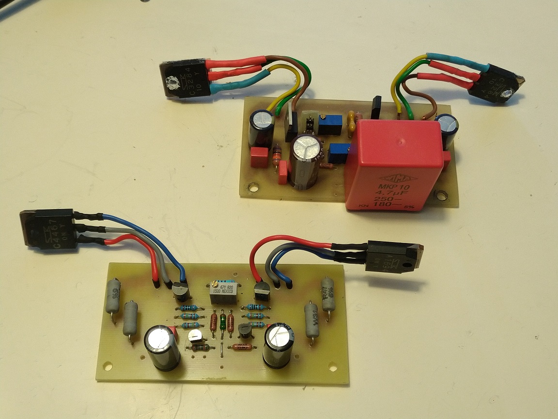

I do PCB design by myself, a true d.i.y.
in the first picture above is a PCB of JLH69, below is a PCB for Le Monstre

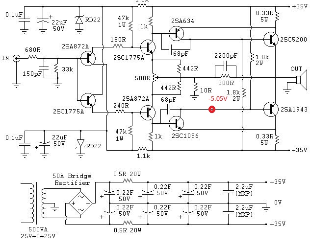

Hi all,
I build hiraga amp 2 channel using below schematic. Sound is good.
But last week i have issue for one channel.Sound like not enough power(hard to say,still have song).Another channel work excellent.
I measure at red point is -5.05V. Can somebody guide me to troubleshoot this amp?
One more question how to set bias this amp using trimmer?what value of trimmer pot ?

It is fully possible to increase to +16/-16 supply.
This almost doubles the power output.
Bias should be increased to 1.0 Ampere
Like here. See image.

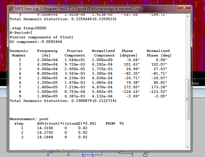

THD 0.200% 10.75 Watt +16/-16 Volt supply
compared to 5.87 Watt with +12/-12 supply
Hi,what software you use for circuit simulation?

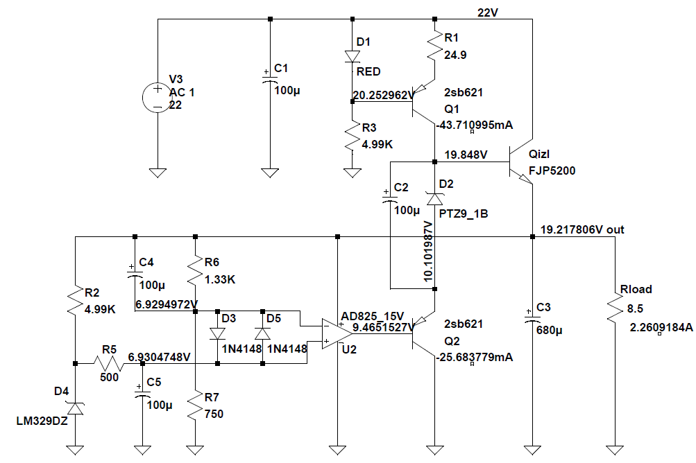

Could I ask for some details of the regulator circuit that you used, and will it work for the 30W version?
I made this regulator for my version of the JLH69 amplifier.
The output voltage can be adjusted, tested at 4A, with a minimum voltage drop of 3 V. It is a high-current version of Walt Jung's superregulator.
https://www.diyaudio.com/forums/solid-state/3075-jlh-10-watt-class-amplifier-563.html#post5972683
https://www.diyaudio.com/forums/solid-state/3075-jlh-10-watt-class-amplifier-580.html#post6050539
My Le Monstre works at +/- 19V, at 14W at 8ohm distortion should be about 0.2%. The current is 1A.

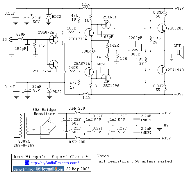

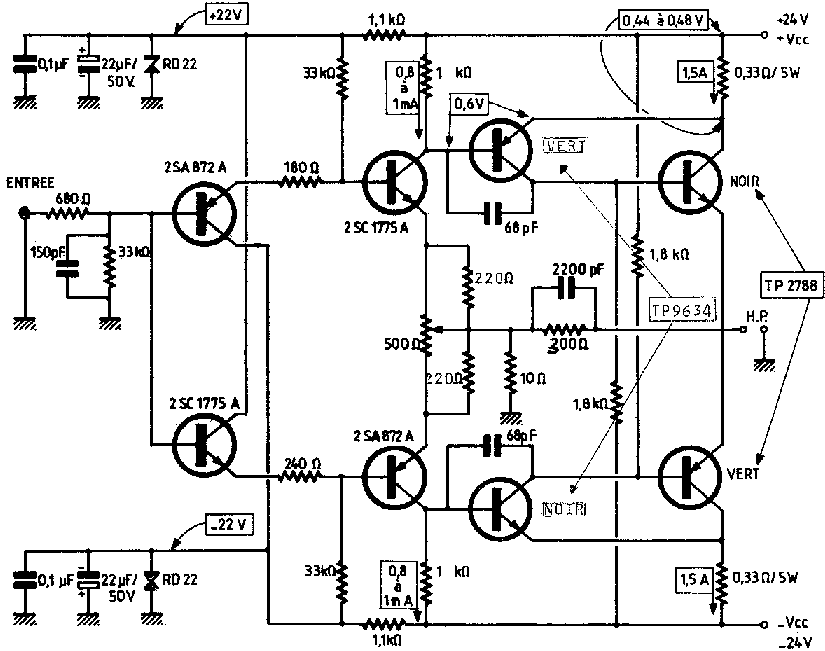

Thanks for reply,
Which component i need to change to use +-16V POWER SUPPLY?
Using below circuit.

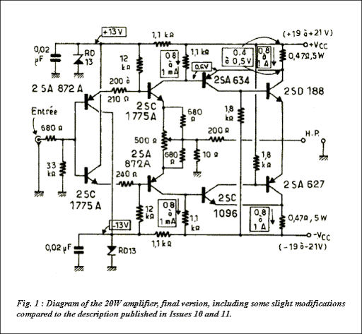

You should go back to the original Hiraga Class A (low power version). This is over 30W and it was modified based on that.
Take a look at these schematics.
You get the idea of how many changes you need. I prefer the second schematic over the first. I built and tested both!
Oh no..difficult to me to modified.
Some body can guide me?Can only change zener diode?
Oh no..difficult to me to modified..

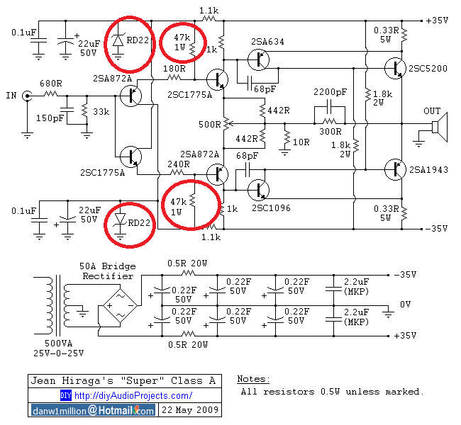

I think i need to change red component.Zener diode 22 to 12v.And resistor from 4.7k to 10k for run in 16v dual power supply.
Which resistor control bias?
There is not a single resistor which controls or set the bias, it is a compound circuit. When changing the value of the power rails, you better calculate everything again. But keep the first stage on the original lower (zener-) value. No need to change that (save the series resistor in value and dissipation).Which resistor control bias?
Settings are mainy with the collector resistances.
