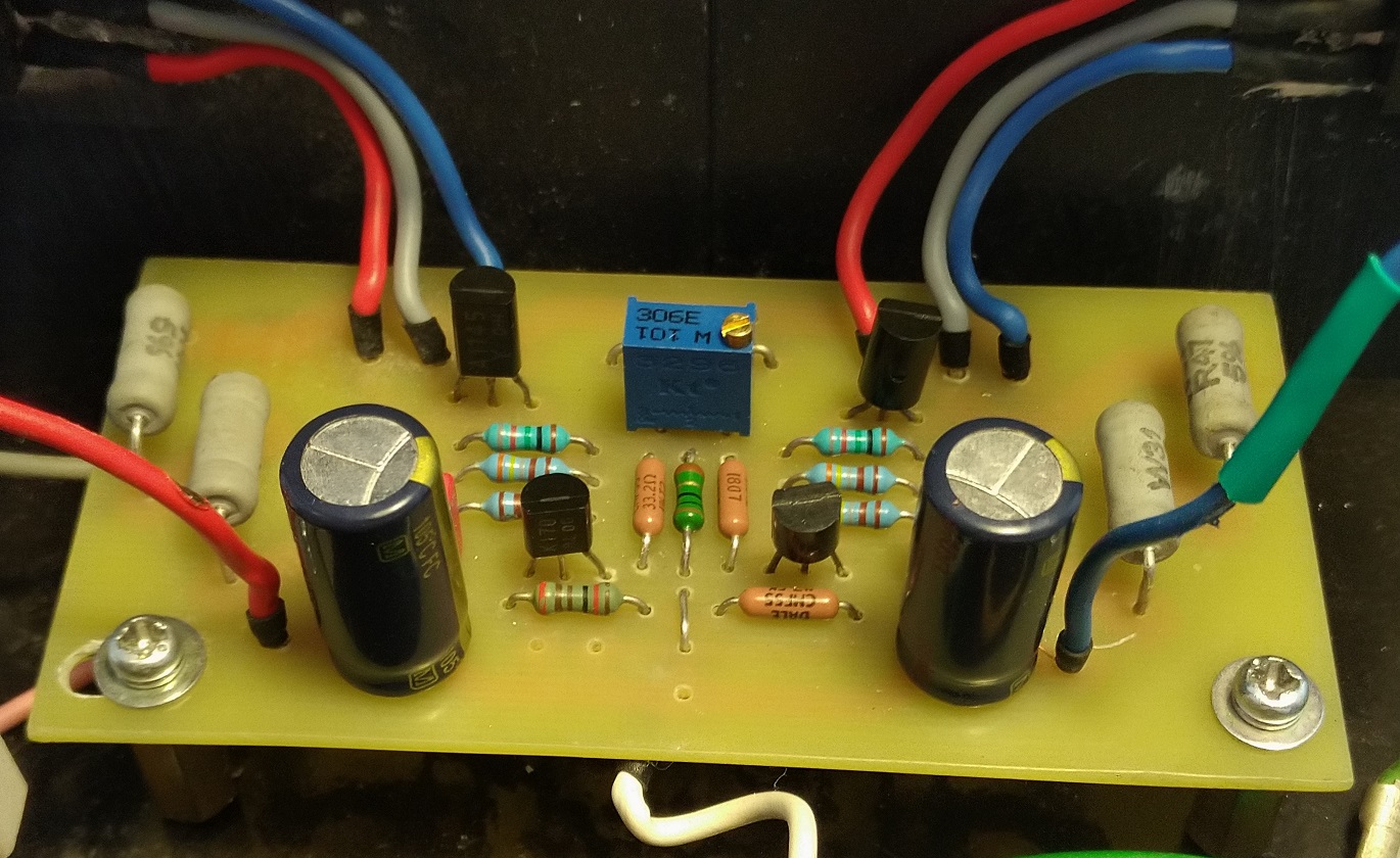

Is it exactly the same grounding layout? Same two capacitor oceans, same wiring and position of how power, returns and signal guards are connected together?...except that in LeMonstre is much more Capacity...
If that is the case, there should not be a difference. But there is. So, at least one connection is different.
All those capacitors... with one leg on the ground plane... over some measurable distance... ripple currents in the oceans... sweet spot... a distributed ground plane.
Two pictures of both inner wirings may show the difference. I'm curious.

thanks for the replies
yes its exactly the same work, except of the two 3F capacitors in LeMonstre
IMG-6316 — ImgBB
havnt a pic form the bootm side yet...

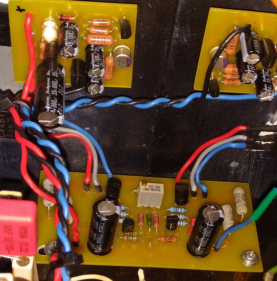

solution or not
today i angry disassembled the amps modules. put it back on the floor an arranged the items one after the other.
First the torroid, then rectifiers, then Cap-Block as one piece as seen in picture, then heatsink with pcb. Quick soldered with long wires.
Switched it on and ------ tattaaaa---- no noise at all.??!!
The only thing i changed, was that i did not connect the mains ground to the ground of psu.
dont unterstand that...

You broke the ground loop....dont unterstand that...

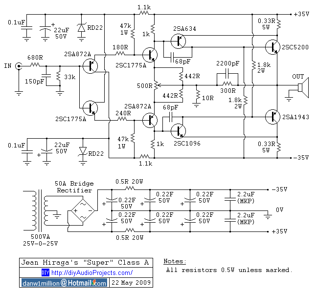

Hi all. My hiraga power supply before load is 16v.but after load drop to 12v.any suggestion for class a amp psu? One more question, what difference between schottky and ultra fast diode? Which suit for audio powersupply?
Your power supply is low wattage.
What is your transformer VA range?
12vac 20amp
What version of Hiraga are you built?12vac 20amp
Thimios.. I use this circuit. But supply only 16vdcWhat version of Hiraga are you built?
This circuit can't be well function with this low voltage.
Is your transformer a 2x12v type?
Is your power supply, after rectifier +/-16v?
What capacitors you are using?
How many uf?
0.2F=22000uf.
You will need about 60.000uF IN THE + RAIL
and 60.000uF IN THE - RAIL.
I don't know What RD22 zener voltage is.
If it is 22v zener you will need something like +/-25v power supply.
Ather way is need to reduce the value of 1.1K.
May be the 1k in the driver stage need to adjust for 1mA too.
I don't know if amplifier remain stable,after modifications.

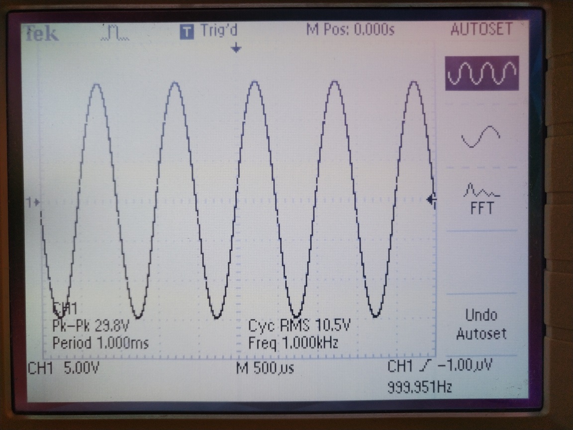

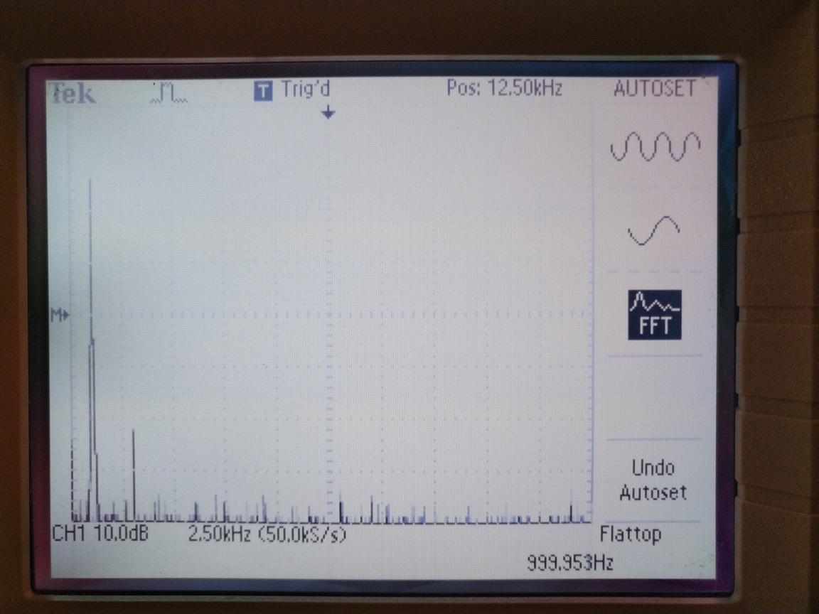

With a power supply of +/- 19V the output power is 13W at 8 ohms. FFT also looks good.
I’m getting some more parts coming in this week, so I’ll try with other faster output transistors and reduce the resistor values in the collectors to 0.5 ohms.
