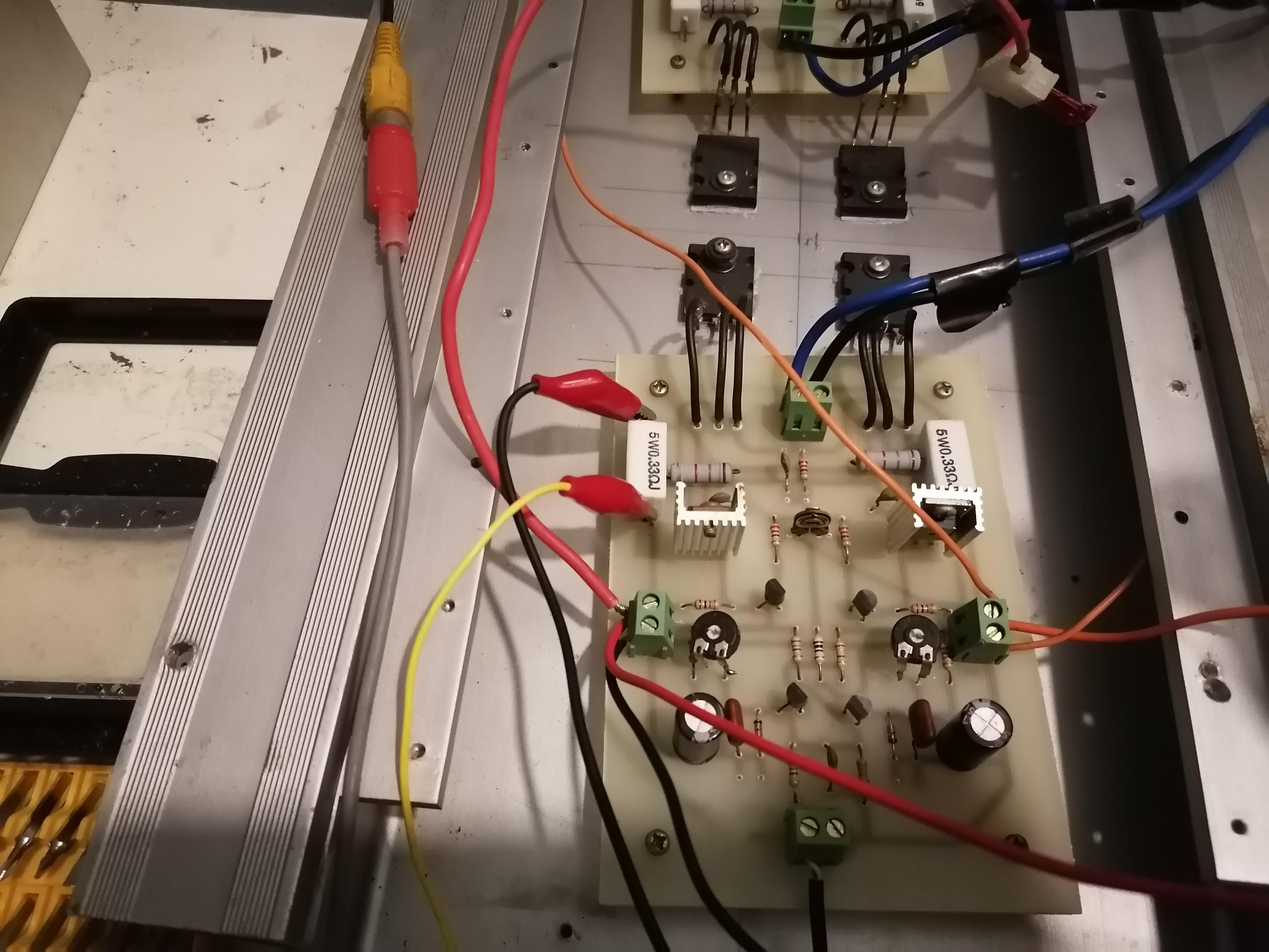

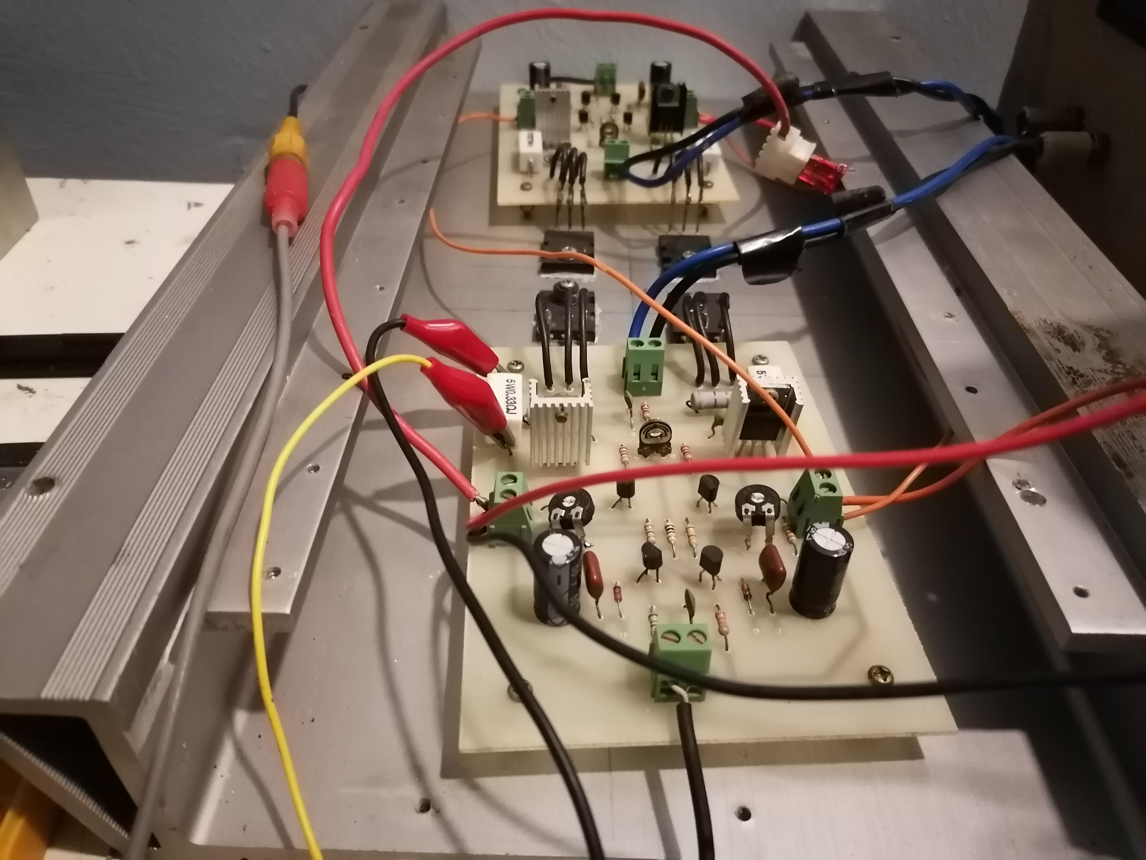

After some trial.. I change 47k resistor on plus side to 10k and negetive side to 12k..Difference resistance to get balance dc offset. If use two 12k bias resistor. I cannot trim dc offset close to zero. Only get 100mv.I think i need to change red component.Zener diode 22 to 12v.And resistor from 4.7k to 10k for run in 16v dual power supply.
Which resistor control bias?
Now use 10k and 12k, dc offset can get less than 10mV.

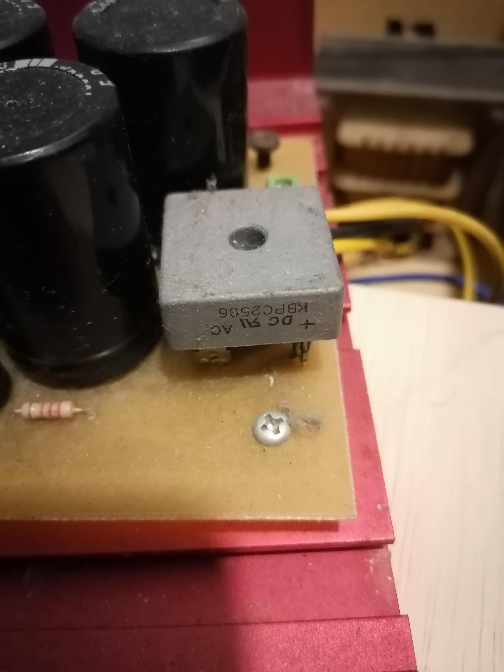

One more issue is,my bridge diode very hot.. I use kpbc2506. Can anyone give suggestion another cold and stable bridge diode model?
Mount diode to large car amp heatsink.Ad a PC of heatsink to that bridge or mount it into that aluminum plate. You run it in heavy Class A cooling for the bridge a must even if it 50A type.

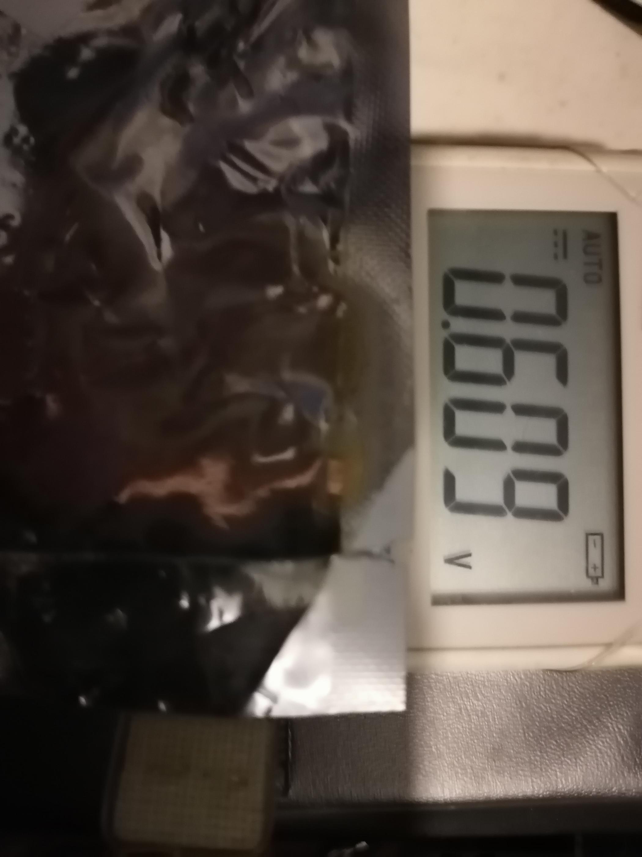

Use 0.33ohm output resistor. Voltage across this resistor is 0.6v..so bias per bjt is 1.8Amp.

Flat surface of the bridge must be in close contact with the surface of the heatsink. In the above photo, I can see only a partial contact with the heatsink.

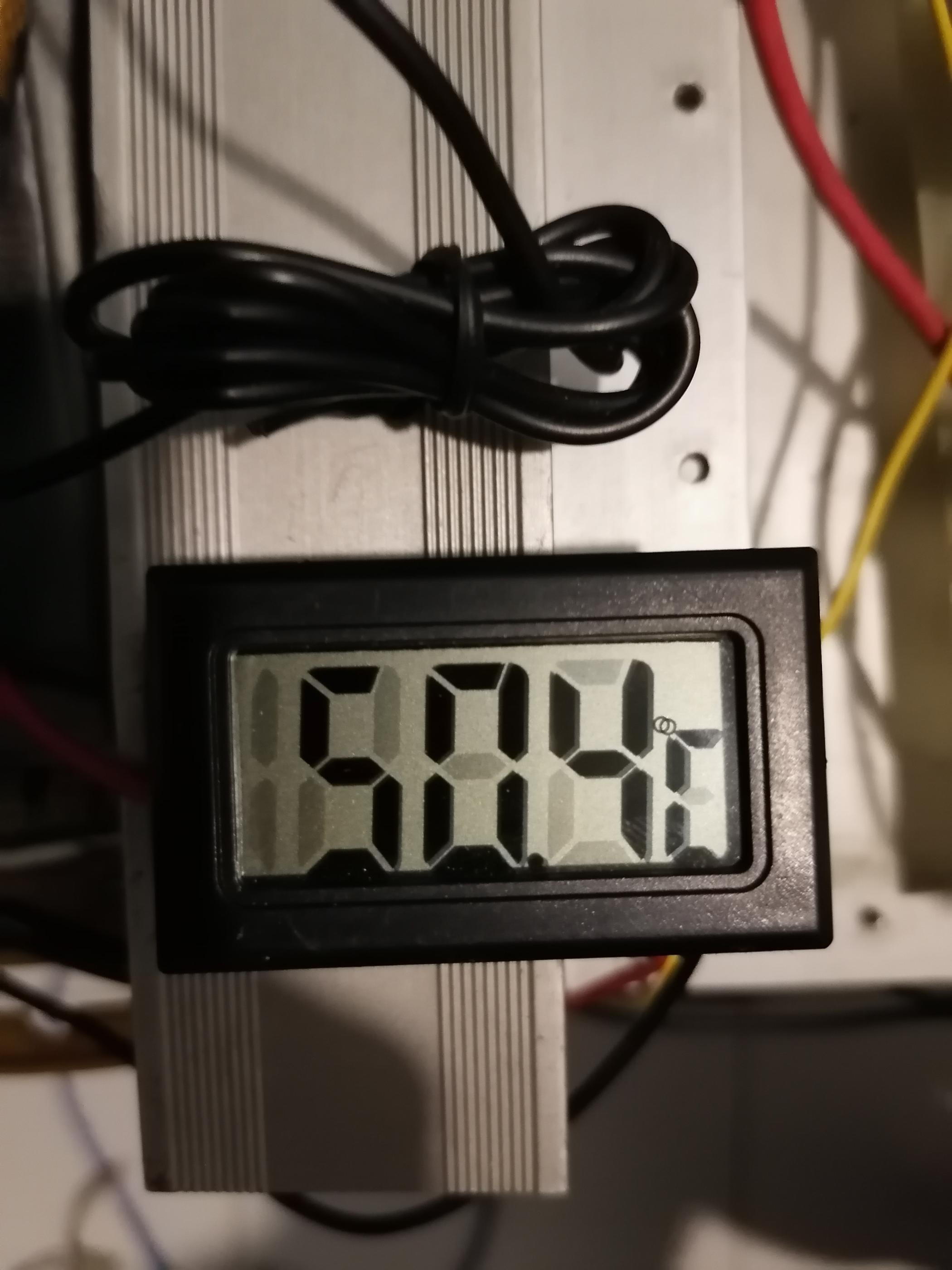

For temporary only. After run 5 hours, temperature maintain 50.5 degree without fan. But my transformer need external fan.
