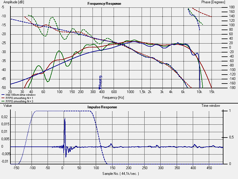

do you mean that your window length is variable and calculated so that the resolution is xx points per octave on each part of the frequency range ?FFPO (fixed point per octave) This is in fact what I already use in the total-response
Ffpo?
My window is not adjusted - As I could read, e.g. in
http://www.eaw.com/Info/EAW Smaart/Manuals/FFT-Fundamentals.pdf
Then FFPO is purely smoothing in the frequency domain.
E.g.
When I smooth with 1/N and N = 1 the point in 1000 Hz is an average (windowed) from 500 Hz to 2000 Hz
See attachment
And as far as I can google this is the same as FFPO?
jlo said:do you mean that your window length is variable and calculated so that the resolution is xx points per octave on each part of the frequency range ?
E.g.
See attachment

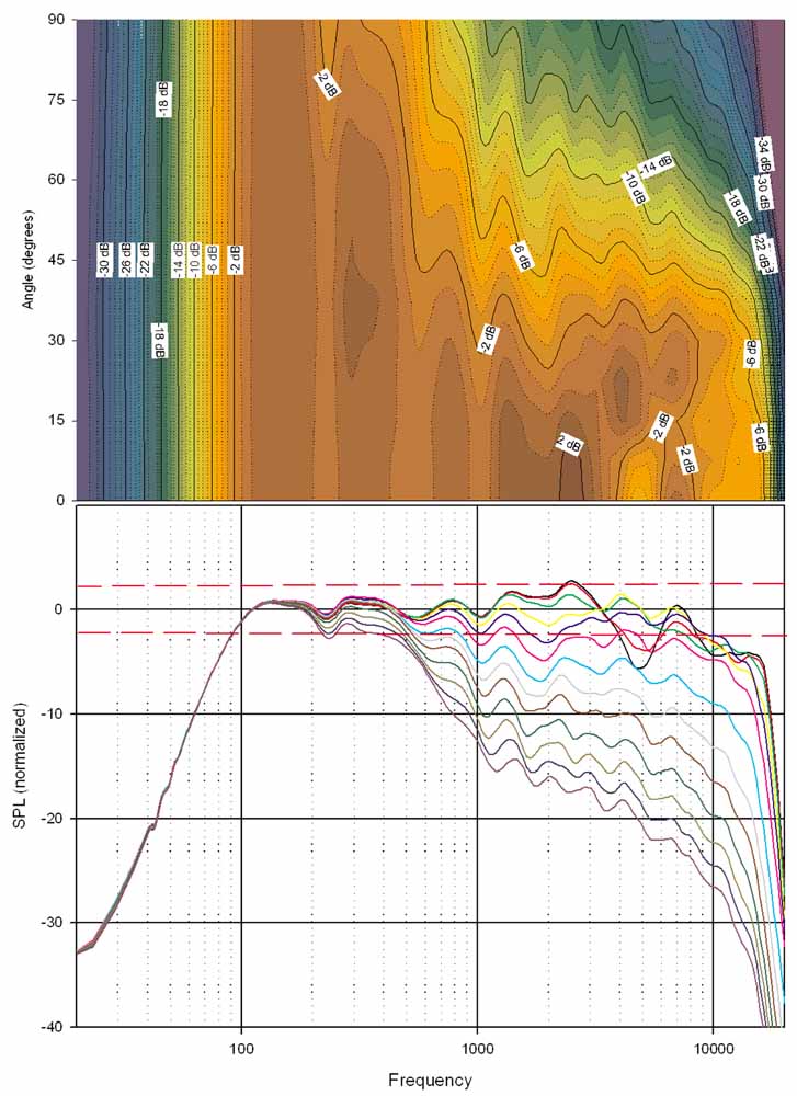

askbojesen said:
You call it polar data - so I guess, that you are looking at angular dependent impulse responses.
Where can I see all your nice graphs?
Here is an example (the polar countour map, which I prefer, was too big to attach). This data was all taken, including the near field, with your system.
back to wishes about some FPPO implementation, I think it would be better to keep a fixed time window possibility in higher frequencies, so it could be :
- a fixed time window in high frequencies of length adjustable between 1 and 20ms
- FPPO in lower frequencies with possibility to choose points per octave between 1 and 24 maybe
Another point :
now you can only choose between time-window and total response smoothing. Why not be able to choose a time-window together with smoothing ?
Some work again for you, Ask, sorry...
Another point :

jlo said:Another point :
I'm aware of that feature could be nice. Especially with log-sweep where we want to neglet the HD-pre-tops
Thnak you for the input regarding smoothing/time-windowing
In general I'm thinking about smoothing - I'll be back
