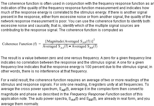

Well yeah, that makes sense. I was a little surprised by - and maybe didn't understand - the NI page linked to:
I took this to mean that several passes were needed, not simulations measurements. Yes/No?
For a valid result, the coherence function requires an average of two or more readings of the stimulus and response signals.

Coherence function is exactly as Earl Geddes explained - a correlation of two signals, basically its a Quality of data value between 0 and 1 (or 0-100%) for each frequency. This value is determined by the following questions -
1. Was there enough energy in the reference signal (send) to make a valid measurement?
2. Was there enough energy in the measurement signal (return) to make a valid measurement?
3. Are the two signals aligned in time?
4. Did the signal change in a non linear way ? (fom input to output)
5. is there too much noise in the signal? (direct to reverberation)
This can make Coherence a pretty useful item.
It is critical to note that just because there is Low coherence, it does not mean that the data is wrong! - there are many cases where the coherence is low but the data is accurate - such as a dip in the frequency response due to a polarity inversion between drivers or a cancellation due to a reflection. In both cases the coherence would be low and the data correct. It does take some skill in reading the data but useful nontheless.
Some measurement systems also use coherence with Magnitude Blanking, turning off the low coherence parts of the trace if it drops below a certain percentage, say 10% or so. Coherence averaging of multiple traces, only averaging the "good bits", has also been tried, still not sure on this one though.

Did you follow the NI link? Coherence only has meaning in the context of averaging multiple measurements. It was a valuable measure in the days of dual channel FFT analysers with random noise stimuli (or when using music as a stimulus) as it would highlight unreliable areas of the measurement where the stimulus for a particular set of averages might have low energy or the response is dominated by noise. I don't personally feel it is of much benefit nowadays - with sweeps the stimulus energy is high for all measurements and a long single sweep is usually better than multiple shorter sweeps, while even for noise stimuli a periodic noise stimulus (rather than the random noise of old) will have guaranteed uniform energy distribution in each measurement even without averaging so little need for the coherence indicator.askbojesen said:The formulas can't be that complicated
ok let
X(f) = FFT( Signal ) (logsweep)
Y(f) = FFT( Recording )
H(f) = Y(f)/X(f) = Frequency response
What is then the Coherence Function ?

First, you can't just use H(f) simply defined that way because it won't work, the equations will just simplify down to 1 = 1.
let Sxy(f) = the cross spectrum of x(t) and y(t)
and Sxx(f) = the auto spectrum of x(t)
and Syy(f) = the auto spectrum of y(t)
Then gamma(f) = sqr(|Sxy(f)|^2 / ( Sxx(f) * Syy(f)))
Because you don't do cross spectrum directly in your software you don't have Sxy(f). You can get Sxy(f) from X(f) *conjg(Y(f))
and but then
gamma(f) = sqrt( X(f) * conjg(Y(f)) * conjg(X(f)) * Y(f)) / (X(f) * conjg(X(f)) * Y(f) * Conjg(Y(f)))
which simplifes to one unless you do "expected value" of each operation over a number of data records to calculate the auto and cross spectra and THEN calculate the coherence. With only one data set the coherence is always one.
What I meant of two channels versus two measurements is that you can't really do one data set (channel), wait a period of time and then do another data set because the time vary error will mess things up. WHen we average over mant data sets in a measurement we have assumed time-invarince across those daa sets, ie. Stochastic data. The longer the time interval the less valid this assumption will tend to be.
