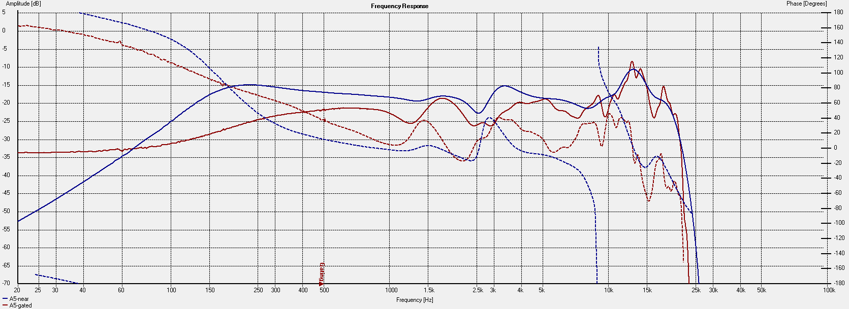

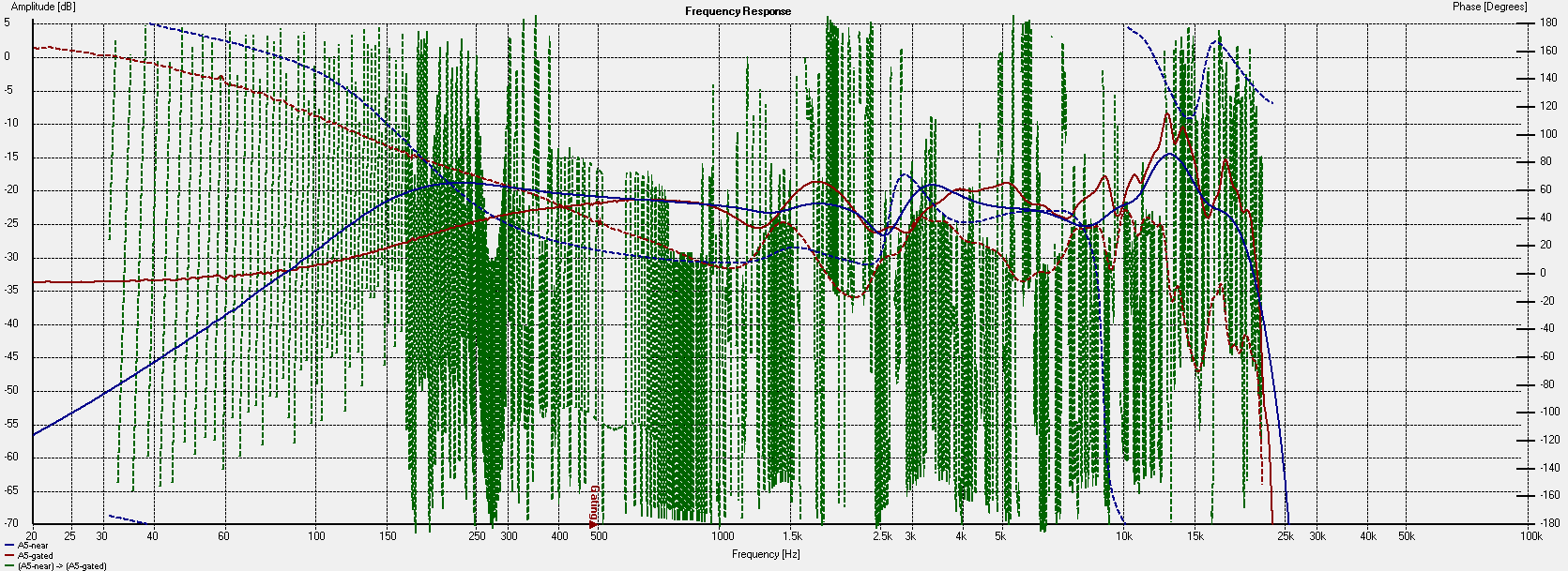

I'd like to get people's opinions on this. I'm suprised noone's posted about it yet, I searched the thread and found nothing about stitching or phase problems.
I'm doing near field and gated far field measurements to get a complete picture of the driver's response in its enclosure. Standard operating procedure. After getting decent measurements in each configuration, I used the modify menu to stich the two together into a new complete response graph.
As the stitching tool mentions that it should both match amplitude AND phase before stitching, I'm assuming that I should get a nice resulting phase graph that blends from one measurement to the next, just as with the blending of the amplitude.
This seems not to be the case. Whenever I do a stich between two measurements, the phase in the resulting measurement EXPLODES IN A WRATHFUL BALL OF DOTTED LINES.
*ahem*
Let me simply demonstrate with a screenshot! (The built-in image capture feature is awesome btw)
The first image is the two measurements, with both amplitude and phase displayed, before the stitch
The second image is all three measurements; the near field, far field, and resulting stich; displayed. Obviously one can't make out much as the phase on the stitch is all over the place. The amplitude, btw, is a perfect blend between the two at 800hz with a 200hz overlap. In this instance I checked "match amplitude" and "match phase" before performing the stitch, but I have tried this with all combinations of different frequencies and different settings for the match, and everything behaves normally, but the phase always explodes as shown.

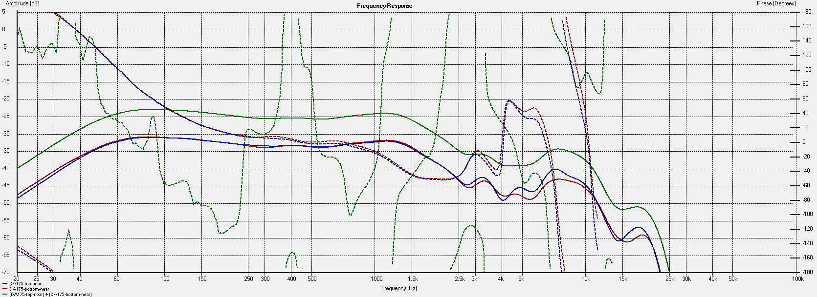

I'm building an MTM so my workflow for generating a response for my woofers is as follows:
1. Nearfield measurement of woofer 1
2. Nearfield measurement of woofer 2
3. Sum measurements of woofers 1 & 2
4. Farfield measurement of both woofers together
5. Stich the Summed measurement from step 3 and gated far-field from 4.
Ignoring phase, this is still fine and good from a frequency standpoint, until I get to the final step. It appears that the stitch function also refers to the phase calculation when blending the amplitude from one measurement to another, and creates a frequency null if the drivers are out of phase, as would happen in a crossover situation.
The problem is that when using the "Sum" function to add the two nearfield measurements, the resulting phase graph is all over the place, so when doing the final stitch, unless I use a stich width of "1" I get a huge dip in response, which I'm guessing comes from bizarre phase information generated from the Sum function.
Not sure if this is how it should behave or not. Either way, here's a screenshot of what I'm seeing. The first two graphs (blue and red) are nearfield measurements of both drivers in the box, which are appropriately similar in both amplitude and phase (they are not normalized in the measurement options). The third measurement (green) is the Summed measurement of the first two, and the resulting phase.
New version with Bug fixes 1.3.0.4
It was a bug. - Stitching now works again

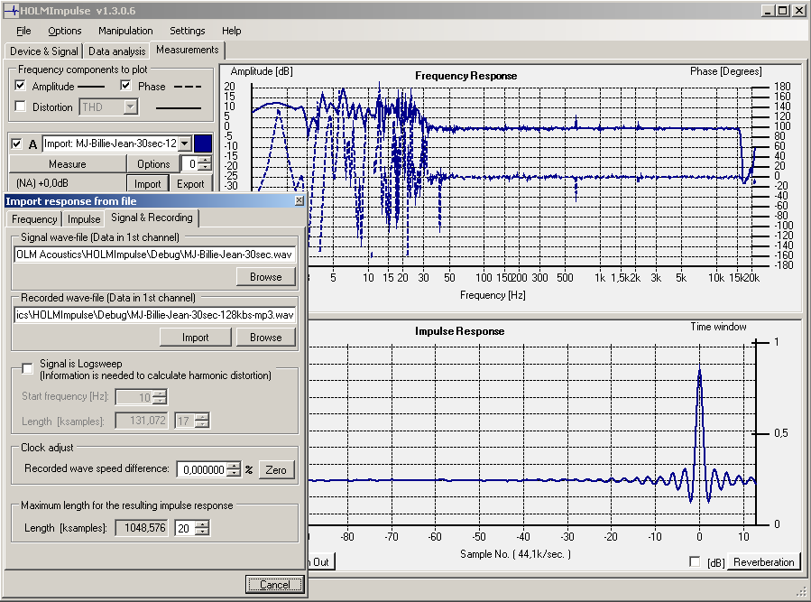

* Import of DUT response Import > 'Signal & Recording'
Attached picture shows the response of 30sec mp3 encoded music

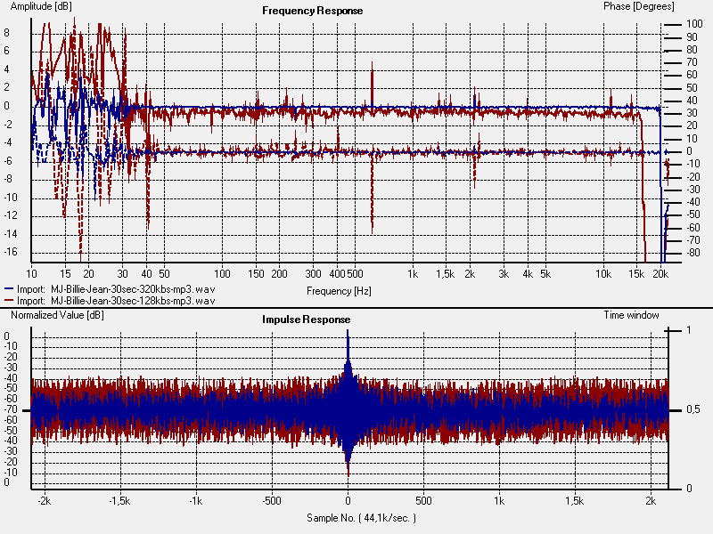

Music as measurement signal
What I need next is to play music through my speakers and correlate with a recording.
Another attachment shows the difference between 128 kbs, 320 kbs mp3 -
Does anybody know where a new thread regarding frequency response of encoded files would belong? Or If it is old news - where can I read about it.
