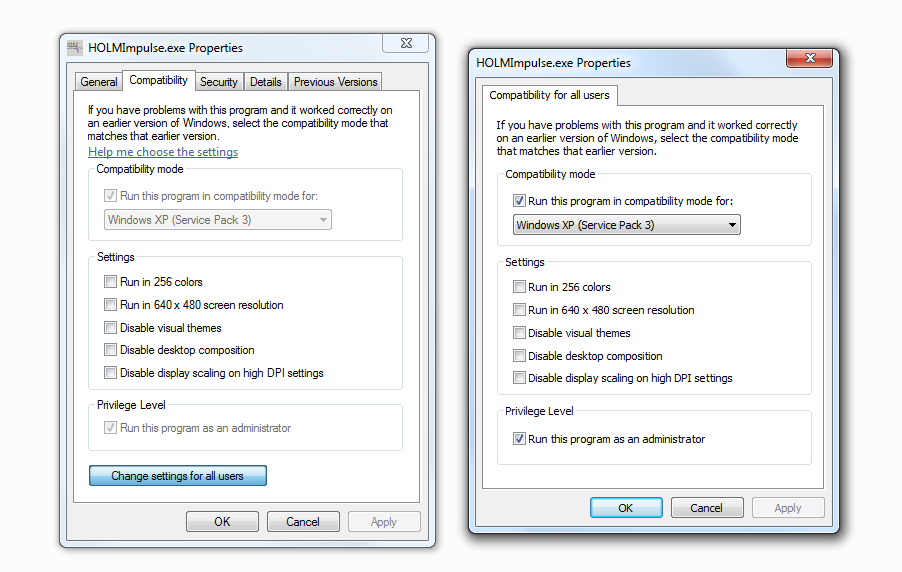

Crashing on import
I recently was forced to downgrade from XP(32) to Win7(64) and no matter what I do, I cannot import wave files with impulses anymore without crashing. The very same files loaded perfectly on the old XP system. OK, I had the occasional import crash there, too, but the latest version seemed to be very stable on my old system.
Tried HolmI 64 and 32 versions and all the hints mentioned. Measuring works fine, though, as well as saving and loading whole measurement sets.
Any hints? Maybe something with the .NET package HolmI uses (Win7 seems to have that preinstalled).

I would try it here on Win7, but my son has that machine at present. Will try as soon as I get a chance. Any particular wav format?
32bit mono, but I tried any combination of 32/16 stereo/mono and any sample rate (in the measurement setup).
Funny thing is, I can export a measured impulse as WAV but cannot re-import it later (same 'access violation error' all the time). Something seems really wrong.

I've had a few issues with holm crashing under win7 64bit. Usually clearing out the XML files fixes it (but this loses all settings and current measurements, so an export is necessary). I've not tried importing any wav files however.

OK I just tried exporting a measurement as a wav and importing it again. It crashed.
Do you have win7 Pro? If so download the XP virtual machine and set it up. You probably won't be able to do measurements but it may allow you to import wav files and then save them as a zip file. You will probably then be able to open them in the win7 Holm.
Tony.

Ok, just installed Holm again (currently I use ARTA) and I have also the same problem on my PC (Win 7 32bit PRO)
I changed the "compatibility settings" for the executable on XP SP3 and set always "run as administrator" (see attachment).
With these settings I could import the wav-file, but for some strange range I only managed to import it once...

There is a good change that turning of DEP (Data Execution Prevention settings in Windows) will do the trick. Unfortunately Windows does not allow to turn of DEP for HolmImpulse.exe only, so DEP needs to be turned of completely.

Turning of DEP didn't help also. Something strange is going on, but difficult to see without source code. Maybe askbojesen can jump in and save the day? I guess the best solution comes from Wintermute: run holm in a virtual XP machine for import and export duties...
